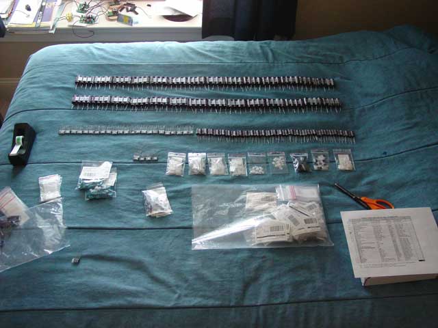

No, I still haven't had time to build up my second board. I did, however, start labeling the parts for the parts kits. I'm going to work on that some more tonight. Hopefully this weekend I will get to build up another board and do a stereo listening test. The next two weeks at work will be a killer for me because I'm the lead developer for a new product and we (actually my boss and the president of the company...) committed to ship prototypes before the holiday season 🙄 Like they'd do anything with it over the holiday even if they had it...
The kits are coming together. I've made my way through about half of the parts list so far and should be able to finish up the rest later today. That means I will be able to start shipping these out this week 🙂
I underestimated the cost to ship these things with the weight of all the parts and the toroid cores so you guys got a bit of a break on that :smash:
FastEddy said:
Oh, boy ... the parts spread on the bed ....
(I'm a kitchen table man myself) :smash:
Any updates to the BOM parts lists, docs or images?
I used my bed because then I have to get it done or it means I'll be sleeping on the floor 😉
The BOM is the same as the last one I posted here: http://www.diyaudio.com/forums/showthread.php?postid=1074907#post1074907 I'm working on a component placement diagram that will help to find component locations when building up the boards. The general rule when building up boards is to solder on all the components with the lowest height first and work your way up to the tallest components. For these boards it's probably easiest to solder all the components on the chip side first so the board stays flat the longest. I often use a 1/4" thick piece of foam rubber about 2" by 6" under boards to help keep them more stable if components are on the underside. It also keeps them from moving around since the foam grips the board and the work surface nicely.
