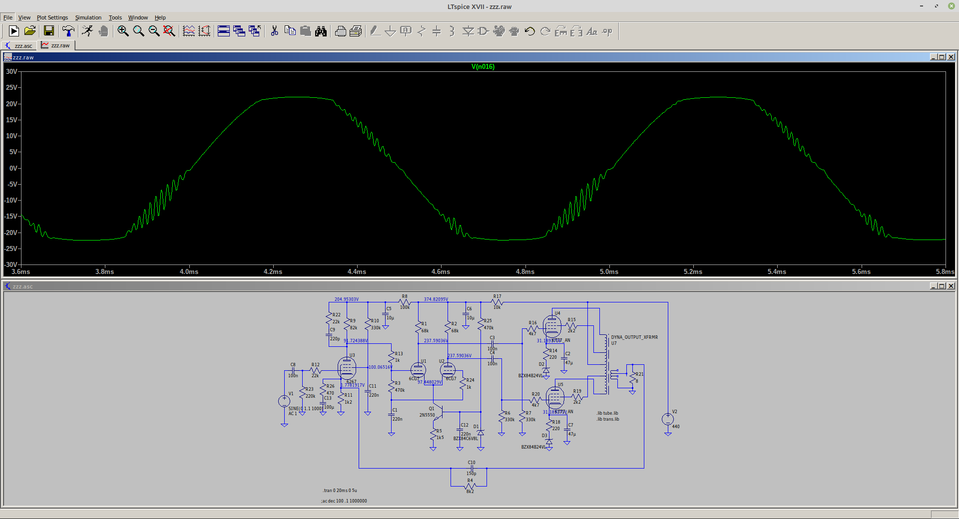

The frequency of the oscillation I'm seeing with a 20Hz input is around 57-58KHz. This oscillogram is just zoomed in on the ringing/oscillation.

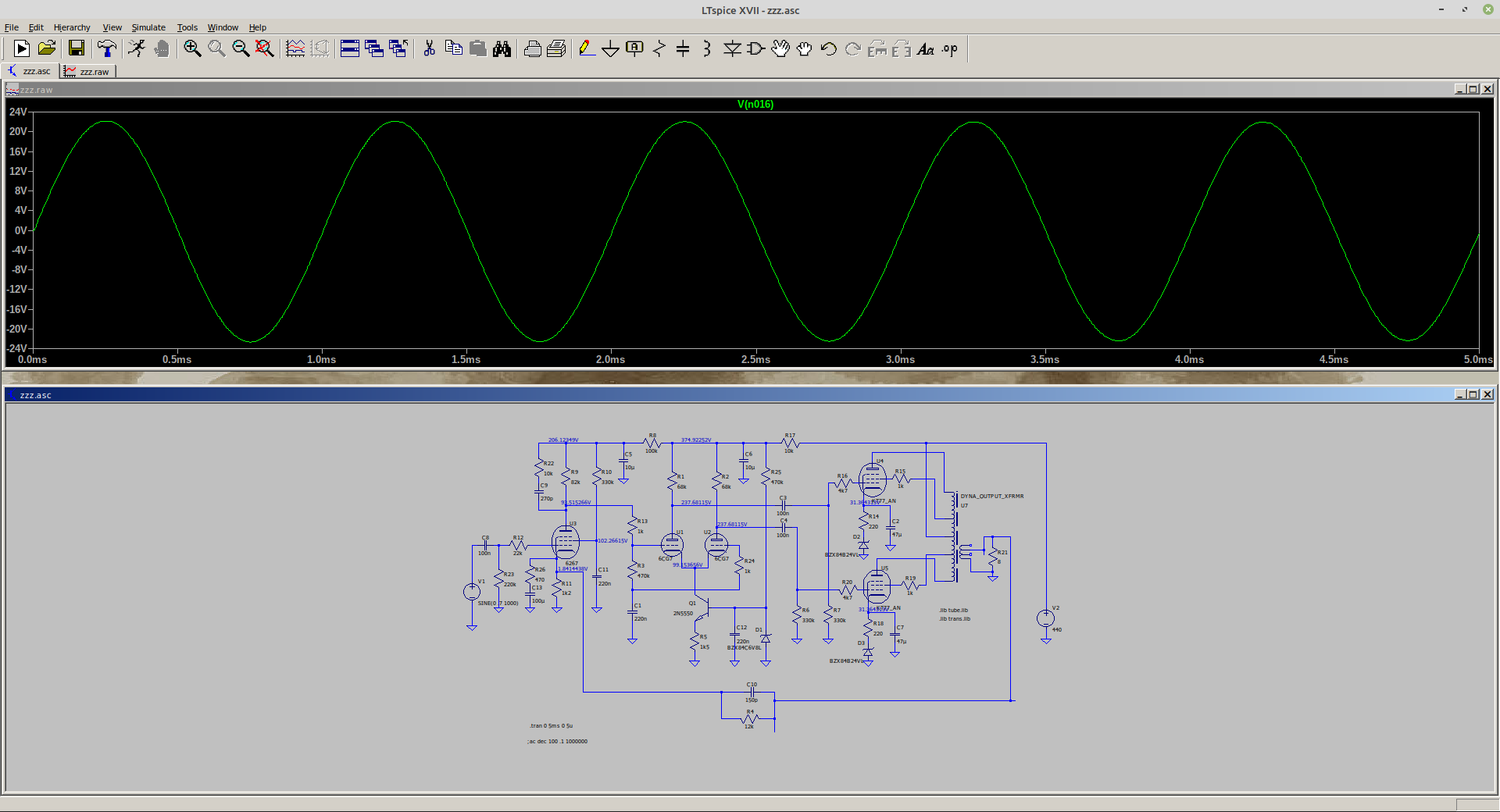

Comparison at 100Hz 500mV input. Left is C11/C12 @ 100nF & R4 @ 10K, right is C11/C12 @ 470nF & R4 @ 22K. C2 was 270pF for both.

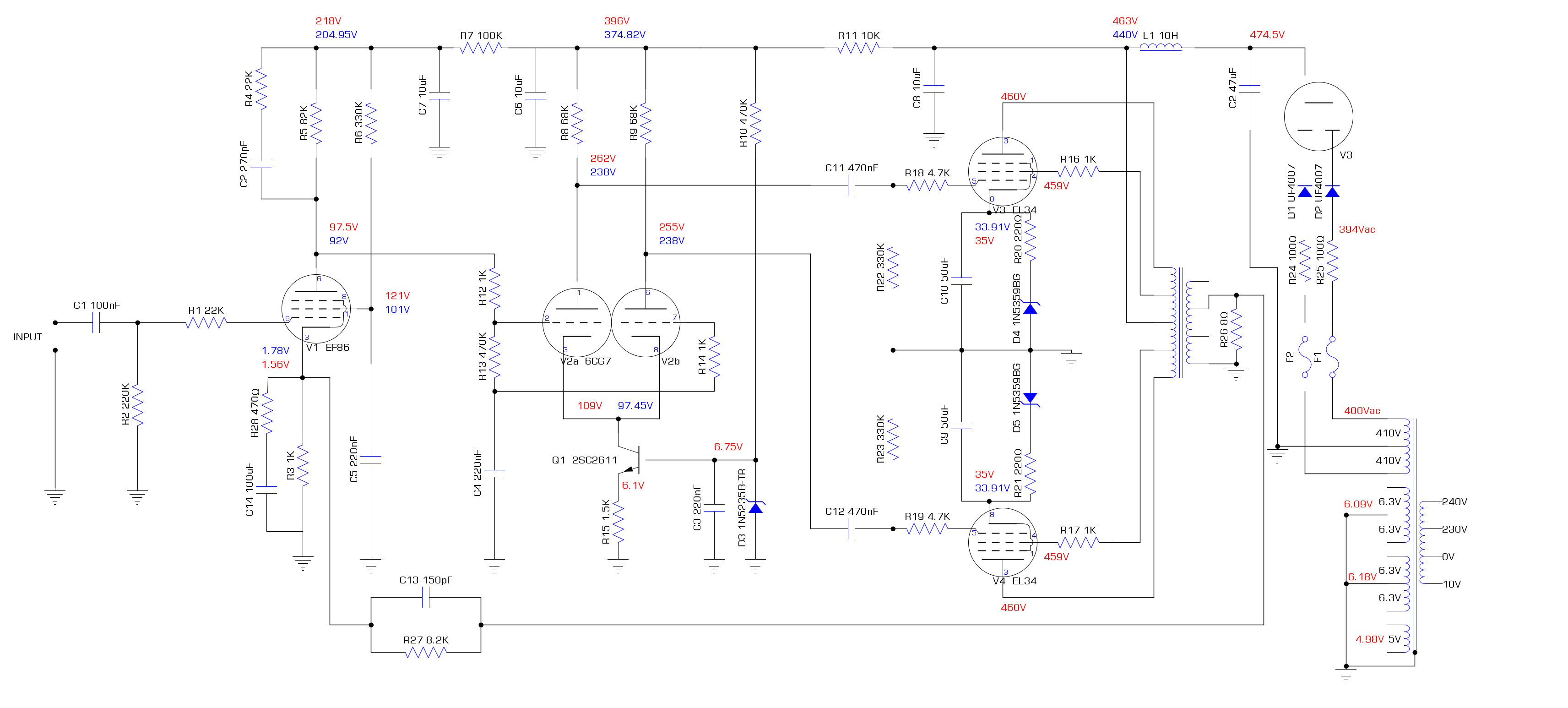

I've attached a schematic showing the changes in value up to now. It's improving as I can no longer get any misbehaviour above 500Hz.

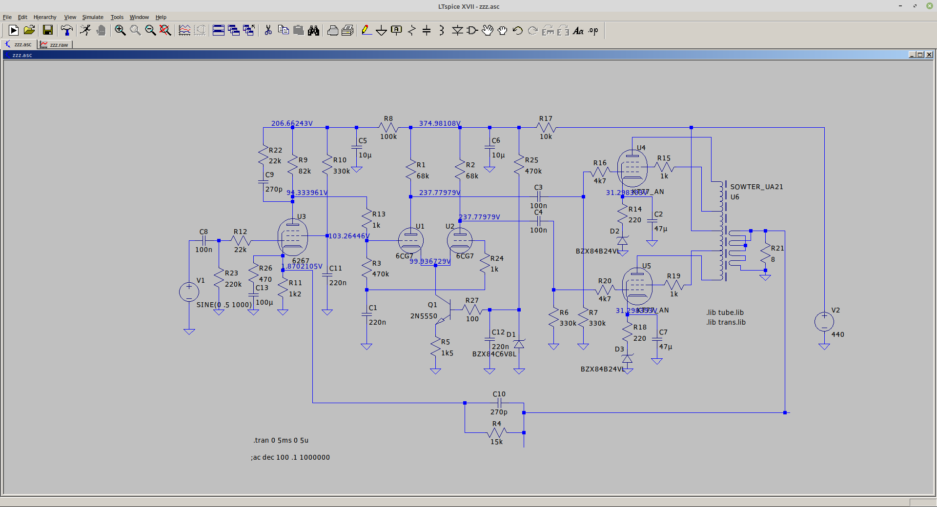

It probably will not help, but try this anyway:
Put a 100 Ohm resistor (base stopper") from the base to the parallel 220nF / Zener.
As the circuit is now:
The base is at RF ground.
The Emitter is 1.5k in parallel with stray capacitance to ground.
The Collector is at who knows what impedance at frequencies near the fT of the transistor.
Many an oscillator has been made at fractions of fT, at fT, and even beyond fT.
At fT, a little wire inductance, and a little stray capacitance goes a very long way to building an oscillator.

So it just simple NFB being too marginal. As its at 58KHz is just where the NFB goes through unity gain. How much does the gain drop when you connect the NFB? It should be 17dB. My simulation is showing 22dB which is too much. So if your happy with sound open loop then start with less FB say R27 = 12k. Mr Summer does point out that the NPN could oscillate if the collector load looks inductive and one should put 100R in series with the base. However this will go off at several tens MHz, but could affect the voltages on V2 plates if it does. However in this case I don't think it is. Nevertheless it is good design practise.

I'll try the increase in R27 a go. Should I drop the value of R4 back to 10K or leave it at 22k? (component numbering as per my schematic)So it just simple NFB being too marginal. As its at 58KHz is just where the NFB goes through unity gain. How much does the gain drop when you connect the NFB? It should be 17dB. My simulation is showing 22dB which is too much. So if your happy with sound open loop then start with less FB say R27 = 12k. Mr Summer does point out that the NPN could oscillate if the collector load looks inductive and one should put 100R in series with the base. However this will go off at several tens MHz, but could affect the voltages on V2 plates if it does. However in this case I don't think it is. Nevertheless it is good design practise.
Out of interest, how does your simulation behave if the power source is bumped up from 440V to 465V as I'm seeing?
Be careful, the negative feedback resistor (12k to 8.2k) was not the only change.

Just saying if the basic NFB is too high then its a bad starting point. I thought we had designed for 17dB NFB but I think the sowter transformer model I did is wrong. When I put the DYNA one in (4300/4) impedance ratio I get 22dB which is far too much for a valve amp like this. Dominant pole is with 82k the 22k forms the zero. So
220pF + 82k = 8.8KHz
Then zero at 220pF + 10k = 50KHz.
I would put R4 back to 10k. I found 4k7 was better, but I don't have your transformer.
First thing to check is how much gain drops at 1KHz when you connect NFB, should be 17dB. If you give us this figure could you also quote the R27 value you are using.

If I am reading it correctly your first transformer pole (45 deg) is at 25KHz which is really quite low. Typically it should be more like 50KHz. It does match up with their spec of bandwidth 50KHz. Did you drive the transformer from the input or through a source resistor? Anyway I suggest you drop the NFB a bit (say R27=12k) to see if you can get the system more stable. Without a transformer in front of me I don't think I can do a model for you.
I've had a good look through my component stash and could not find any 12K resistors. The closest I have is either 10K or 15K. I also put a 110R resistor on the base of the transistor. (Couldn't find any sensibly sized 100R resistors)
I've tried R27 as 10K without making any other changes and it appears that other than a difference in gain, the amount of oscillation remains pretty much identical. This is with R4 @ 22K, C2 at 270pF and C13 still at 150pF.
The drop in gain going from 8.2K to 10K looks to be approximately 1.4-1.5dB
