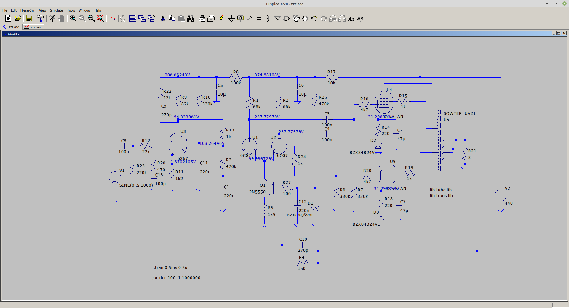

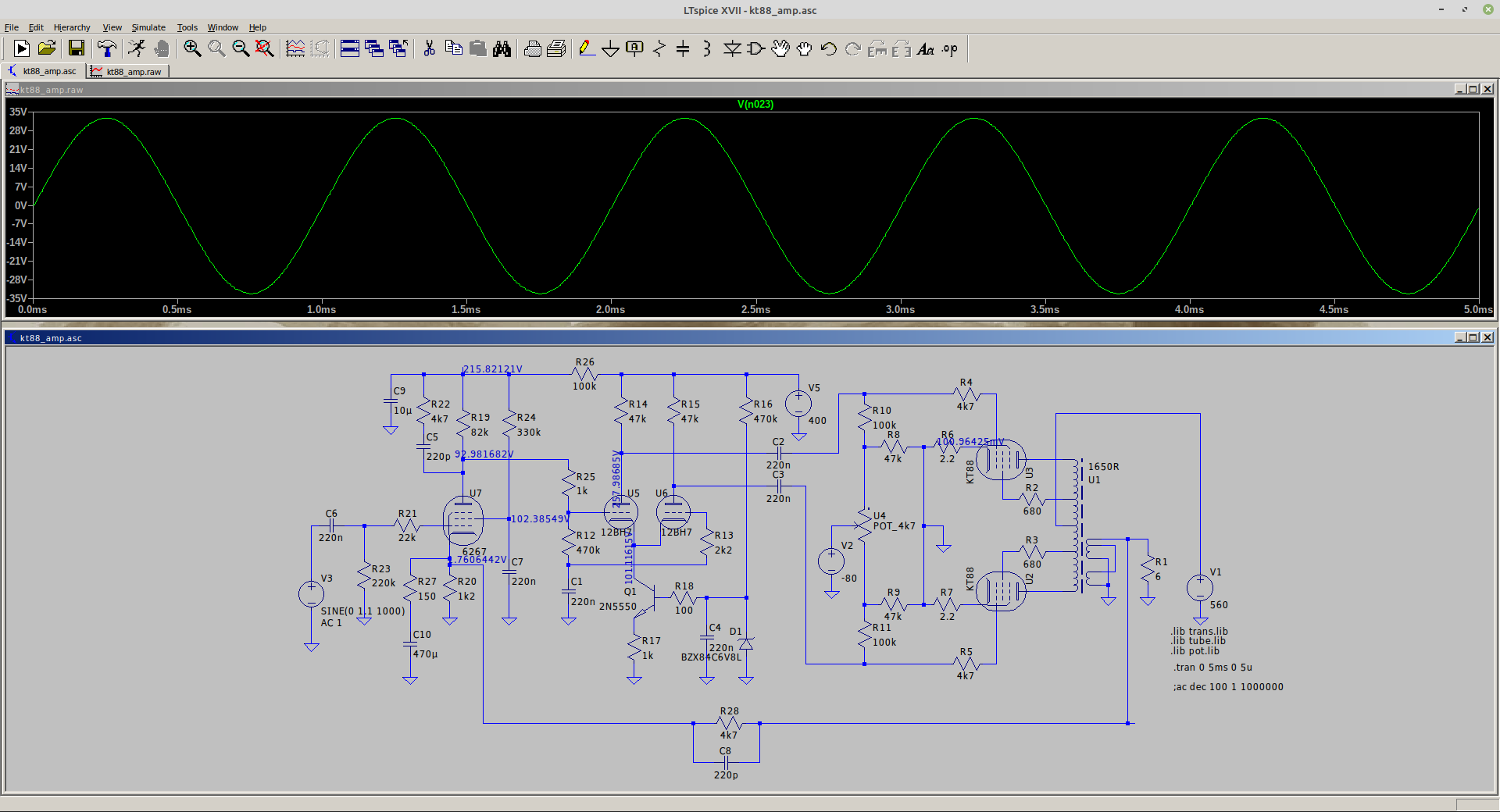

I dug out an 18K resistor and did another test run. It now appears to be stable. With R27 @ 18K I'm seeing 33.26dB gain so about 16.3dB of feedback.I have gone back to your original transformer data and corrected my model of the OPT. These are the new vales I get.
This is how things look now.
100Hz @ circa 11.5Vrms out (matches the previous testing)
100Hz @ the limit before it distorts heavily
20Hz @ the limit

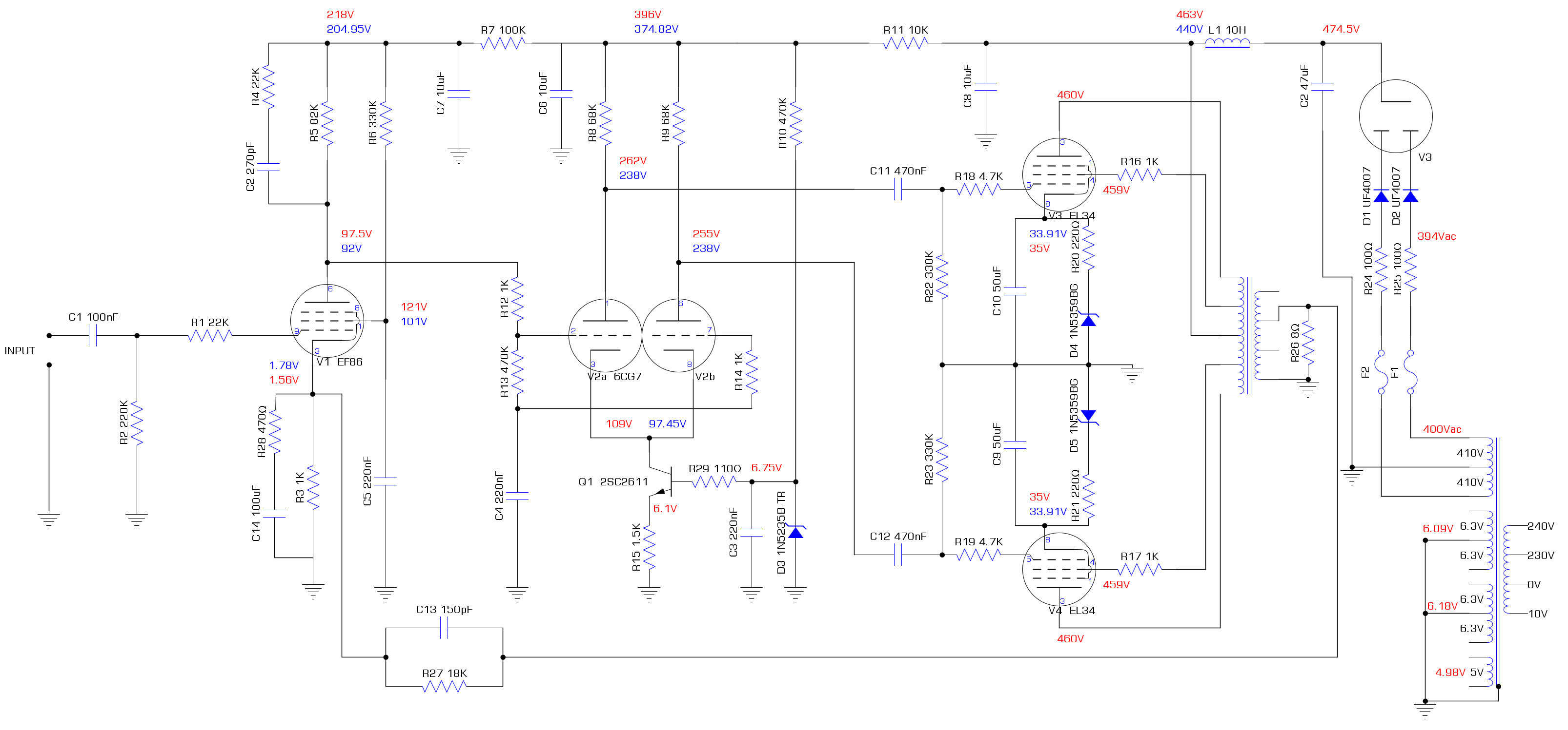

Schematic as things stand. Also note the voltage at C2 and L1 are quite a bit higher than your spice model.
That ties in with what Sowter quote about the tapped secondaries having inferior HF bandwidth. I wish I'd read that before I bought them as I'd have gone for either multiple secondaries or a single 8 ohms secondary.Interestingly I can get better results by taking the NFB from the 4R tap and using 10k+270p for the feedback components. All this seems to indicate its not the best transformer at HF.
Overall, I'm quite pleased as I've had hell getting this thing stable. It would be nice to be able to get a flatter frequency response but I'm beginning to think that is borderline impossible with the current components. (mainly the output transformers)
If that's 10KHz square that's very very good. The simulation shows you would actually get the same output power on the 4R configuration even though you are driving 8R. If you do this drop R27 to 10K. You may get better coupling. The error was having too much NF in the first place. Well done and try some speakers. It not really possible to know what you are getting with OPT things like leakage inductance are often measured at LF and there's no figure for primary capacitance. Hammond do a 1650H which digikey/mouser have. Your traces are much much better than your original scope traces with the 12ax7 driver.

C11/C12 on my drawing are 470nF vs 100nF on yours and R3 is still 1K vs 1.2K. I've attached the schematic to the board this time as altering the privacy settings to public/private on flickr changes the URL of the image.
Reading back what was written in the elektor article about C11/C12 makes me wonder if perhaps I am best off putting them back to 100nF.

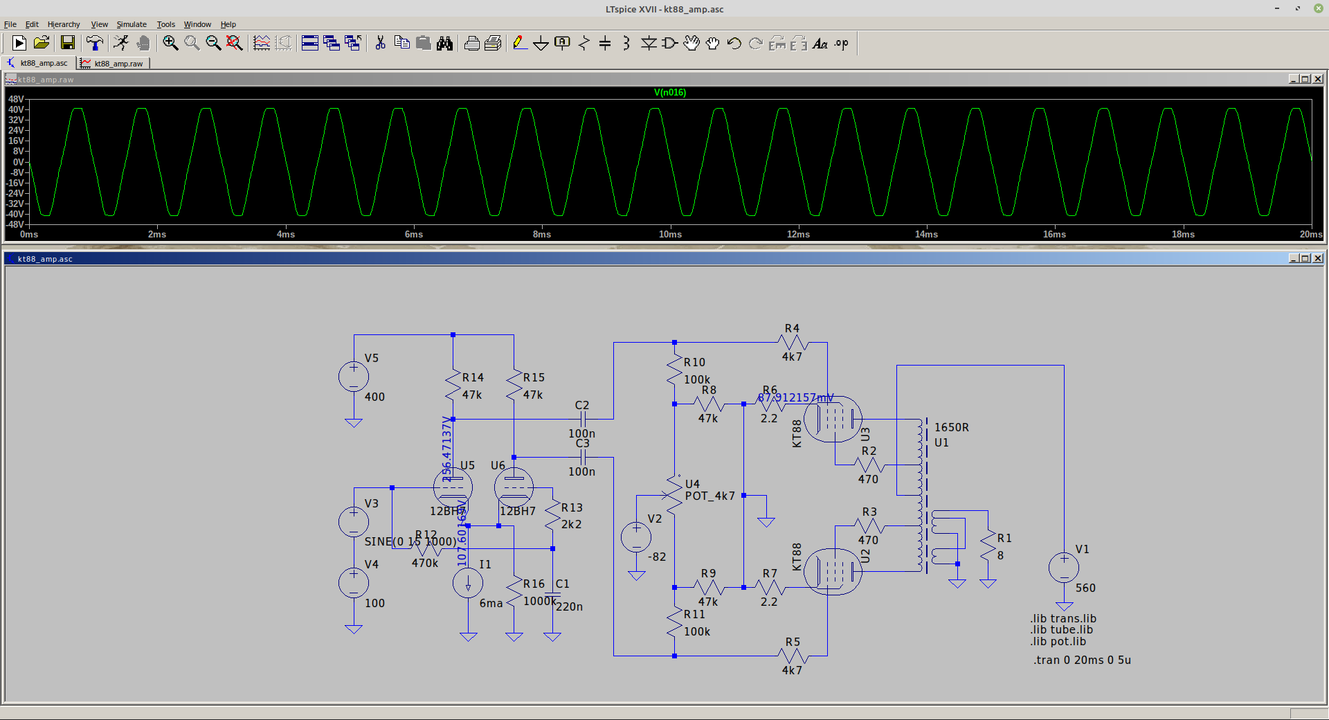

Just looking back at this drawing, I've got quite a few differences compared with how it is currently.I have gone back to your original transformer data and corrected my model of the OPT. These are the new vales I get.

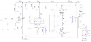

The zeners are there to get somewhere between self and fixed bias. The actual voltages are shown in red.
The problem with pure self bias is that with large signals (when you get to cut off on one side) to current tries to increase causing the average voltage to go up on the cathodes over a few cycles and bias out of conduction which results in crossover distortion which is very unpleasant. The original solution was to put more quiescent current which starts to red plate the valves. I like the term combination bias. The zener/resistor combination restrict this increase in voltage to a smaller value. Even with 24v zeners you can see on the scope some crossover distortion at full power. However making the zener voltage higher will give less tolerance to the spread of different valve pairs and may need lower grid bias resistors. Its a compromise.
The valves are matched pair so you can see from the voltages they are balanced.

AS for the LF the circuit around C4 helps a lot. The way to check is to sweep (at 1W say) from 20Hz down to 1Hz. The output rolls off all is fine. If it has a significant peak at 2Hz then try dropping the driver coupling caps from 470n to 100n.
