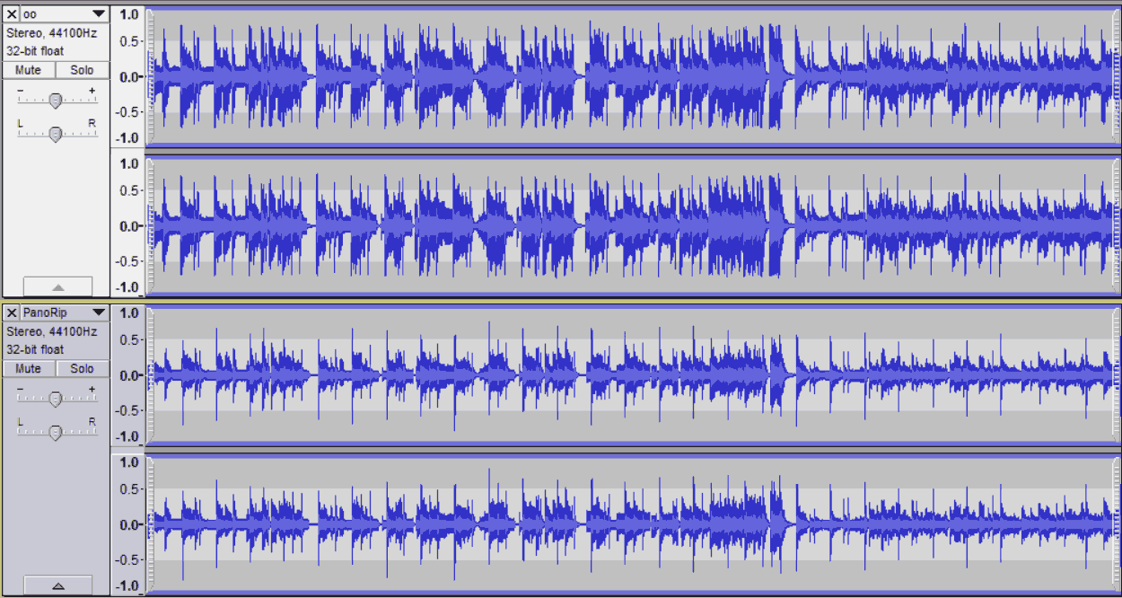

I did just that and found that the version you have has been compressed about 6dB to make it louder. Such is the beauty of "remastering". 🙄If you want to find the difference in mastering against your files, then, please, measure DR of your file or show the time envelope.
Below are the waveforms of your rip and my rip. Both have a peak value of -2dB FS
I agree, almost all mastering in commercial music after year 2000 is horrible and the newer the worse. I am not surprised at all. We are the niche. That is why I prefer to listen to recordings of classical music.
Compression adds distortion and reduces HF. Look-ahead limiting would be another matter, but 6dB is a lot of squeezing in any case. Adds distortion, needs redithering. Added distortion may help mask other distortion such as from an amplifier.
