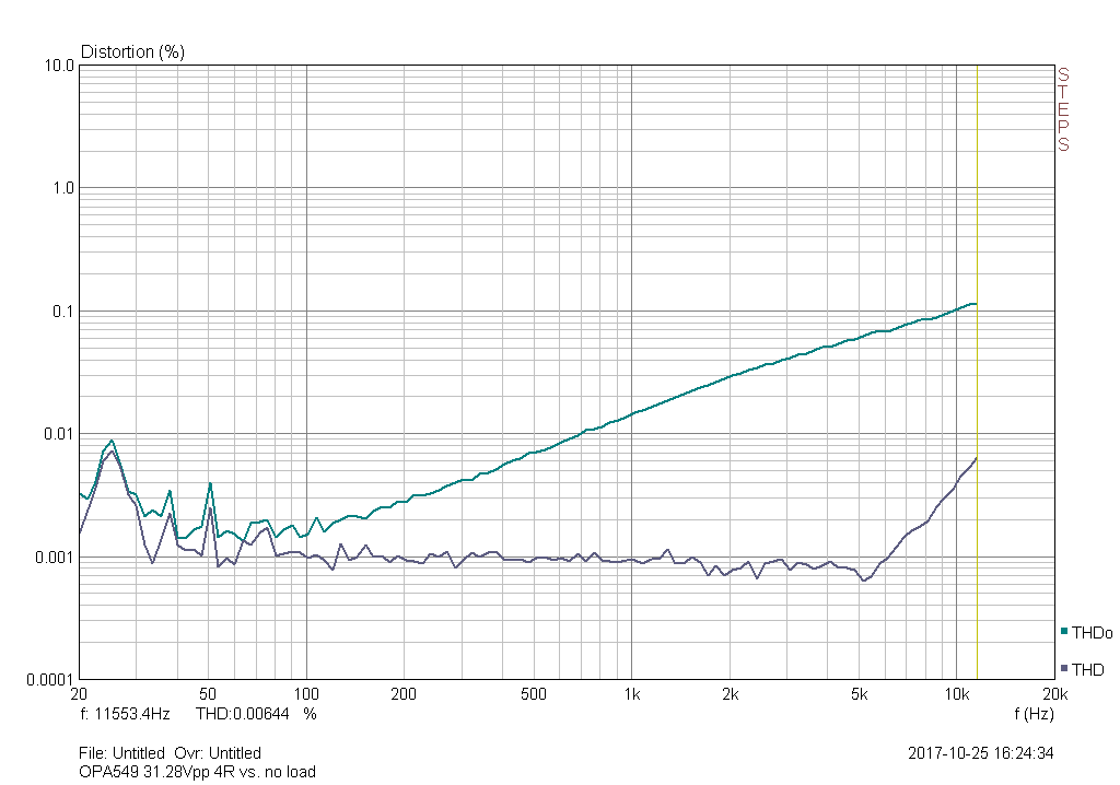

If the results of being able to discern differences in this test are accepted as statistically valid, how can we be sure the difference was down to crossover distortion when the two files have been through totally different processes (ripped original for one and a replay and record chain for the other).
It is one thing saying there is a difference, quite another to say it is down to one specific artefact.
Would a better test for crossover distortion not be a single amplifier with adjustable bias ? Optimum bias @100ma vs sub optimal @10ma for instance.
Till now, there has not been statistically valid proof that a listener is able to discern these existing files in the ABX test.
Based on nature of distortion measured (compare distortion with no load and 4ohm loaded) I claim that crossover distortion prevails all other distortions in the recording chain. Unless there are statistically valid positive results of this test, I see no reason to prepare another one on the same subject.

I would agree that the audibility of crossover distortion has not been proved although there does seem a possibility to discern audible 'differences'. Is that down to crossover distortion at HF on the shimmer of percussion... we don't know. I achieved a 7/8, a 6/8 and another 6/8. There were not lots of discarded attempts in between.
If it is purely crossover distortion that is of interest then I really think the set up should be identical for both files, with the amplifier in question biased to have more or less distortion. All other things are then equal.
Your files are impeccable as always, it is just the methodology that is suspect here imo.
