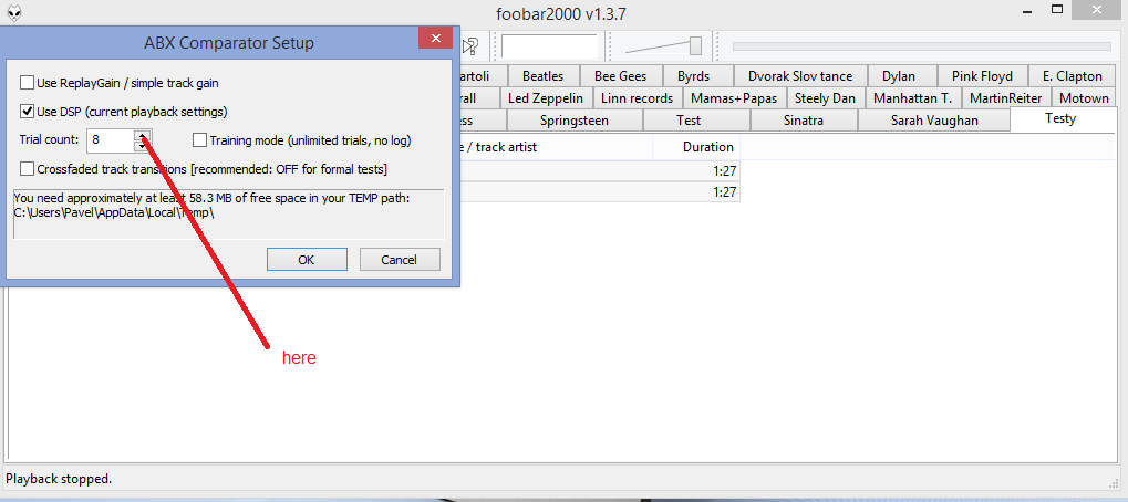

I'm only on my work computer (travel) so don't have foobar on this system -- is it possible to change the number of trials per ABX test from 8 to something like 20? 6/8 is very very different (even if you're just picking the best-of's) from 15/20.

Sure, just in the beginning when you mark the files and call ABX utility from the menu. Please see the image.

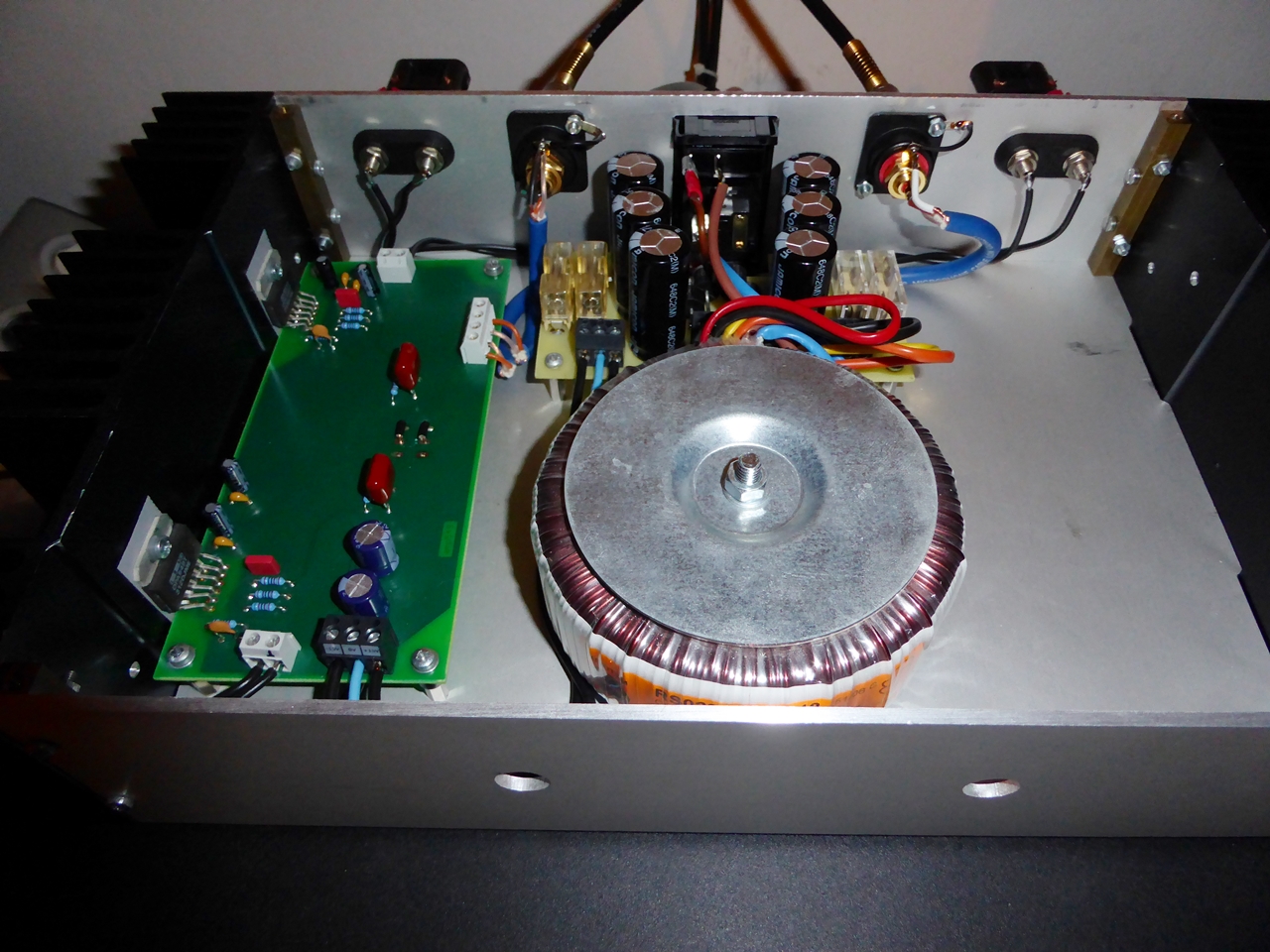

This test was intended to show that even relatively "high" value of crossover distortion (0.01 - 0.1%) is still too low to be audible. It is rather the plot that looks bad, our ears will tolerate almost everything that is 60 - 70dB below main program. I wanted to perform the test on the real amplifier and the OPA549 was a perfect candidate. It has low distortion when unloaded and all the artifacts get up only with load. Inaudible artifacts. And the magnificent 7th as well. End of the myth 😉.
Edit: the amp module shown built in 2006.

If the results of being able to discern differences in this test are accepted as statistically valid, how can we be sure the difference was down to crossover distortion when the two files have been through totally different processes (ripped original for one and a replay and record chain for the other).
It is one thing saying there is a difference, quite another to say it is down to one specific artefact.
Would a better test for crossover distortion not be a single amplifier with adjustable bias ? Optimum bias @100ma vs sub optimal @10ma for instance.
