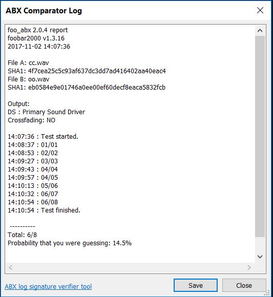

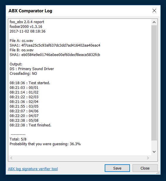

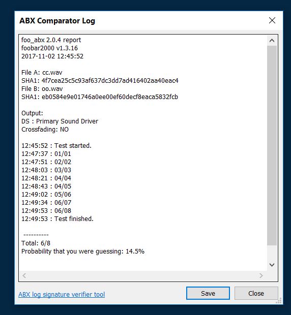

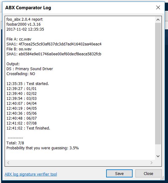

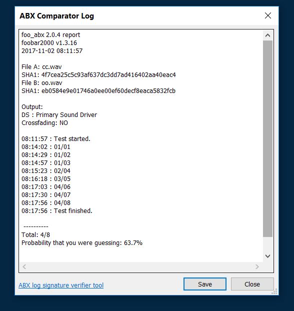

Different approach. I'm using my main system and feeding the line out of the PC into my main amp, no headphones this time. Flat response, playback level 'moderate' to 'low moderate'. Concentration level... ultra intense 😉
(I've just had a beer and its all gone to pieces 😀 I'll try again later)

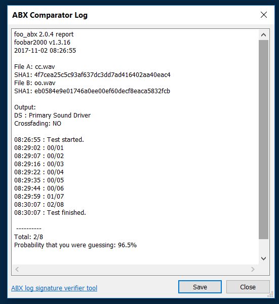

Only one way to find out 😉 I was listening to the percussion that had a right channel bias around 48 seconds in.
Did another run after having eaten. A bit tenuous maybe.
I'd like to say that there is one of the two that seems to have more life and better timbre in the HF and yet saying that of course begs the question why I can't get it right every time. I think the concentration needed is an absolute killer, as soon as you even move a fraction, what you thought you heard is changed.
I can say which of the two I prefer if Pavel wishes.

the "probability" number is calculated by the abx software and there is no way how to affect it. It depends on the order and number of successful and unsuccessful attempts...
Yes, this is what I expected, but the values look very...suspect, to be polite.
The ABX creator may know software but seems not to understand statistical inference.
I think you are correct to use only the test numbers.
Best wishes
David
Does that mean that you had a few runs with less correct picks, and you didn't show them?
Obvious sample bias in that case.
Just find an excuse to leave out all the cases with less than 50%
"Oh, I won't count that one, I messed it up"
"I didn't concentrate hard that time"
And so on.
Not that you would do that😉, but it's remarkable how many people don't understand statistics.
Or even realize that if one cherry-picks results then they are worthless.
A bit of a problem for Pavel since the results here are self reported.
Always a risk that someone will do a few trials until they hit an impressive score, not too hard even if only luck, and then post the screen shot of that trial "Look, I can hear the difference easily"

After the beer I did one quick test and it was a 4/8. I haven't done loads of runs and only picked the best. If you look at the three I posted earlier today then they were all consecutive. And so to the runs via the main amp and speakers.

Very good Karl, however I am not sure if one 6/8 positive result from many unsuccessful attempts is statistically enough. Because between many trials it is possible to get 6/8 for once. So my question is, is the result repeatable?
I would also appreciate if you guys who have a positive result would post the whole test protocol. The reason is that it has a digital signature and can be then validated at
foobar2000 ABX Log Signature Tool
Do not get me wrong Karl, but I have just achieved 6/8 from pushing just always "X" in every of 8 votes.

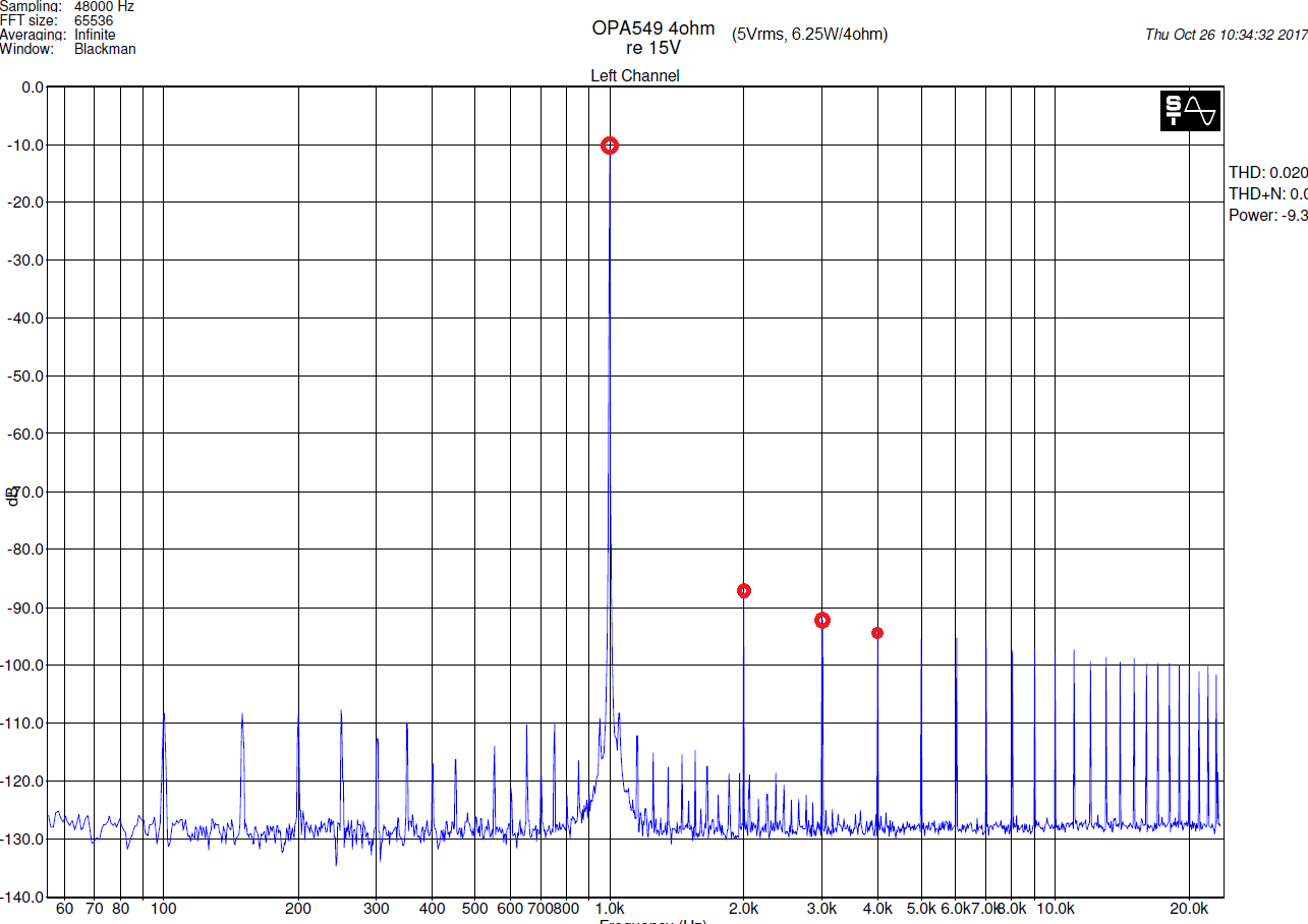

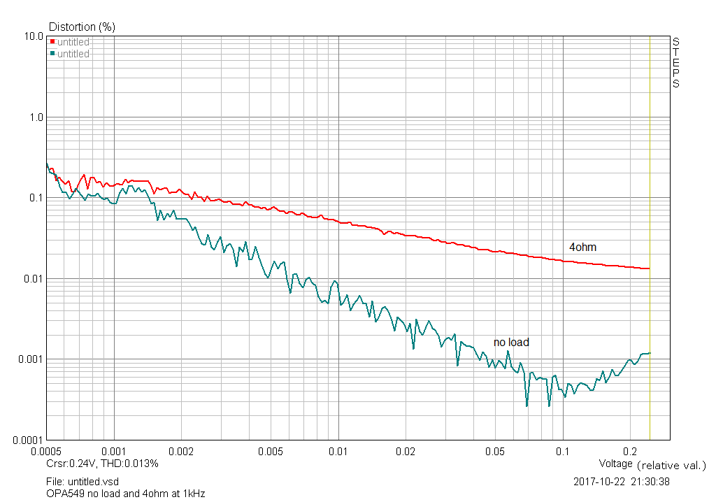

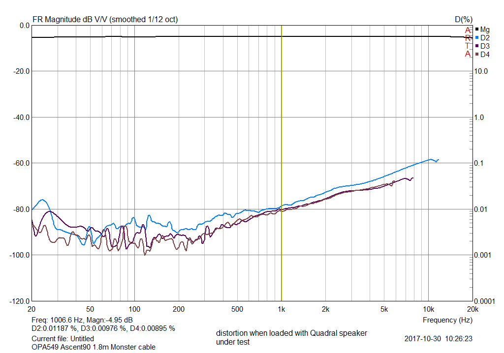

Attached are measurements of distortion of the amp under test. One can also see that it is almost purely crossover distortion, which disappears when the output is not loaded. Also please take into account that tested are original data vs. D/A - amp - A/D chain with no so called high-end components used.
