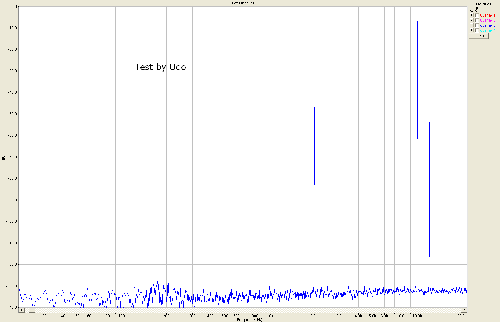

High Pavel,
Thanks for the THD diagrams of your amplifier!
I am pretty shure that 0.1% THD, which is shown in the diagram of your
amplifier can be detected in sine tests.
To test this i generated two intermodulation test files. The first one has two
sine frequencies at 10kHz and 12kHz.
The second one has 1% THD added.
Because of the nonlinearity a new frequency at 2kHz is created.
Even with my laptop soundcard it is easy to detect which one is distorted.
Please test it with foobar ABX. If there is interest and 5 people send me the ABX test results, i can generate files with 0.1% THD or with real music signals too.
Udo

Pavel,
My test file is there to show if 1% of THD could be audible. It has nothing to do with
your amp. The THD is generated by sending the two sine waves through
a nonlinearity y(x) = 1*x + 0.01*x*x
If you wan't to limit the discussion to your amp, i can create a new thread.
Udo

Yes i know that IMD test is not very sensitive to 3rd order distortion.
Therefore i have used the 0.01*x*x second order term.
But the idea was not to model your amp (should be possible by including higher order
terms in the polynomial), but to do ABX testing of the audibility of distortion.
The nice idea is behind the polynomial nonlinearity is that i can use real music signals and
hear if the distorion is audible.
