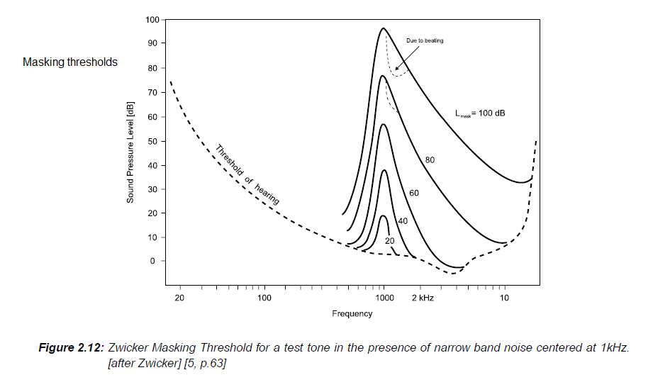

I must say very clearly, we are very deep under all known masking curves and thresholds of hearing with this sine test and its distortion components. So there may not be a positive ABX result, in case that the listening HW is not defective.
Masking thresholds

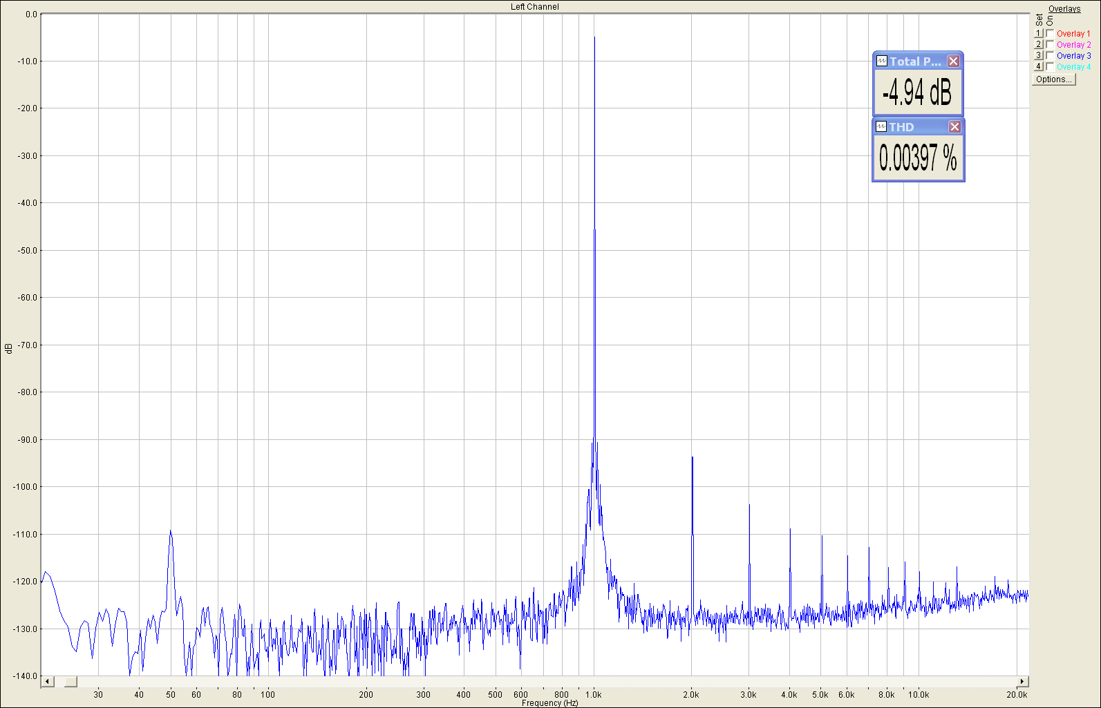

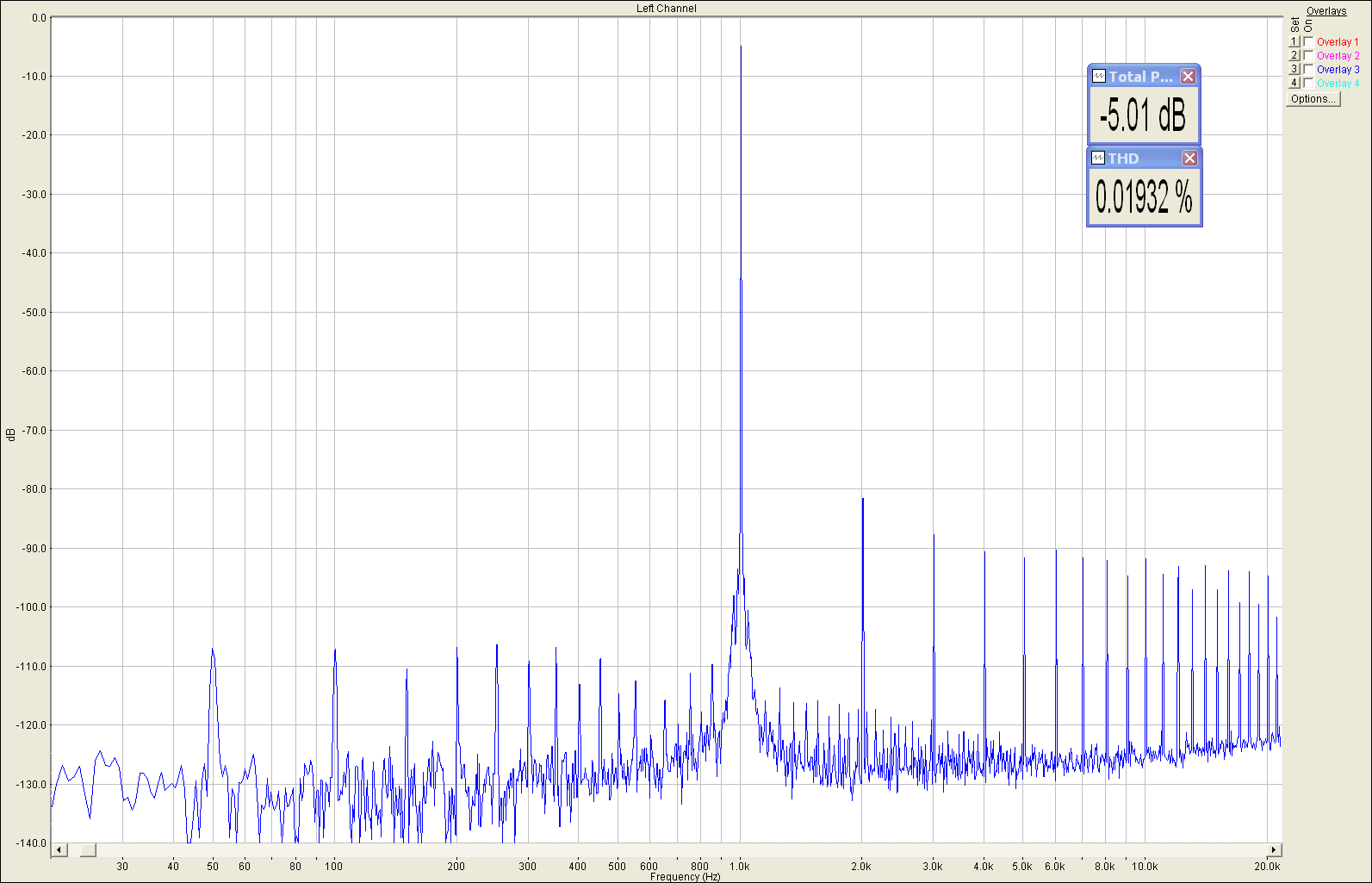

To conclude, I am posting the non-linear difference between the last 1kHz test tones (1khz_orig and 1khz_opa549), small interchannel phase shift corrected.
http://pmacura.cz/1khz_549diff.zip
Try to listen to it at the same volume level as you did in the 1khz listening ...
Attached are as well spectra of the 1khz_orig and 1khz_opa549, with distortion number shown. The test tones were recorded simultaneously from analog generator to prevent phase and pitch differences. One path was direct from generator to A/D, second path went through OPA549 loaded with 6.8 ohm. Levels matched in analog domain by a pot.
In the situation when single sine tone distortion is not discernable, other than by playback equipment error or poor parameters, it is useless to continue with music samples.

Pavel, the new data files have problems too.
The level is off by about 0.1% and the second file is inverted.
The test files are 16 bit / 48kHz and are on the limit of a 16 bit system.
You loose 6 dB because they are not at 100% amplitude.
The first harmonic is at -88dB.
There is no dithering added and a lot of harmonics at -95dB.
Please start with easier training files with 1% distortion at 24 bit / 96 kHz.
If they work and we have learned to discriminate better,
you can make the test files harder.
