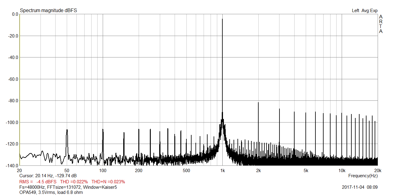

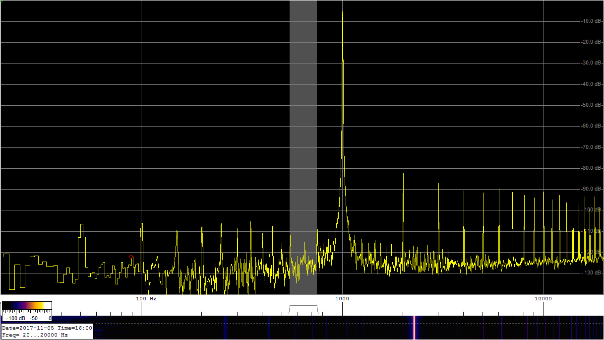

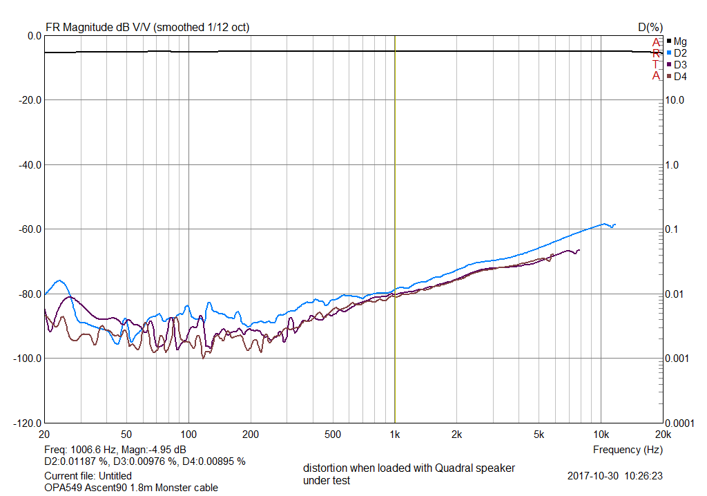

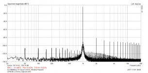

very often we hear about audibility of crossover distortion (without any specification of level of harmonics) or about the 'harmful 7th harmonic' even if it is 100dB below the basic harmonic. I want to show that we need to take into account quite complex view before we start with conclusions about amplifiers. Second, I am not sure that limits of hearing of non-linear distortion are well described in their complexity.
Attached please see several plots from the amplifier under test. I am sure it would be described as too bad. I was doing the same mistake in evaluation of the distortion plots some time ago.
