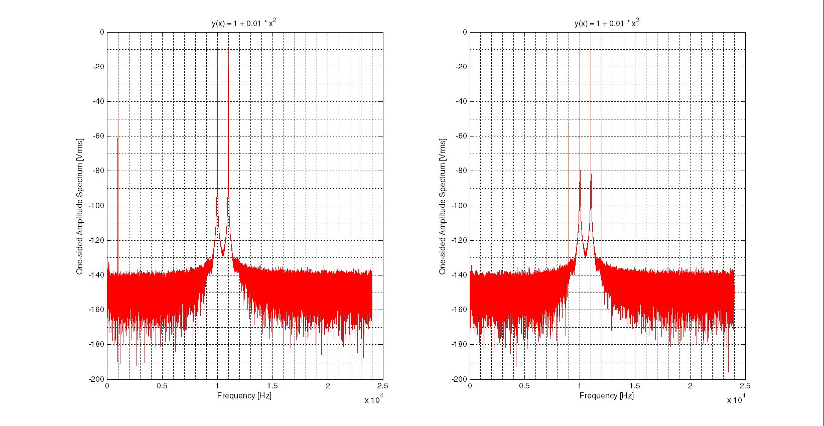

I have filtered the DC and the 2*wt term because this would introduce aliasing..
Not my point 1% peak nonlinearity in the transfer function produces 0.5% harmonic distortion.
I assume that the factor 2 goes away because of the two sines at 10k and 11k?

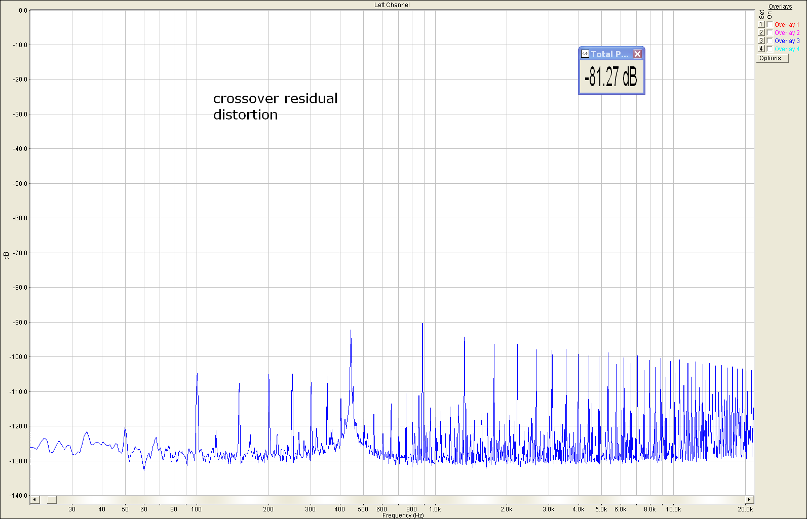

Back to the crossover distortion test topic - this is interesting, it is the difference between 440_orig and 440_opa549 file, with phase shift eliminated, and grossly magnified (Y axis is in samples). One can easily see the nature of the crossover distortion.
Attached is also the difference file in zip. Should be played in normal volume same as for 440Hz files.
You just need to take care of the bookkeeping in differentiating between THD and IMD.

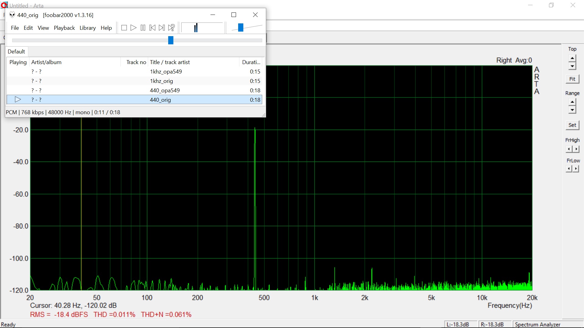

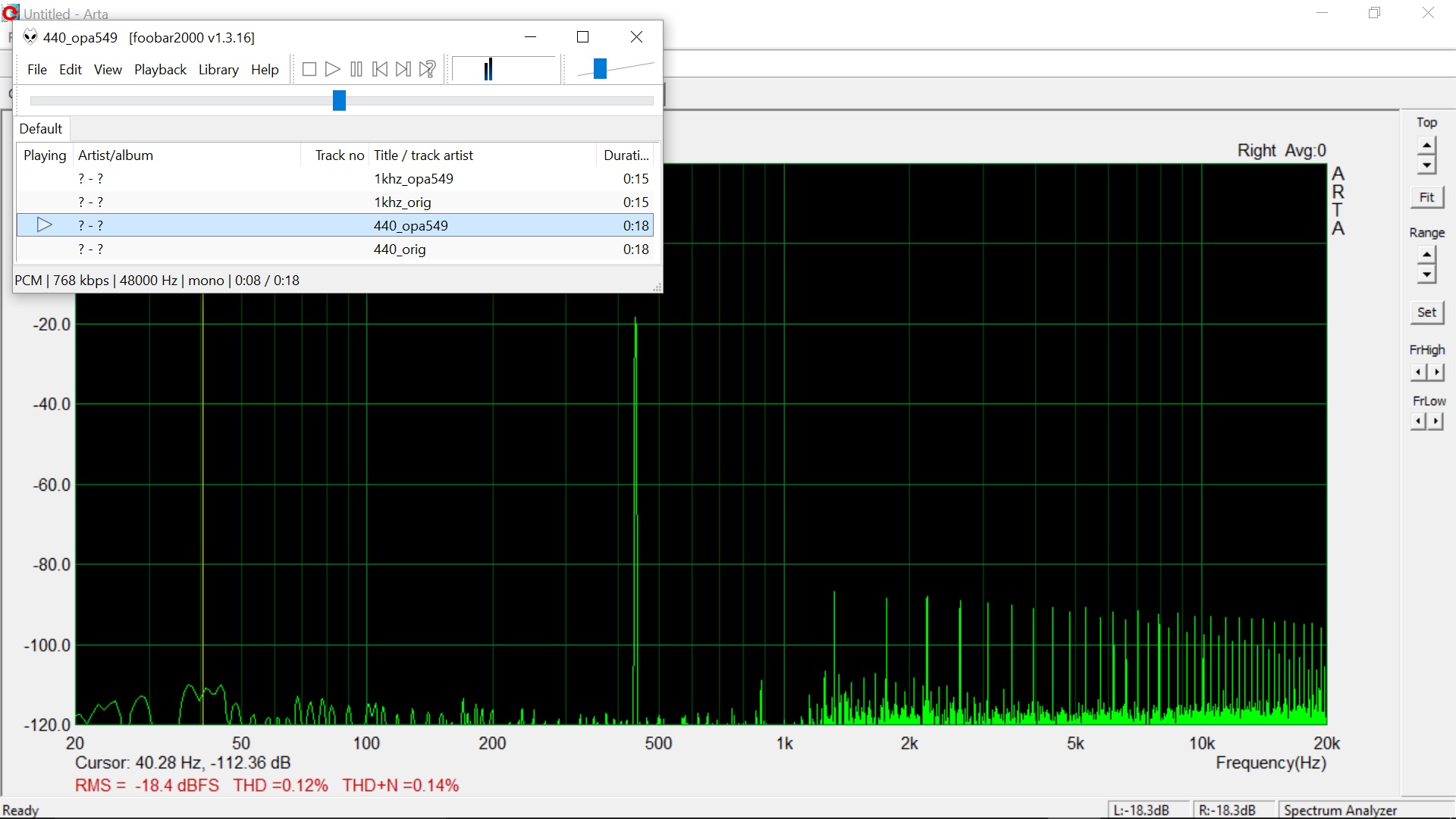

Tried with my "bad" amplifier and 12/12 another time. Only for curiosity I test the output for this amplifier and I get the images posted below. Harmonics are worsened much more for 440_opa549 than for 440_orig, and see H2 is lower.

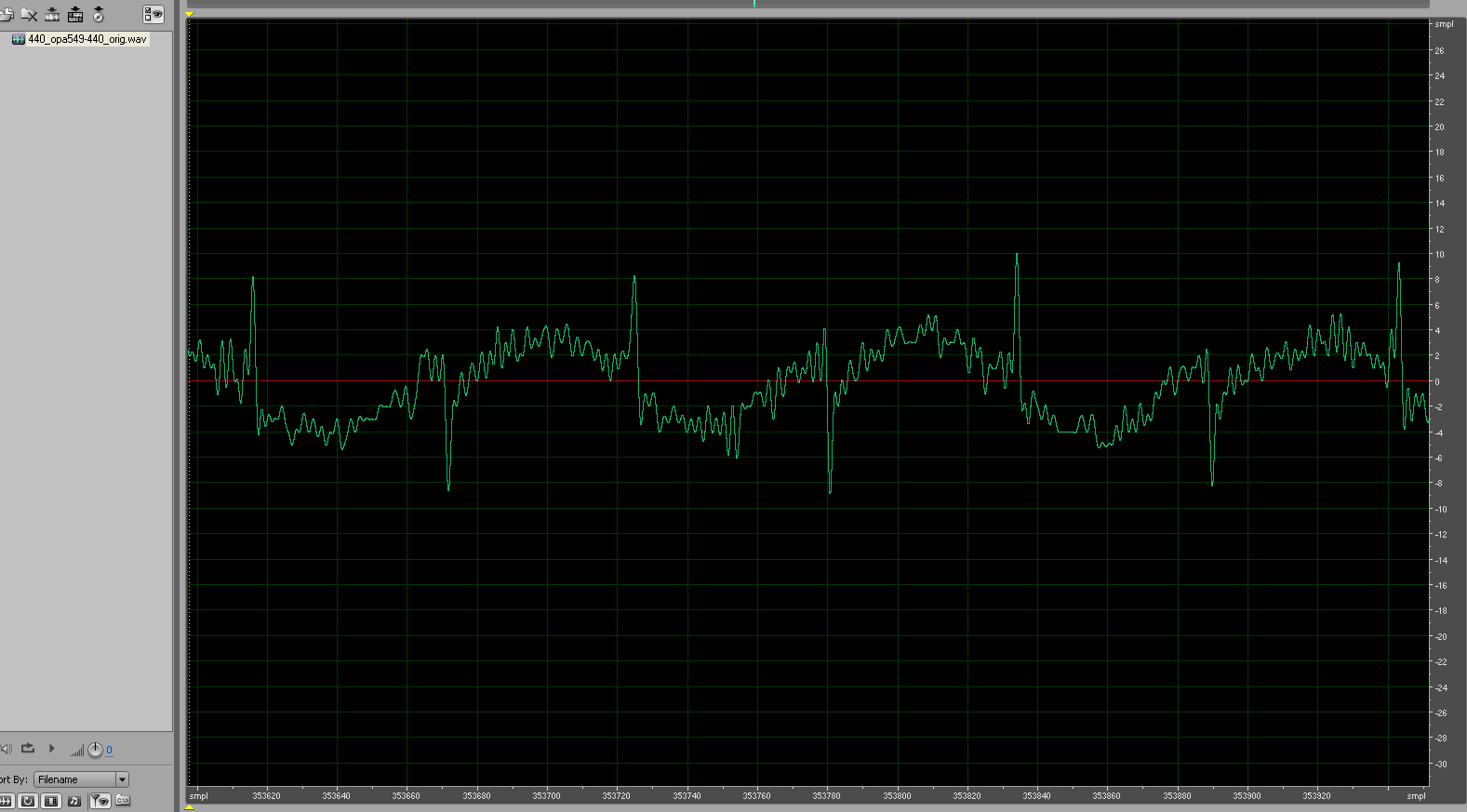

This track is amplified like the image you posted, I suppose.
I never imagine the crossover distortion sounds like this. Very thanks for posting it.
It would be very interesting to hear only the crossover distortion of your opa549 amp for an audio track. Can you post any?
Thanks in advance.
I should have said zoomed rather than magnified or amplified. There was no further sound amplification used. You have to compare the extracted distortion file with the 440_orig sine file in foobar by switching between them at same volume and you will find the extracted crossover distortion inaudible. I will try to prepare the sound file with extracted crossover distortion from music, but it will need quite a lot of time. In case of Mooly's files it was easy, as they were simulated, not recorded.
