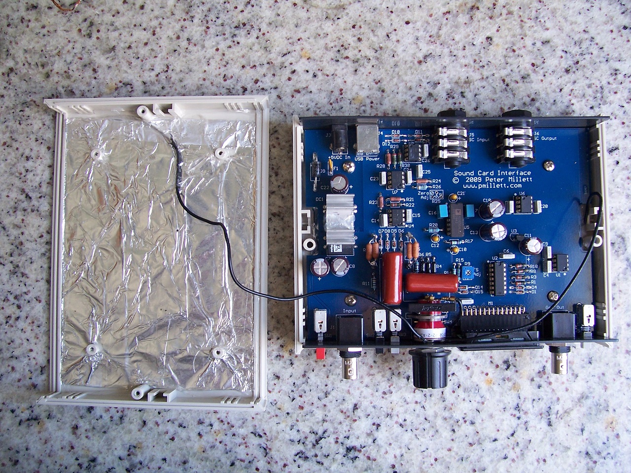

I just found some aluminum foil sufficient. Just be sure not to work with the JIG close to noises lamps, cellulars, etc.

I'm assuming you've grounded the foil?... If yes, how did you make the connection (a bit visible in the pics, but wondering if you've found some detail particularly useful).
I wonder if copper foil would be a marked improvenent over aluminum. Al would make it effectively free, though.
Yes, top and bottom foiles are grounded, as well as the range selector chassis. All converge to the rear power button ground.
Of course the foils are insulated to prevent shorts with the PCB!

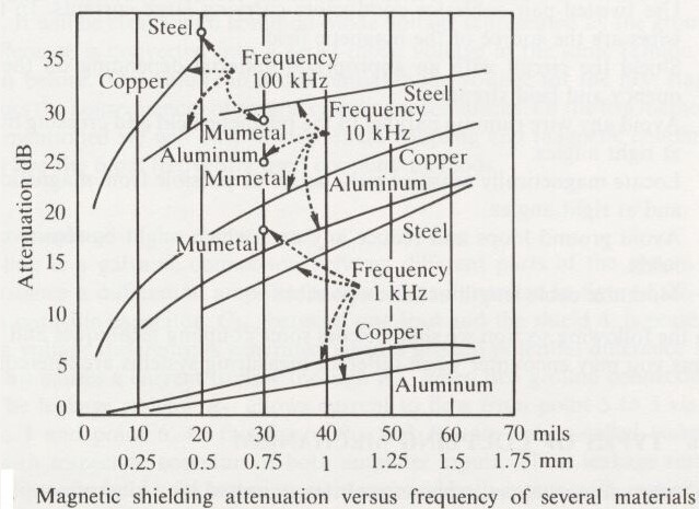

Shielding materials are quite intriguing, and as always happens, there isn't a
perfect material for all the purposes. Shielding attenuation depends on the frequency you want to filter. Attached a graphic explanation: till 100k Hz Mumetal is the best, after that frequency, no more......
