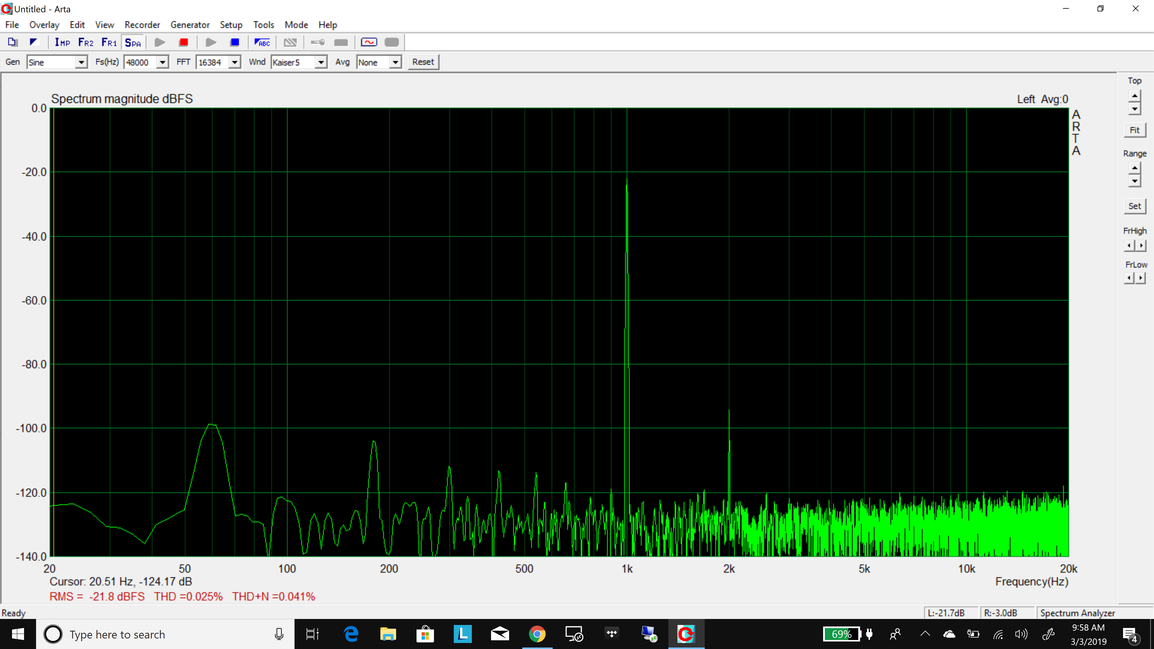

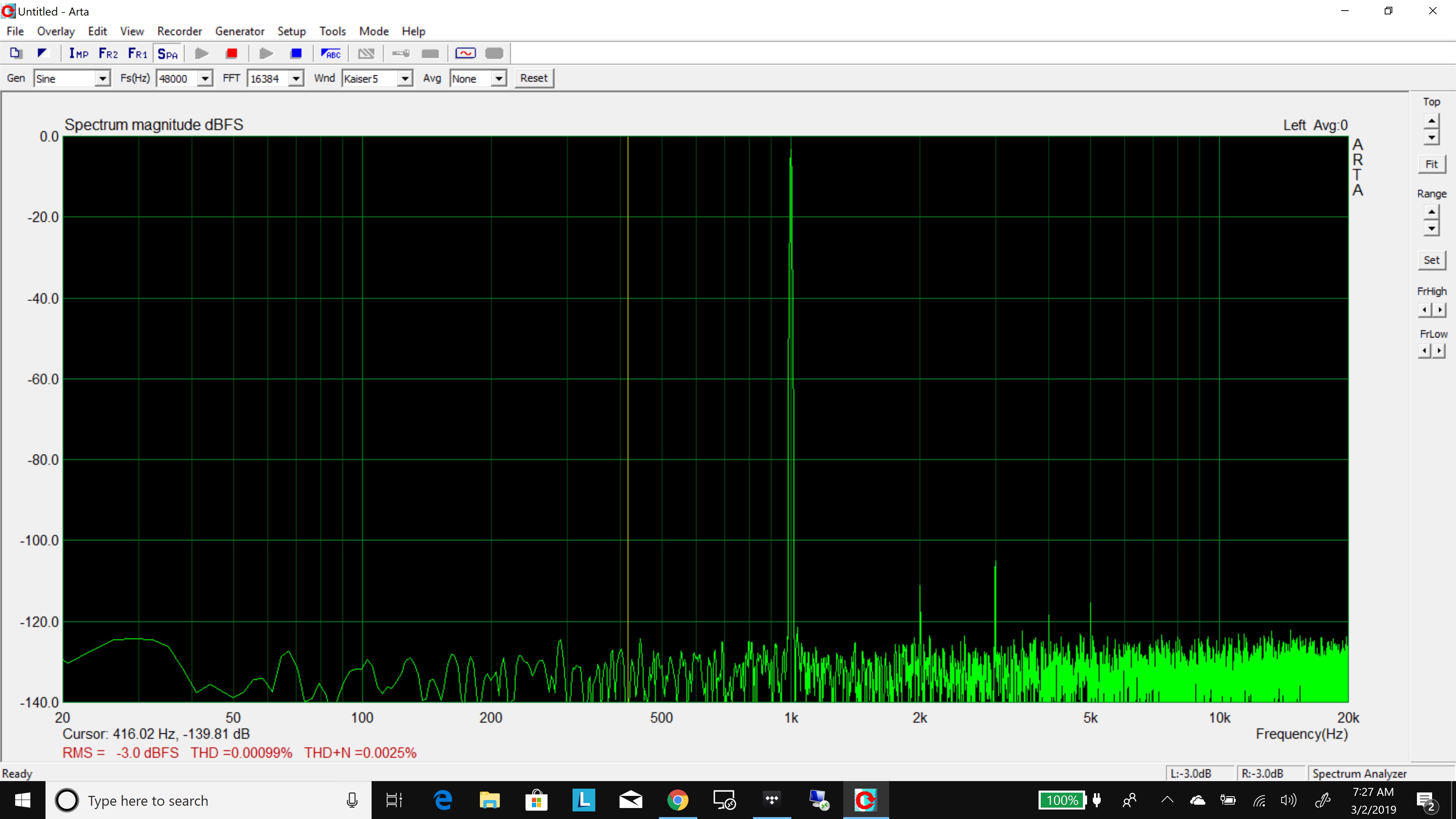

Yeah!!! First spectrum of interface!...
Oh, boy. Just generated my first spectrum on this new rig. At this point, trying to get it nailed down via SC/interface only (no PM interface). Using a 2i2, loopback configuration.
I am getting some periodic spikes, as depicted in the second spectrum (a sample, but these spikes take different forms). Windows processes?... Not sure what all that is.

Typically these spikes in arta are buffer underruns somewhere within the audio chain (incl. Arta itself). Try to increase the buffers/latency if your soundcard's windows driver offers such feature. Simple to do in linux.
It seems I'm maxed out at 1024 buffer size - but I assume the spikes can just be disregarded?
When you enable averaging (which for real measuring is kind of standard), the spikes will ruin the chart since it takes very long to average out and settle down.

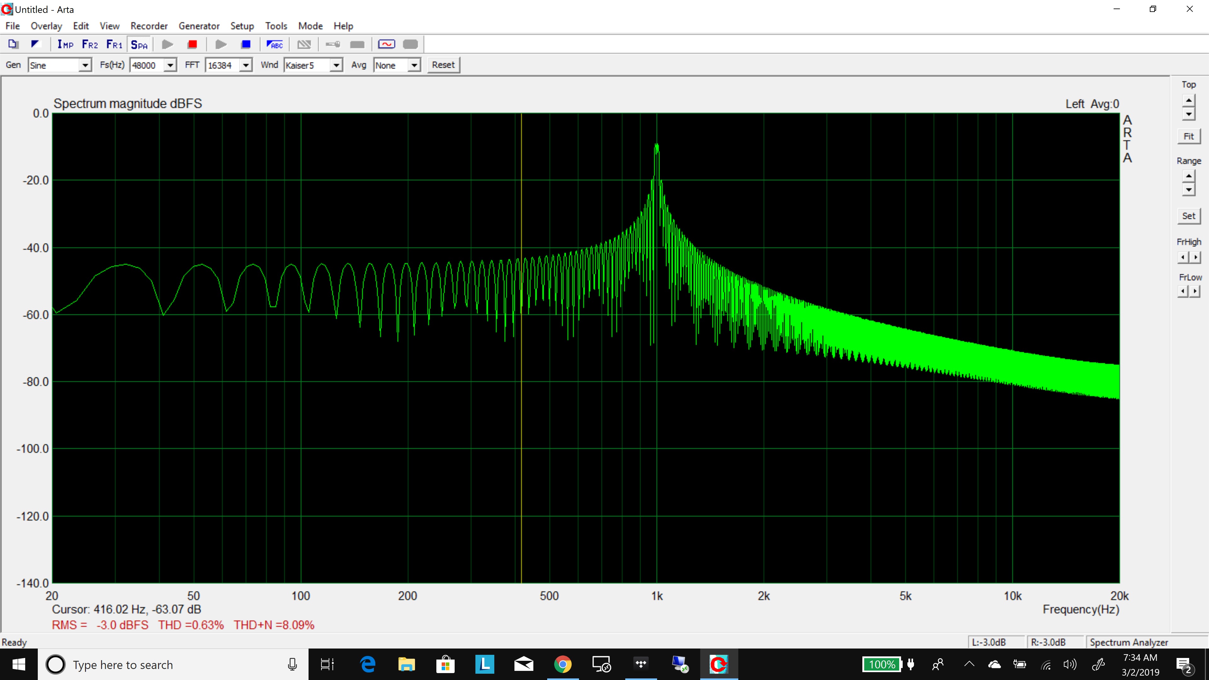

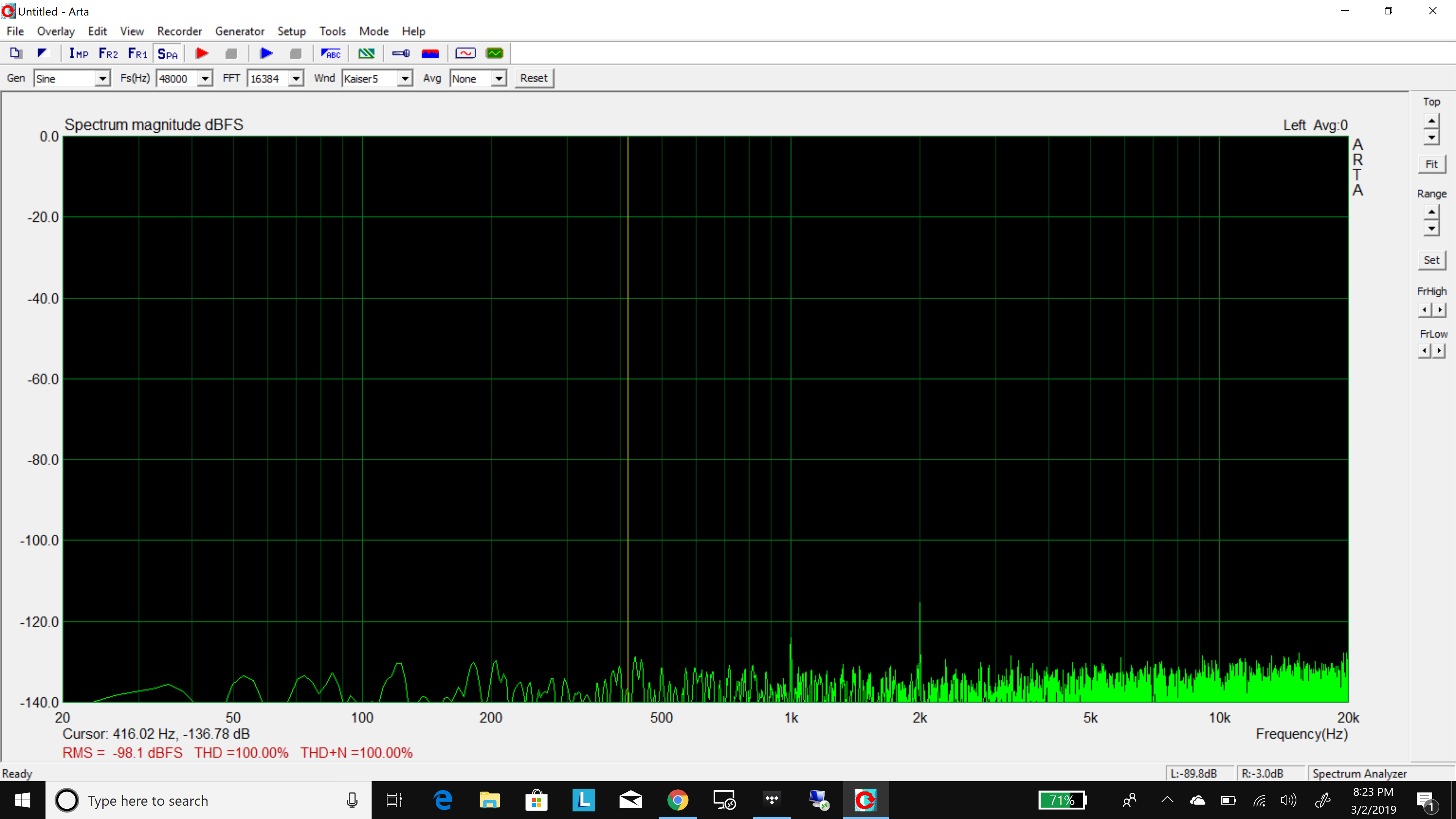

I now have the PM Interface connected to the 2i2 as per diagram by dch53. I've looped the GEN OUT to its INPUT to reproduce the "loopback" setup from the ARTA manual (while including the extra PMI). I don't see anything coming through the chain (other than noise) - I can even read shorted input 0.2mV level noise measured by the PMI voltmeter. It seems that nothing going through the loop.
Given that I was able to measure, even calibrate, the PMI voltmeter per my own HP 8903B, I am beginning to suspect the DRV134PA may be shot. It's the link after the AD535 and before the SC OUT. Though maybe user error?...
Here's the spectrum.
I usually terminate and restart the measurement when that happens, which it can often.

On this topic, I now suspect mains-borne interference spikes are my problem, not other processes running on the computer. A couple of times when the traces have gone haywire I'm sure I heard something. Possibly the fridge switching on and off. I do hear small splats on the HiFi when that happens.
Arta has a button Reset for restarting the averaging. I have not spotted it until now, while having used Arta so many times, always switching to None and back to enabled. How simple 🙂

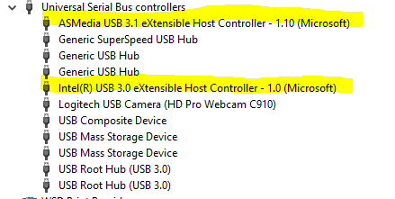

On a desktop it could make sense to get a USB card which would go directly to the bus and then to memory. Laptops that support this have mostly passed from the scene.
IMO every USB controller uses DMA, be they onboard or located on an add-on PCI(e) card. The connected device does not have access to DMA directly.
A firewire card could do DMA directly but I have never used any. Definitely good at low latencies, i.e. less susceptible to buffer underruns.
On most PC's there are more than one USB controller. see pic. If the controller channel you are using is also supporting an external drive like this example you could get the dropped sample problem.
