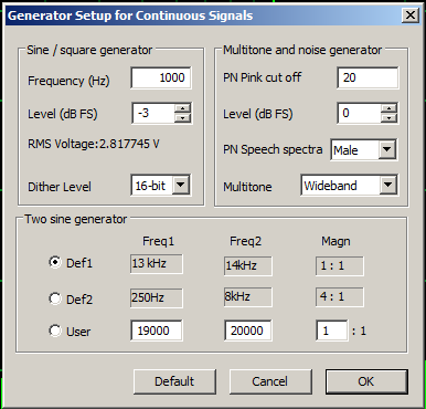

Anyhow, I found something abnormal which could be related. I generated a 60hz sine wave in ARTA with my DMM connected to GEN OUT. With GenMon enabled, rotating the range switch changes the measured voltage. For example, range is set on 20V and both my DMM and interface show 3.06V. If I rotate the switch to 2V, the interface shows the overrange sign, and my DMM shows 4.3V. So the display is correct, the issue is that changing the range with GenMon changes the measured voltage. I am assuming this is not expected?
With GenMon disabled, the DMM measures 2.8V and its the same no matter how I rotate the range. Thougts?

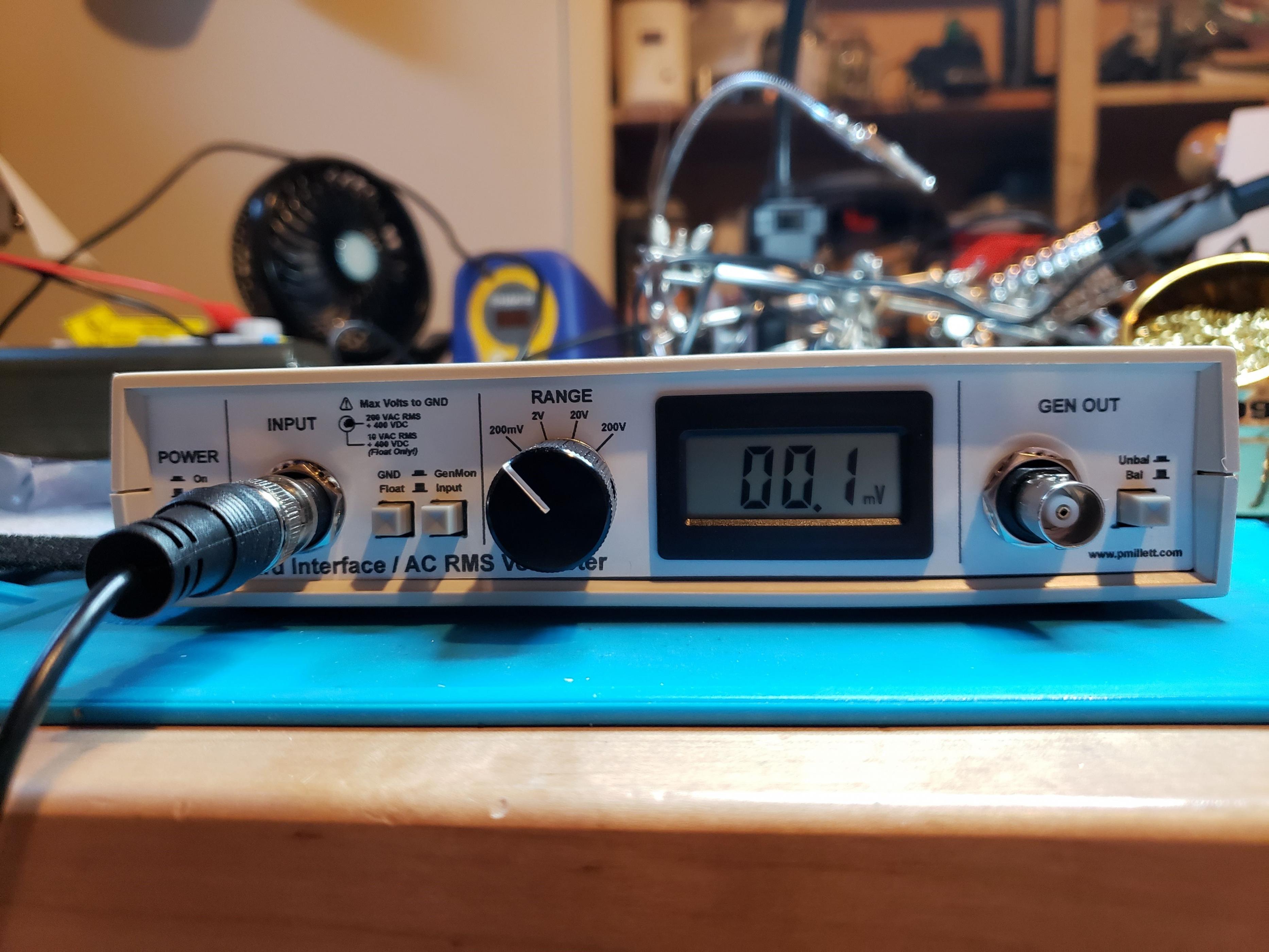

Ordered the board and panels from Pete along with all the parts from digikey/mouser on Monday. Received the board on Tuesday (good job Pete) and the parts on Wednesday. Finished assembly this morning. It zeroed out fairly well. A little bit of variance at the upper end of the scale from the Fluke DMM. Haven't put it on the scope yet. I did test and log all the resistor and capacitor values if anyone is interested.
Anyway, it went together with no surprises and I expect it'll work the same. Will do some testing this afternoon and in the morning. Overall I'm impressed with the quality. Only quibble and it's really minor is that the pads for many of the capacitors were a bit small for my soldering iron tip.
Can anyone confirm if this is the expected behavior or not? If rotating the range knob changes the input impedance then I guess the measured voltage should change as well (given the soundcard is generating a constant signal)
You may overdriving a stage in the unit by going to a lower range which switches in more gain. If you look at the signal you probably see it is clipped. Check the circuit diagram what happens when you switch ranges.

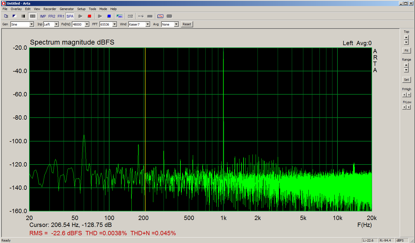

Hi all,

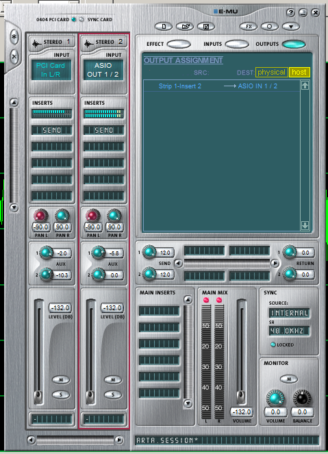

I would love some assistance in running my first series of tests. The DUT in this case is a DIY headphone amp I built a while back. It is connected to a 100R resistor I _think_ all of my connections are correct.
I'm running the tests on my PC with Windows 7 and an E-MU 0404 PCIe card.
The things I'm unsure of right now are:
1) Are my E-MU PatchMix settings correct?
2) What are the recommended generator settings in ARTA?
3) How to set the volume control on the amp? Should the volume be set so that the output of the amp matches the input signal, fully open, or something else?
I am attaching some screenshots of a test I ran. In this case, the volume pot was set so that I read the 2.81V in the SC interface (and this voltage was confirmed correct with my Fluke 87-V DMM).
Thanks in advance!

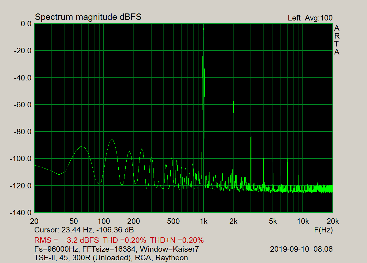

I made some progress here and I believe the FFT plots I am generating are fairly accurate, attaching one of them of a tube headphone amp I measured.
Could someone please advise what is the proper way to measure undistorted max power output?
I am unsure how to do this, as the SC interface will scale the signal. I am using ARTA for software
What I do: First, I find how close to 0dB my sound card can reach in loop measurement before clipping. If this point is not exceeded, then I expect that clipping should only appear at the D.U.T. and this will define max output. Just scale the PC interface so that I get closer to this dB level for a better signal to noise measurement. Lacking an oscilloscope, I find the clipping threshold using ARTA time record window. However, it's not real time record, you have to do some trial and error. Check REW for a real time oscilloscope.
