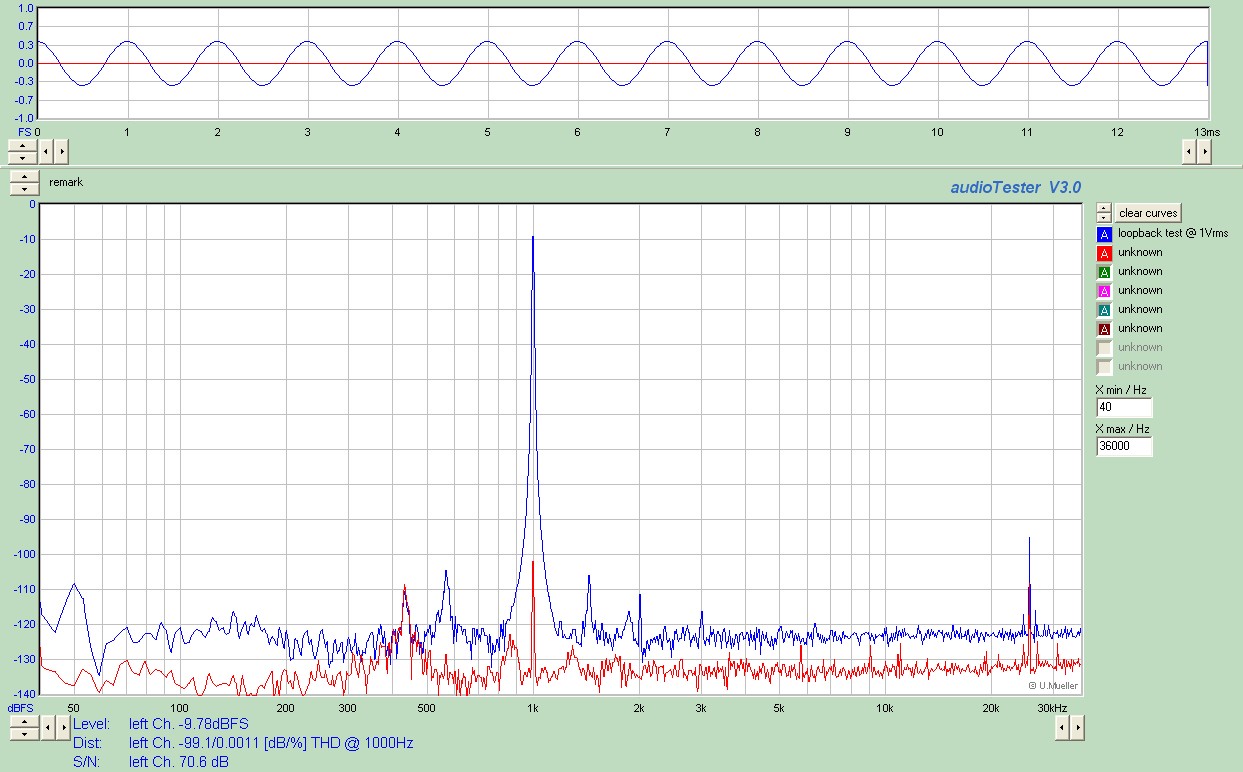

Thanks Pete,
Orderer the spare parts already. I measured the soundcard input DC and was surprised there was an DC offset. I thought there was a blocking capacitor?
Ale
Check for shorts to the supply rails, etc., I had a problem with my board and it turned out to be an almost invisible short between ground plane and the negative rail. Shorts to other places are possible. It took an 8X loupe to see it. Mine has worked fine since I found the problem - more than a year now.
Thanks Pete,
Ale
There should be no DC offset. Measure it unplugged from the soundcard. Does the LCD meter read 0? If so the output driver (U8) may be damaged.
Follow the signal back... there should be 0V DC on the outputs of U4, the output of U7, also the output of U8. Assuming +/15V are OK, there must be another damaged component causing the offset. Maybe the protection diodes in the front end?
Pete
Here is the summary of the first repair of Pete's interface 🙂
After checking all voltages without ICs it seemed ok to try following test input signal and adding each IC for every stage. Started with U4, then U7 and finally U8. All had to be replaced...
Lesson learned: label your soundcard cables so you don't make this stupid mistake. 🙄
Attached is a loopback test with the soundcard
Thanks for the help
Ale

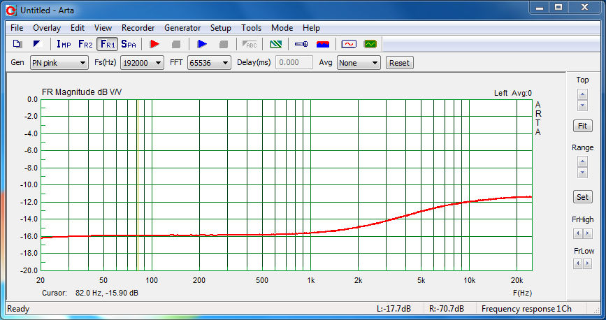

Just tried assembled Sound Card Interface (further referred as SCI), with ESI Juli & ARTA, and have some oddities/question(s):
1) Frequency response is not flat (look at the graph attached). I'm sure I did something wrong, but where to look for possible bugs at first? Voltage from sound card is OK (I meant the same at all frequencies). Mode is 192KHz/24 bit, displayed by ESI monitor, FFT window in ARTA 65k.
2) ESI Juli works fine with up to 2.8V input voltage, 0.5V from SCI is a way too low. Is it possible to increase output voltage from SCI to "sound card in" to about 2 - 2.5V RMS without degrading precision of THD measurement.
3) The best precision so far I've got with SCI is 0.033%, with INPUT/GEN OUT both connected to 33K resistor. IMHO this is somehow relate to problem #1.
Thanks in advance for any suggestion(s).

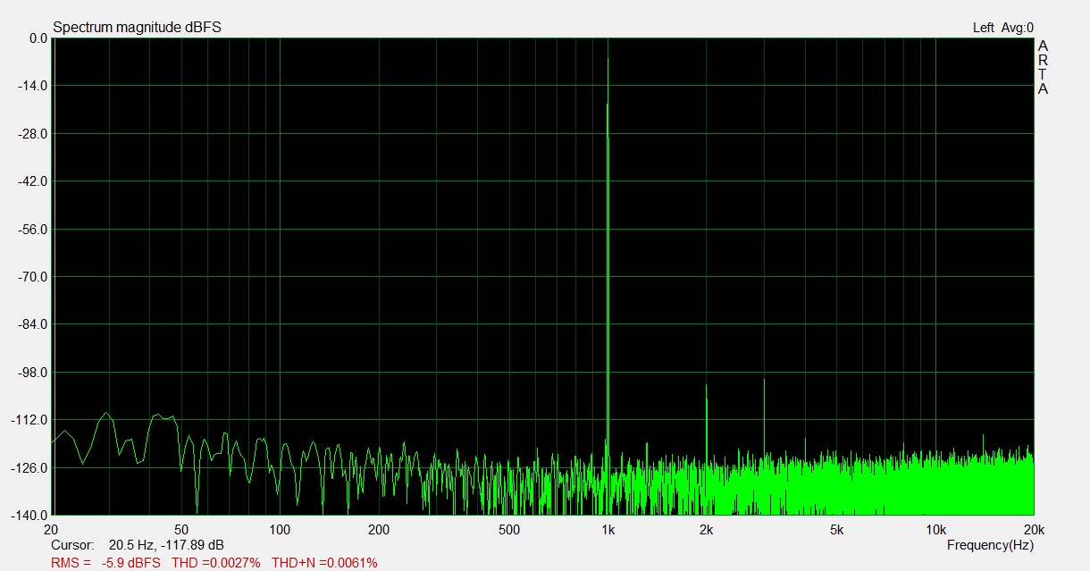

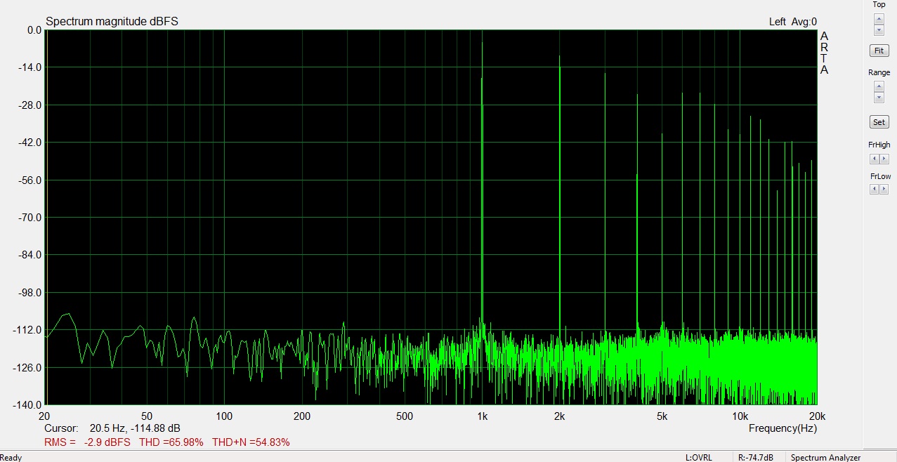

The first picture is: Loop back test of just the sound card.
The second picture is: Loop back test of both the sound card and the interface.
I thought the THD on just the sound card was not bad. But the THD of both is horrible.
Do you suppose I damaged U1 or some other component?
Thanks SY.
When I set up the loop back test for just the sound card. I started the sweep and then adjusted the volume control until the 1Khz peak was near 0dbFS.
When I set up the test for both, I adjusted the 1khz peak the same. If I reduced the peak down to lets say -80dbFS the THD went down to about .1%
What should the 1khz peak be set at?
Depends on the soundcard- gain structure is a bit of an art. 😀 If you have to reduce things to -80dB, you either have an issue with the interface or the interface sensitivity is too high. There's a range switch- try setting it to 20V and the soundcard output to 100%.
