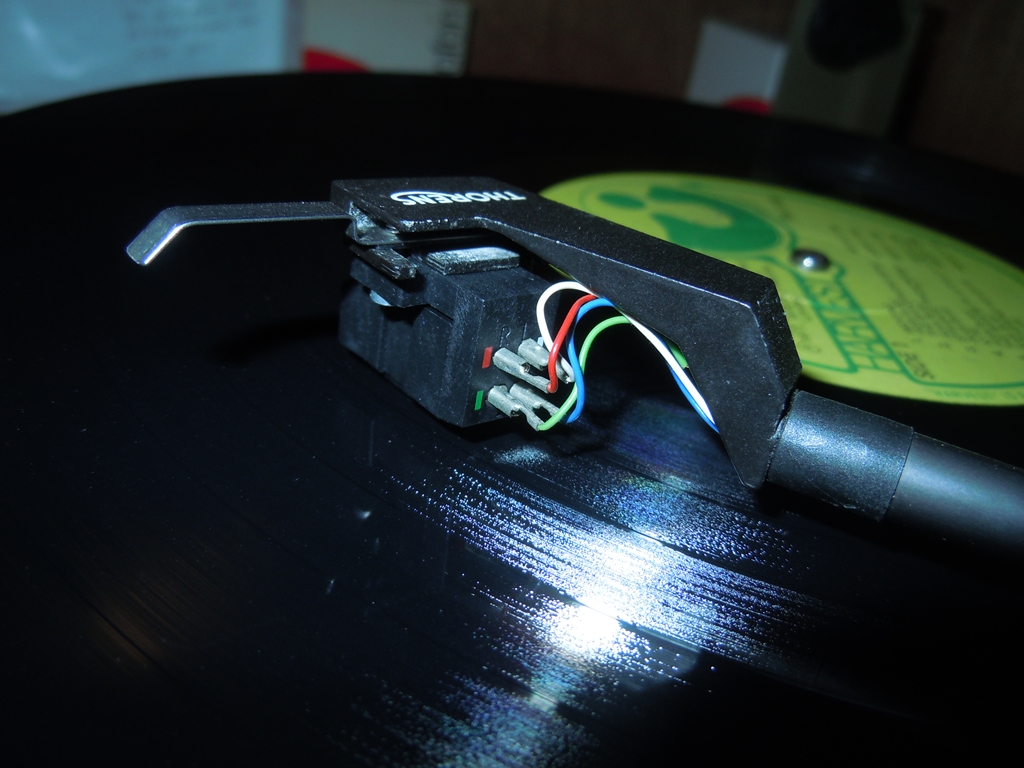

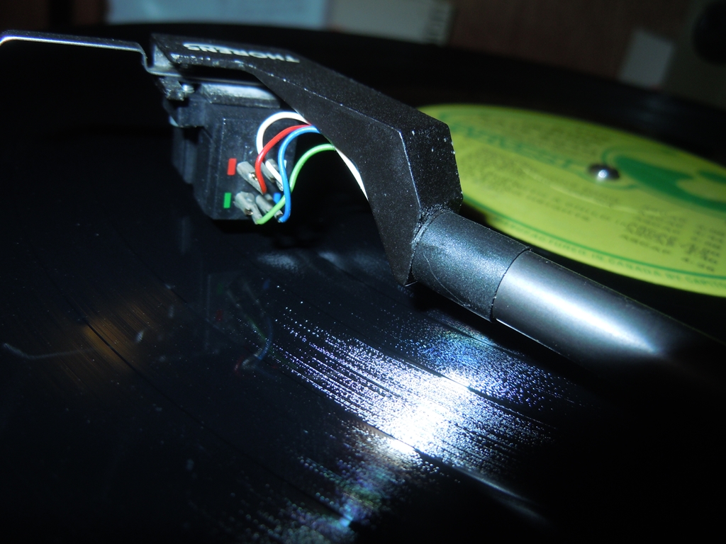

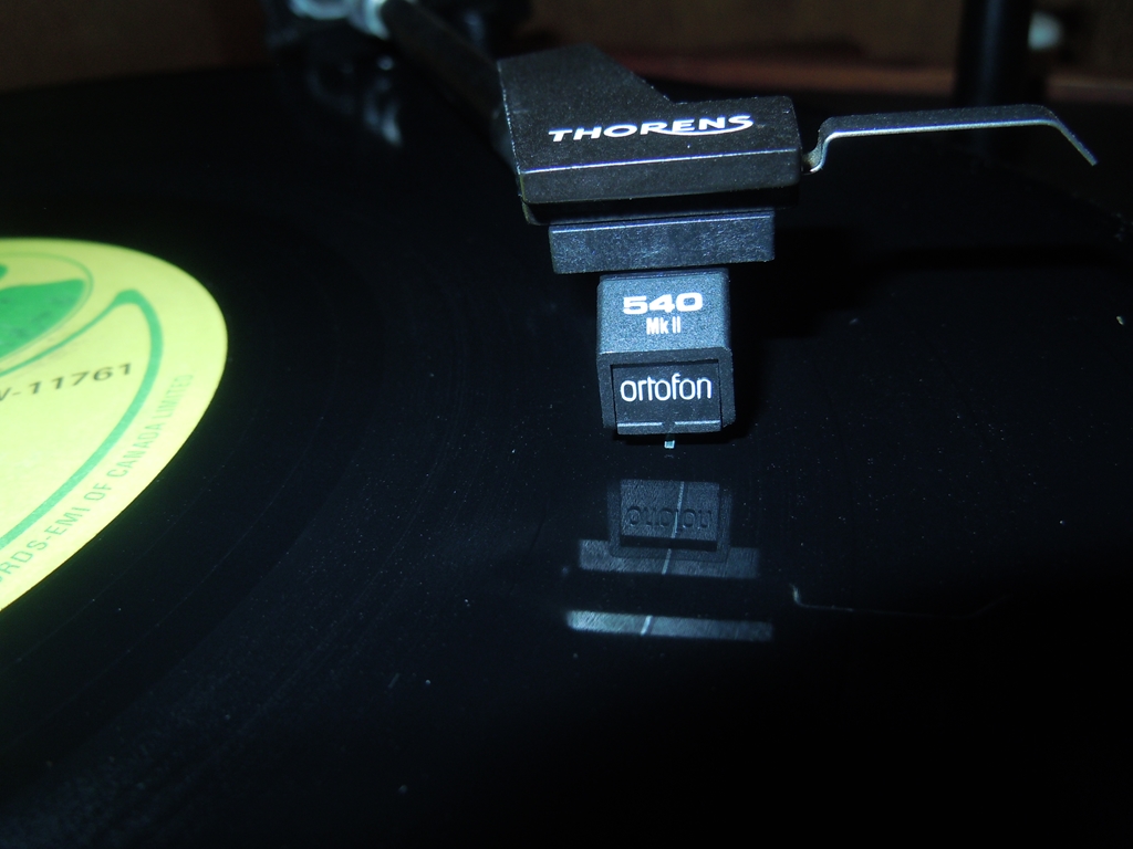

Hi spaceistheplace,
I have taken a few pictures of my setup playing an LP from different angles at high resolution that you're welcome to use. Not as dramatic of those that were posted, but the reflection of the cartridge in the record is cool. I think these are 10 MEG files. Let's see if I can resize a few and post them ...
Hopefully you now can see some thumbnails at 1024 x 768. If you are interested, I can send you the full size file at 4.25 MB each.
