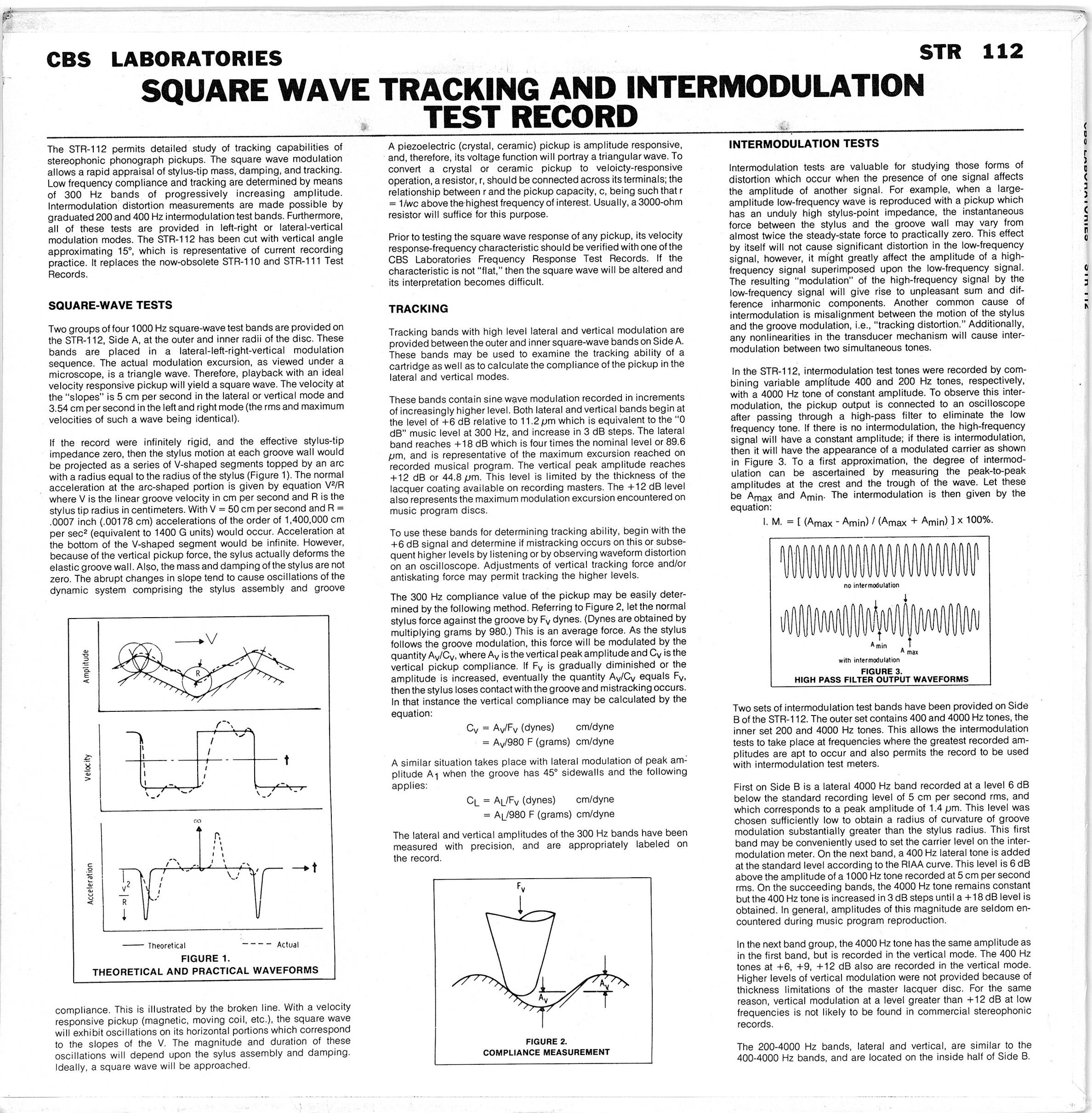

The purpose is to end up with triangular shaped grooves. The straight sections are constant stylus velocity, and good for analysing both trackability and tracing/generator linearity. The apexes are constant stylus acceleration, and good for analysing trackability/traceability as well as stylus profile performance as well as wear (in principle), and programme material slew rate performance.
Magnetic cartridges are stylus velocity sensitive. So playback of a triangle shaped groove shape produces square wave cartridge output. Top/bottom flats represent constant stylus velocity part of the (angled) straight triangular groove shapes, and rise time represents stylus acceleration, the triangle apexes. So one can simply analyse playback cartridge output squarewave and assess performance of key cartridge and stylus parameters.
So test tracks with graded triangular angles and apex curvature in physical groove shape are needed. Not a triangle wave in the synthesised audio test file. The audio has to be synthesised depending on RIAA, where the track is on the record, and our graded choice of test parameters.

This might help. It's a scan from the notes ons STR-112. We shall ignore the bit on vinyl deformation 🙂.

OK, does this mean that if inverse RIAA correction were turned off to the cutter head, a triangular waveform would not result in a triangular groove shape? What would the waveform be, in that case?

AFAIK the SRT112 is cut without RIAA and the grooves are triangles I posted a microphoto here. You do not get squarewaves unless you use a flat preamp.

With an LP dithering is moot, there are at least 6-8 LSB's (24 bit) of noise in the very best of cases so I would suggest we provide 24 bit files. The half RIAA does us no good I suspect the lower portion is insurance against gross bass excursions. The CBS non RIAA LP's all treat above and below 500Hz differently. For instance there can't be a 20 - 50k constant velocity sweep.

There's nothing to prevent us from using linear phase filtering i.e. an ideal triangle with uniformly curved apex would produce a square wave with "s" shaped edges and gaussian shaped derivatives. The argument in the STR112 notes is based on a perfect triwave with abrupt discontinuities hence my confusion on how the G's come into it. This would be a tool that does not exist.
In the PDF that Lucky attached in post #727 the formulas for finding G force are given.
Making a triangle wave like that should not be too difficult.
Still not sure how these would be analyzed, what we would look for in the waveforms.
Well in that very post he already wrote that the waveform would be a rectangle.....in order to get a triangle groove.
of couse, it has to be bandwith limited to ?? and passed through RIAA.
