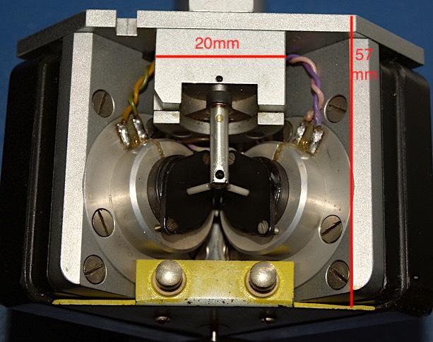

Question out of the blue...
What is the distance, or equivalent distance, between the cutterhead stylus and the fulcrum point that the cutter stylus pivots about? Is the motion of the cutter stylus in a plane defined by the VTA, or is it an arc whose curvature is defined by a cutter stylus "shaft length"? If the latter, then how concerned should we be about the tracing distortion created by the curvature of the playback stylus arc not matching the the curvature of the cutter stylus arc? IOW, does the playback stylus shaft length need to match the cutter sylus shaft length for minimum tracing distortion?
Ray K
Ray K

I get all of that but you're missing the gist of my question.
Ray K
No, didn't miss it - just saying that the cutterhead documentation I've seen does not address that, just the angle of the cut.

I guess "we" don't but maybe someone does. It's worth researching.So the answer is "we don't know"?
Here is something I found, tho it's not what you are asking it might help.
I have always assumed, perhaps mistakenly that all that mattered was the angle of the cut at the precise point where the cut was occurring. I don't know how many cutting geometries there are and how the geometry of the cutter stylus itself would impact this. (I have been lead to believe it is not all that similar in some respects to the geometry of the styli we use for playback, it is a chisel after all.)
Practically speaking we don't have control over these parameters either in disk mastering or playback. We don't control what happens at the cutter and no one here probably has remotely similar playback hardware (arms and cartridges).
