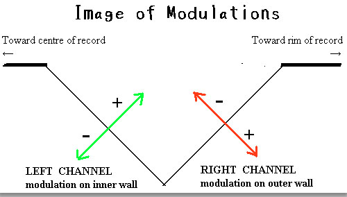

Thus your incorrect VTA seems to be doing something bad to the reading of the outside wall.
Yes, that's definitely the convention as set out in NAB recording specs 1964. Stylus motion parallel to the plane of the inner wall encodes the right channel.
So a stylus mistracing/mistracking by riding up the inner groove wall incurs errors in the right channel. It's common for mistracking/mistracing to happen on the right channel preferentially. But when all is optimal it should be balanced.

The Left channel is on the inside wall of the groove, toward the label. Thus your incorrect VTA seems to be doing something bad to the reading of the outside wall.
Thanks, that's what I found also.
In the cable spaghetti I had interchanged L and R to my sound card, so in fact it is the L channel, being the inside wall of the groove, that is causing trouble with an incorrect VTA setting.

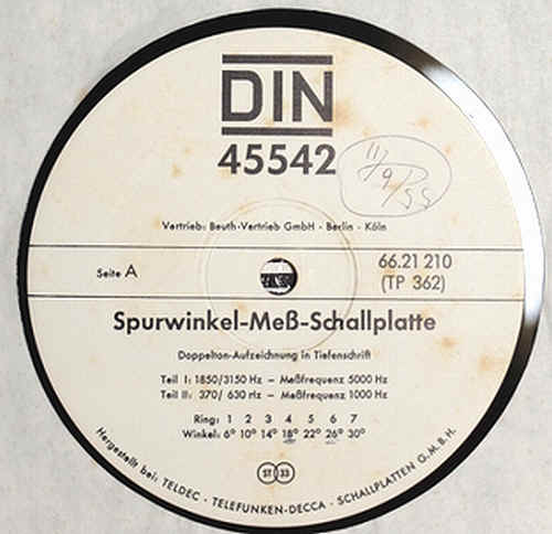

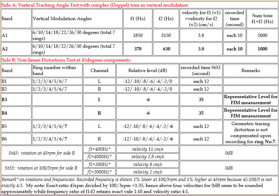

While searching the Internet, I came across this very intersting LP from Beuth, pressed by Teldec.
On Side A it has dual tone recordings cut with VTA's from 6 to 20 degrees in 4 degrees steps. That would be nice as a feature on the envisaged Test LP.
I wonder if anybody on this forum has acces to this very LP to produce .wav files with various types of needle tips.
Without altering anything to the TT setup, it could answer many questions.
Hans
That is in accordance with the drawing in posting #487.
So a stylus mistracing/mistracking by riding up the inner groove wall incurs errors in the right channel. It's common for mistracking/mistracing to happen on the right channel preferentially. But when all is optimal it should be balanced.LD
I suppose that "right channel" is a typo and should be "left channel".
The scope for confusion has counfounded people for decades, so why not us too ?😉
The outer groove wall contains right side channel modulation. So errors which cause the stylus to ride up the inner groove wall affect the right side channel.
It's normal, in an offset arm, for mistracking/mistracing to favour the right side channel first because of the line of applied force. In your case Hans, with a linear arm, this preference isn't necessarily the same and either is possible.
I shouldn't worry, the principle is the thing at issue here rather than absolute assignments.
