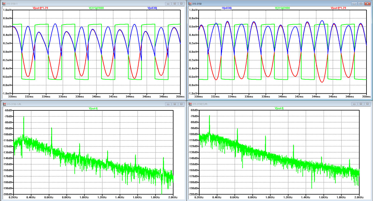

I removed the previous version. This one is correct.
Again same as above in the High setting, but now for the optimal VTA setting.
The weirdest thing to my opinion in the high setting is that the phase of the demodulated right signal has a phase shift of 90 degrees ?
Hans
Hans

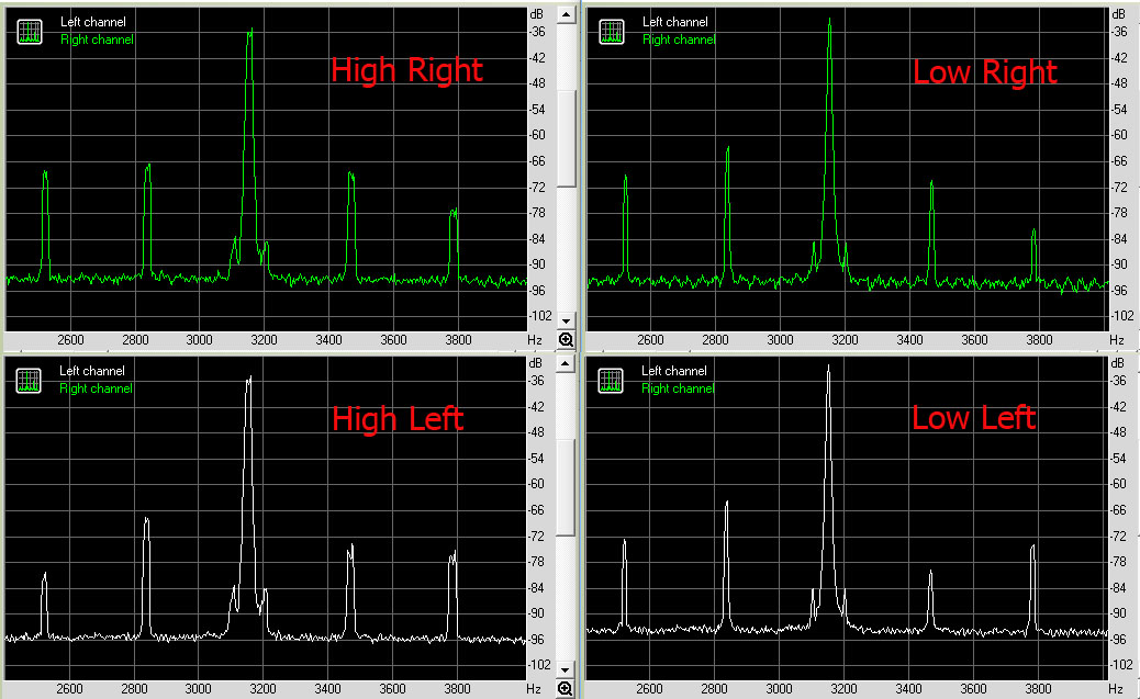

The image below shows the magnified spectrum around 3150Hz of the signal as recorded directly from the LP with a filter bandwidth of 2.7 Hz.
Left is again VTA High and right the optimal VTA.
Quite remarkable is that in the low position the main lobe and also the sidebands 1x(+/-315Hz) and 2x(+/-315Hz) are almost concentrated in one filter bin, whereas in the High position these lobes are smeared over more than one filter bin.
This is true as well for the left and for the right channel, so it is not an explanation why the FM demodulated signal from the right channel in the high position is behaving so weird.
If this smearing is the result of friction, it's fine to me, but I do not understand the mechanism behind.
Making the lobes as narrow as possible seems almost like a good method to adjust the VTA.

The importance of VTA tuning seems to depend on the type of Stylus in use.
With my 3x60 um stylus having a long Contact Line with the groove, a VTA change of 1 degrees already showed rubbish for one channel in the FM demodulated signal, where a conical stylus could hardly make a difference.
Hans
Hans

The elephant in the room is that such alignment changes can't induce enough geometric harmonic distortion per se to be audible in programme material, and certainly not enough to bring about such profound audible changes. Example and sources already quoted on this thread. So another explanation is needed to explain what can be plainly audible and measurable to an extent way beyond the common-wisdom geometric explanation.
My thesis is that the cause is altered presentation angle of stylus-groove interface mechanics: specifically altered friction interface. And altered tracing/tracking is the consequential mechanism: stylus more closely follows locus of the groove base with lower friction.
Similar profound audible changes correlate with other ways of altering stylus-groove friction, IME.
Equally at issue are other axis angles, such as lateral offset angle, and azimuth. Pragmatically, a test record that can help align a stylus for minimal harmonic distortion of sidebands we are discussing here could provide a great way of finding the 'sweet spot' of alignment that can be so audibly important for fine line styli.
LD
The patent briefly touches on the quadrature nature of mistracing versus geometric FM, arising because the point on the 300Hz wave at which the locus of the stylus deviates from 'ideal' is different. Also, geometric distortion should arise in both channels..........The weirdest thing to my opinion in the high setting is that the phase of the demodulated right signal has a phase shift of 90 degrees ?
Thesis is that smearing arises due to increase in random headshell motion consequential to increase in random stylus-groove friction stimulus. FM scrubbing. I don't know a better explanation, and it sure is otherwise odd......If this smearing is the result of friction, it's fine to me, but I do not understand the mechanism behind.
Maybe there's some support for this in the lf spectrum of the demodulated signals ?
LD
That's probably the most important reason why I called it weird.The patent briefly touches on the quadrature nature of mistracing versus geometric FM, arising because the point on the 300Hz wave at which the locus of the stylus deviates from 'ideal' is different. Also, geometric distortion should arise in both channels..........
LD
As you can see in posting #459 it occurs at this changed VTA setting only in one of the two channels.
The other channel is still behaving perfectly.
In posting #461 with the "correct" VTA setting both channels are O.K.
I don't know whether right or left is defined to be on the inner circle of the groove. But it could very well be that the more sensitive channel to VTA changes happens to be on that inner circle.
I already experimented with the lateral angle with no change, and the Azimuth also seems to be perfectly adjusted.
So the only remaining parameter left is the adjustment of the overhang which should be zero for a tangential arm.
And raising the arm from its horizontal position to change VTA, will also alter the overhang, not much but anyhow !
Hans
