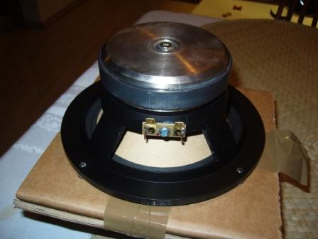

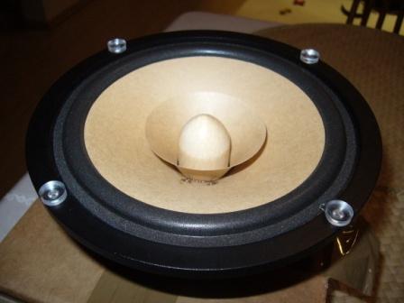

Just recieved a package from Sonido. Those are to be BIBuilt in January. Build quality seems to be ok however the wires from coil to cable connectors are cold soldered, easy to fix but...
The surround is made of foam which are not so long lasting though I've yet to find sound differences compared to other solutions.
The diaphragm is made of brownish paper with some bigger fragments spread here and there. Whizzers seems to be different with a darker tone of brown.
Basket made of cast alu which have a quite rough surface on backside though front is better. Does not bother me but others might be.
Just hope the parameters will correspond. They are hand built so variations could occur.
And no I haven't got time to connect them as they are, without boxes. Maybe tomorrow.

Forgot to mention that phase plugs are made of beech. They cost about 95 Euro/piece. I really don't know as I get some more "things" by post. I had a friend to buy them in Hungary and he is not so into hifi stuff. He could not tell what more is included.

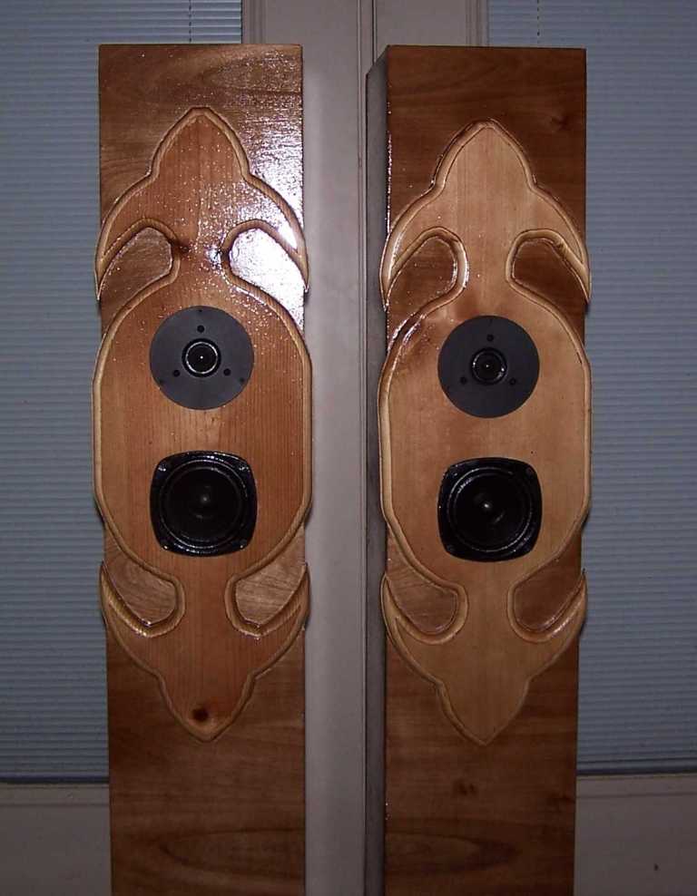

Well, here are my first BIB's. I have gone a bit of a different route on these. Due to terrible room acoustics and the fact that these may migrate to the theater room, I have added a tweeter. The driver is a Pioneer A11EC80-02F 4.5". I got these for a good deal and wanted to use them. I also had a pair of Dayton DC28FS-8 1 1/8" silk dome tweeters laying around. I coated the pioneer with 2 coats of Damar. This tamed it's wild HF and improved their looks. I used the Fostex 126/127e model for the BIB since the 126 was the closest match to the driver used. The wood is 3/4 birch laminate ply. The front baffle is made from some leftover pine 1x12's I had laying around. So far, I am very impressed and satisfied with their sound. They have overcome the room acoustics, and fill it with clear sound. I have not noticed them lacking, or having too much thar a little EQ tweaking can not take care of. I do say this after a few tweaks on the tweeter x-over. I realize this setup somewhat defeats a full range BIB, but, for the mild cost of $125 that was spent on the pair, I think I will keep them. Thanks for all the help guys! Here is a pic.
Nice Job! I don't think there is anything about the BIB that philisophically limits it to a fullrange driver. If I were building a regular old 2 way, I'd strongly consider using a BIB cab. I'd imagine it would extract quite a bit more performance from many 5.5-6.5" woofers.
