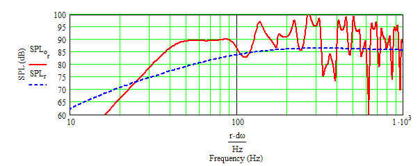

Kensai said:Could make the front chamber for the FE87 just deep enough to clear the basket.............
Greets!
There's no need to 'hunt' for space savings, the Dayton only needs a ~6" diameter (~28.274"^2) terminus, though due to its low Fs it 'wants' a longer pipe, but you say you don't have the room. Here's the sim using the 'stock' ~138" long pathlength:
GM
