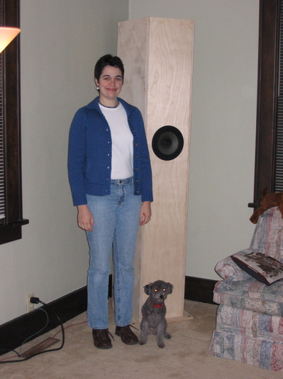

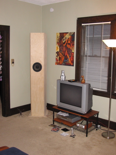

Pics, as promised.
pj

Those things are beautiful
