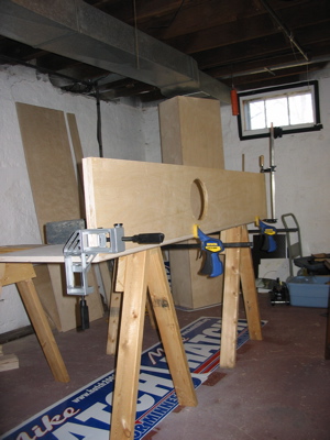

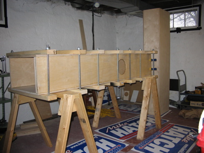

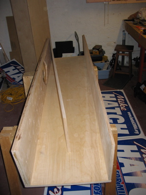

The biggest problem thus far has been my warped double thick front baffle. I decided to laminate them first, and I cut the inside baffle with an eye shaped recess, thinking it might eliminate some resonances from a round hole. I think the larger hole in general, but especially this, bowed the baffles considerably. Most of my panels a bit warped, but my construction process made that fairly easy to deal with.
The enclosure in the back of the first pic isn't glued up yet, just screwed together. I can't unclamp the first until tonight, then I'll get the second glued. I still have to complete the bases and decide how I'll attach them. I'll also need to get the cables and stuffing in them. I'm going to listen to them for awhile before I decide to finish them. I'll probably use some color of duratex. I may put some decoration/stiffening panels on the sides, and possibly a supra baffle. I may wait for warm weather so I can do it outside.

Thanks James! The old signs are really comfy to lay on; far softer and warmer than the floor, more durable than cardboard. Glue doesn't stick to them. Since they are slick, I can rock a speaker off the saw horses and drag it around on them. I can pick the cabs up, but I know I shouldn't.

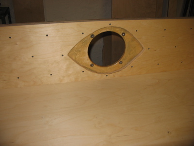

Hi everyone,
I've finished sawing my cabinets, and my drivers [Fostex 168's] are on their way.
But before I cut holes for them I need to clear something up. Scott, you originally gave
Zdriver as 30.25" for the 140" line length version, which is ~21.7% as GM said.
But when responding to a question from Samue Jayaraj you tweaked it to 29.25".
How come?

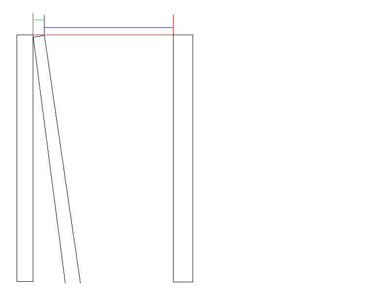

Thus the shorter one (front) = sqrt(Sm/1.4142), and the longer one (side) is 1.4142 times the shorter one. (14 and 19.8 in my case, thus).Scottmoose said:ITo preserve the conical profile (i.e. the flare-rate) with parallel walls requires specific WxD dimensions; a ratio of 1:1.4142 at the terminus in this case, as pointed out by GM.
Depending on how one mountes the internal baffle, should one add its thickness to the length of the sides? (Red vs. blue in the drawing)
(The diff. between the actual board thickness and its 'coupe' at the required angle can be neglected... 5 degrees, 1/cos(5) = 1.0038 )
Regrards, Bibster

Slight variations away from what's notionally optimal can sometimes yeild interesting results. For Samuel, I tweaked it to suit his own conditions. There's not a huge amount in it though. Generally, I'd stick to the ~optimal -the 21.7% GM identified.

Dims are internal & given for the terminus. So yes -you'd need to add the thickness of the internal baffle to the final size. So, external dimensions, assuming 3/4in material will be 1 1/2in wider and 2 1/4in deeper than the internal sizes.
