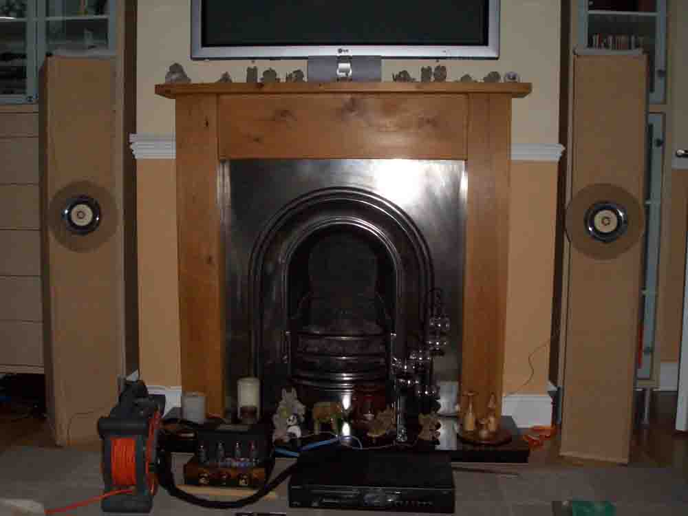

108's with bass!
I built a set of FE126 (more bass variant) yesterday to try to help me to narrow down a niggle I've been having with another build (upper-mid stridency, cabinet or driver?)
Very rough, but three hours from start to playing can't be bad! (with a little help from the B&Q big wizzy saw! - BTW if there are any English Midlands readers here who have been finding 13-ply tough to get hold of, B&Q Tipton had a pallet delivered to them by mistake over the weekend - it was still there today, they'll sell it to you at ~£30 for an 8*4 sheet, and of couse can cut it for you - if only I'd had the cash to spare. )
End result, same stridency (female vocals, clarinet, marimbas, etc hit something that makes me wince).
I then tried a pair of 108's that I have. A little shouty and a bit thin compared with the 126's, but not bad, considering at this stage there was no damping.
Next, damping in all the usual places, back in with the 108's, along with the mini-horn inspired by a thread a few months back to boost the 1K band.
Oo-er! A distinct lack of shout, and a downright disgusting amount of tunefull bass (ok not exactly Balrog country, but still meaty! - they have a fair stab at the organ whoomph at the end of 'Mars' from the Planets Suite)
Upper bass is light as you'd expect from this tuning, but not ludicrously so.
The long and short is I still don't know if the damping helps the 126's, because I can't make myself swap the drivers back!
