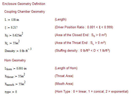

Sorry I've been absent for a few days guys -work's taken up a bit of time recently.
As per a request for the neophone, here's one.
Line length 128in.
Zdriver 25.75in
Sm (or Sl if you are so inclined) 55in^2.
I'd like to think this driver is a good one, though I doubt we'll know until someone gives it a whirl. Expensive risk. The specs are nice though, which is a good start.
Cheers
Scott
PS, Greg -how are you doing it in the BLH sheet? I'm assuming set a tapered CC from So to the driver centre point, and the throat as the same area as the driver end?
S.

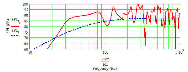

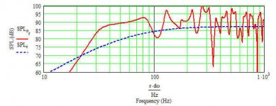

FWIW, on 5.21.06 I simmed it in T.C.'s 'stock' BIB using these specs and got this, though I have no idea how accurate they are:
GM
GM
peterbrorsson said:PS, Greg -how are you doing it in the BLH sheet? I'm assuming set a tapered CC from So to the driver centre point, and the throat as the same area as the driver end?
Greets!
$@#! I posted this in a much earlier response to Scott and others, but apparently didn't save the link.
But wait! A picture is worth a 1000 words, so courtesy of SnagIt demo.........
GM
