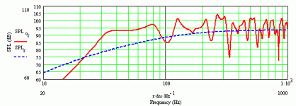

Coming back to page 17 of this thread you were kind enough to sim the FE164 to my request but I was wondering if after all the experience accumulated during this time the sims for this driver still stand or some other refinement to the model were made that could show other dimensions.
In the other hand, before committing a lot of lumber to this driver could we run a graphic simulating the response of these two alternatives? I have doubts if this is a good driver to start with or maybe I should order some other for better results like the FF165 or 225 you have mention.
FE164 parameters as published by Fostex are;
Fs 50 Hz
Qts 0.31
Qms 4.0
Qes 0.34
Vas 32.2 L
Xmax 1.0 mm
:xmastree: :xmastree: :xmastree: :santa2:
Nothing wrong with the FE164. Could perhaps do with the wizzer chopping down a bit, or, better, a pair of Dave's phase plugs.
Actually, I gather the Fostex Fs is a bit optimistic -it's closer to being 58Hz. However, forget the early stuff. This should be all you'll ever need.
Line = 140in
Zdriver = 30.5in
Sl = 125.875in^2 (9.5in wide x 13.25in deep internal, not including baffle).
