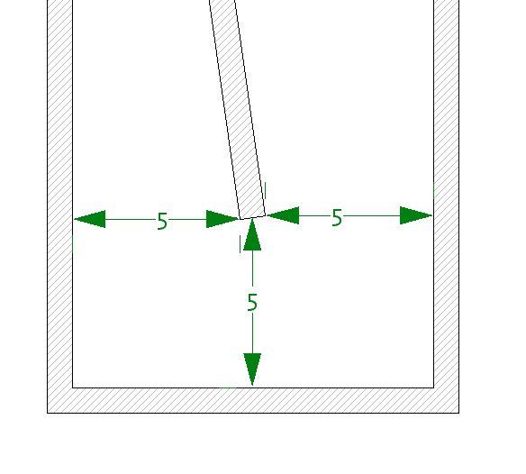

Reduce the line length to 140in if you like, and Zdriver to 30.5in. You'll loose about 5Hz of extension at the bottom end, but the cabinet is more managable. Listening to a driver like the 206 off-axis is actually not such a bad thing as it helps reduce the apparant rise in the response.
bibster said:
Thus the shorter one (front) = sqrt(Sm/1.4142), and the longer one (side) is 1.4142 times the shorter one. (14 and 19.8 in my case, thus).
Depending on how one mountes the internal baffle, should one add its thickness to the length of the sides? (Red vs. blue in the drawing)
(The diff. between the actual board thickness and its 'coupe' at the required angle can be neglected... 5 degrees, 1/cos(5) = 1.0038 )
Regrards, Bibster
This is confusing me a little.
With reference to this: http://www.zillaspeak.com/bib-howtobuild.asp
Just say my required internal depth is 350mm and the baffle is 19mm thick, then this would make the actual required internal depth 369mm.
Do I use the value of 369mm to work out A, B and C?
Yes. The CSA given (& therefore what is used in calculating the WxD dimensions) is of Sl, not including the thickness of the internal baffle, which you will need to the depth.

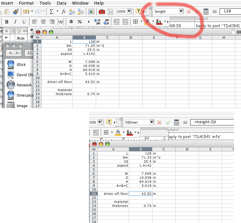

Just last night i started developing a BIB calculator... mine doesn't do exactly the same stuff (i hadn't got to the part where it generates the cut list... maybe you want to use some of mine in yours (i find excel very frustratingly limited so i'd likely not get it to do some of the things i'd like it too)....
Anyway, some more raw material.... (note: the maximums on the chart will need to be manually reset depending on the height/depth of the BIB). BTW. mine is labeled in inches, but acually in unit independent (as long as units are all the same)

Note: named cells should be used as much as possible to avoid confusion.

I'm using Excel 2004 but the functionality existed before that as far as i know....
To the left of the entry bar, is an editable field with the cell designation in it. If you type a valid name, and hit the enter key (& only the enter key) the name will stick to that entry.
It makes any formulas you do way easier to understand & debug, and is an absolute reference.

I see that your calculator takes into account the baffle width in determining the internal depth, however should the dimension C (the distance from the base to the bottom edge of the baffle) be equal to the new depth/2, i.e. taking into account the baffle width, or should it remain as being equal to the depth/2 not taking into account the baffle width?

wixy said:I see that your calculator takes into account the baffle width in determining the internal depth, however should the dimension C (the distance from the base to the bottom edge of the baffle) be equal to the new depth/2, i.e. taking into account the baffle width, or should it remain as being equal to the depth/2 not taking into account the baffle width?
How it is supposed to work (and having done it early in the morning just before crashing, not checked) is to take the raw numbers & calculate the internal dimensions assumming a zero width interior divider, then i add in the material thickness to determine actual inside depth. Then the panel thickness is added to get full dimensions.
dave
But because the inside depth has changed, then A=B which does not equal C, as stated on the bib web page. Should C be changed to equal A and B?
