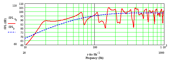

Godzilla said:
http://www.zillaspeak.com/BIB.asp
As this developes I hope it's useful. Comments are appreciated.
Godzilla
Godzilla, under the BIB site under Monacor SPH-60X
L = (Line length) 128"
So = Driver 25.5" down from sealed end of cabinet
Sm = 55"^2
is the size of the cabinet same as the original BIB by Terry Cain? I am unsure of what the L, So, Sm are. I assume these refer to figure on the speaker itself and not the cabinet?
thanks,
gychang
