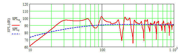

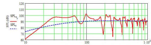

Quick question for any of the BIB experts. If a person had two Lab-12's and was getting cold feet on the woodworking required for the PSW LabSub, could a BIB be anything CLOSE to a reasonable sized unit???? BTW very slowly adding finish to the TangBand BIBs. (I like them for listening too much to make time to add the finish, LOL) P.S. I added a piezo tweeter to mine and I really like the added zing up top.
Re: Just a hypothetical....maybe
I guess they would not be much bigger than a couple of family sized regifrigerators 😀
I see there is a thread "BBBIB Bigger Badder BIB Speaker" in the "conventional" Loudspeaker section.
SveinB.
Greets!
Sorry, I can't decide what you're asking. If you mean how big does a BIB have to be to ~match a LAB sub's output or its distortion level, it won't no matter how big you make it. If you mean how well will it work if turned into a BIB except loaded with its compression chamber, it will be more rolled off on the bottom end and have more HF BW to filter out, so for a given hF10/whatever, it will need a steeper XO point. If you mean what size would a LAB12 BIB be, then assuming a ~80 Hz XO point:
L = 180"
Sm = 220"^2 (recommend 12.4375" W x 17.687" D)
zdriver = 39.06"
Once EQ'd ~flat in-room, a pair of corners loaded with these will probably make you wonder why you even considered all that fancy woodworking for a HIFI/HT app. Note too that since this is a sub, there's no need to stand it up vertically, so they can be laid down along the front wall firing into the corner(s)/diagonally opposite corners/whatever.
FWIW, the various pipe 'subs' I did for folks were often used as speaker/TV platforms or placed behind the listening position to do shelf duty or be hidden if the distance was about right to time align at the XO point. For HT it can be a stage or seat riser and I've read some folks use them as bed platforms for bedroom systems. And of course you can put both drivers in one BIB by increasing the width/depth dims to 17.625" W x 24.9375" D, or fold it into thirds to make it more LABhorn shaped.
Since these are fairly efficient and can handle all its rated power down to at least 20 Hz, these will need to be very rigid/damped, so 19 mm Baltic Birch or Apple ply laminated with a 13 mm MDF 'skin' and some ~1" hardwood dowel 'X' braces at the mouth is required. If it's to be carpeted or hidden away out of sight, you can skin it with cheaper particle, chip, or flake board or one of the sound absorbing insulation boards, which all have increasingly superior damping qualities, but more labor intensive/costly to fine finish if in full view.
Anyway, lots of shape/positioning/finishing options with BIB subs.
GM
