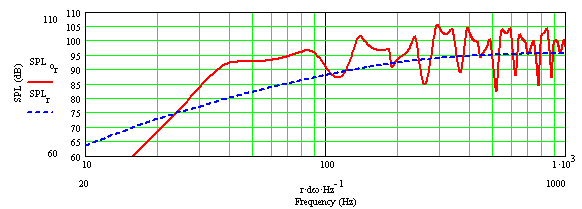

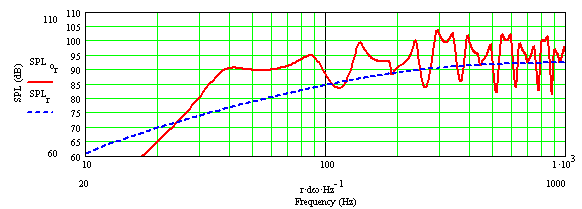

stroop said:Hi Folks!
I'm going to attempt my first DIY project, on some BIB! Read the entire thread pretty much, but, just wanted to double check and get a couple of opinions from those who know before ordering everything!
Ok here goes,
2 options to be used with T-amp:
1/ Fostex fe167e - from what i understand, it is a 'drop in' replacement for the fe164. Which is better sonically for classical, the large or the small size on zillaspeak? Also are the measurements internal or external?
2/ Monacor sph60x - how much better if at all is the fostex? Again are the measurements on the zillaspeak site internal?
3/ I am based in Germany and can get the wood cut to size at Bauhaus and was thinking of using solid beech or eucalypt that you can buy in sheets ca 30mm thick 3000mm x 600mm for about 44 euro. Its not one piece of course but long strips glued together. Its normally used for kitchen benches etc. and looks good and I don't think has any voids like some ply.
4/ I can buy felt in differing thicknesses really easy here and wool for the base. And I'll look for cork sheeting in the craft shop down the road....!
5/ Finally....Is it better to exit the cables out the side of the boxes, direct to the amp next to the speaker chassis, rather than running the cables down and out the back to binding posts? WAF factor is no problem so long as they sound good!! yes I am a lucky man....
Looking forward to any responses...yes and no is even ok!
Cheers Stroop
Hi
1) the 1267 is a lovely unit. But you've lost me about the 'large' and 'small' sizes on Zillaspeak -I've only designed the one enclosure for use with the 166, 167, and 166ES-R. You could use it in the one for the FF165K though, if that's what you mean. All dimesnions given on the 'Zilla site are internal BTW.
2) Considerably. The Monacor is a cracking driver, and loaded correctly, a real giant killer when compared to most commercial speakers under UK £800 or so, and astounding value for money, but you still get what you pay for. If you can afford the Fostex, buy it. And a pair of Dave's phase plugs for them while you're at it.
3) Sounds fine to me. Try to use particle board (chipboard or MDF) for the internal baffle, and the rear panel though, as GM suggests.
4) That's the way to do it -don't get fleeced (sorry -terrible joke) for wool or other damping compounds by audio retailers.
5) Theoretically the best conenctor is no connector at all and an unbroken run from amp to driver. That said, I always use connectors for convenience, and I can't honestly say I believe it to be a problem. If it passes a signal, then it's done it's job. Electricity isn't that fussy. You could stick the binding posts on the side if you like, near the driver, to keep the internal cable run short. I still prefer mine down low at the bottom, but as always, YMMV. We all prefer different things.
Good luck with the project -you won't regret it!
Scott

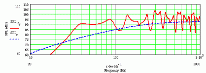

Hi Scott,
FE164 dims, small and large on post 170 pag.17 .
Received Monacor's drivers, I'm breaking-in the two couples in a rough cab and, for the record, the SPH 68X/AD seems much better in every respect to the SPH 60X.
As far as I'll finished the proper cab I'll sum-up the comparison.

Aha! Thanks for that. I knew I'd done something for the 164 at some stage. FWIW, I'd use the 167 dims on the zilla page, but these two should also work well enough.
Thanks for the gen re the 68/AD -will hav eto look into that at some point. Looks like it has a bit more at the top end. I'll look forward to your comparison.

Hi Scottmoose!
Just a quick question again.....when you say the dimensions, do you mean;
L=136in
Zdriver=27.5
Sm=87.75in square
or are there box dimensions somewhere else for fe167e that I've overlooked.
If that is the case then the line length I can understand but then mouth (Sm) needs to be alot smaller than that of the dimensions above.(8.5x14.75 = Sm125.35in square) It could be I'm a bit/alot inexperienced or am confused and trying to make calculations all wrong. If I made the boxes with the below dimensions would that be right?
H=67in
W=7in
D=12.5in
baffle ending 6.25 from the bottom and centred.
Again thanks for the info!!! I'll definately use chip board for the baffle!

That'll be the gremlins then. They haunt the electronic waves, dressed as hippos in small green furry hats, and cause untold trouble, particularly to those who frequent audio boards. True you know. Every word. By the way, custard is made from gelignite.
178 BIB.
Line 128in
Zdriver 26.5in
Sl=76.375in^2
178 BIB.
Line 128in
Zdriver 26.5in
Sl=76.375in^2
Hehe, I suppose it spells Greeemliiinsz in Hungarian.
Gee, thanks for the sims hope you haven't done it in vane, as I have to listen before Mammon speaks. But as always you are helpful and kind to do these sims for the lower class😀
Best Regards Peter
Best Regards Peter
