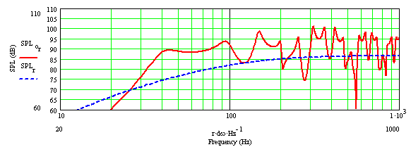

Hey Scott, if you have the time what would a bass cab (floor loaded to the rear) look like with this driver? I would like to use a tweeter above it for a tall thin two-way. Any foreseeable problems with this set-up?

It's possible to shorten it, but you'd throw most of the bass away in doing so. Fs is around 55Hz. Be a shame not to use it. 😉
