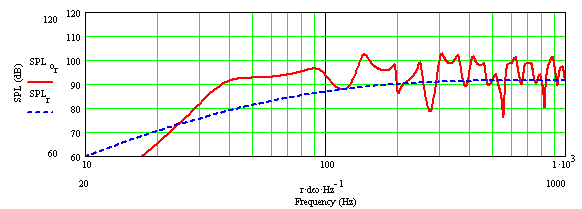

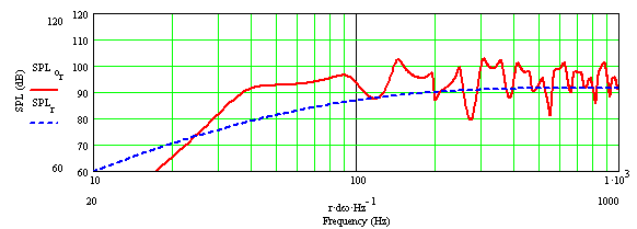

Gentlemen (and any ladies if you happen to be reading)
I've just spent some time playing with Martin's latest BLH Sections sheet, trying to determine what differences might be obtained from different flare-rates. The results are quite interesting. For most of our models, Greg & I use the ML TQWT sheet, as it's great for quick data entry. What it can't do is calculate different flares, as, if my understanding of the math is correct, simply takes the CSA of So and the CSA of Sl and calculates based upon that, not the different width / depth ratios. The TL sections sheet isn't much use here either, as it still uses CSA as a ratio of Sd area; again not much use. The BLH sections sheet does allow different WxD geometraries to be plotted however, so...
Cabinet modelled: I used the BIB Terry Cain developed in 2001 for the non 'E' model Fostex FE168Sigma as an electronic mule so to speak. I had to guess at the internal dimensions based upon the information I had available, but I'd be very surprised if I was far out.
Control simulation of the box done in ML TQWT sheet:

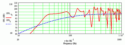

Next model: I fired up the BLH Sections sheet, and after calculating the angles & baseline (thank you, Mr. Pythagoras), I entered the data, in milimeters, to four decimal places. The WxD ratio of this cabinet is 1:3. The response is attached. Note the reduction in the ripple over that predicted in the simpler ML TQWT sheet. Flare-rates obviously count for something.
Finally, I reworked the horn, using the same length, cabinet volume and terminus area into a conical profile using the 1:1.4142 WxD ratio Greg advises. Response is attached below.
It's harder to see this time around, but the ripple in the response is once again further reduced, albeit far more slightly this time. I'd be clearer on an overlay.
Conclusion: the conical horn profile appears to be best, and offers a slight improvement in 1/2 space response over the less consistant expansions. I expect this improvement to increase in magnitude in-room.
None of this is intended to denigrate TC's cabinets I want to add. Quite the reverse -I bet it's a stunner. It was just an interesting example to use. Especially as I've always looked at the picture I have of it, and drooled.
I don't fancy doing this again for a while though -the data entry took forever! So no requests for any more tapers etc. just yet!
Hope you find this interesting
Scott
