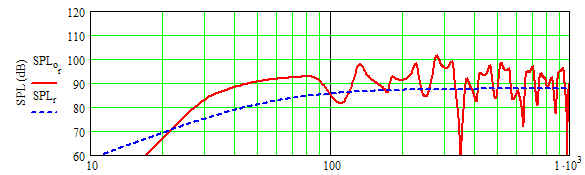

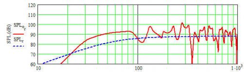

Once the different SPL scaling is accounted for, T.C.'s RS 40-1354 'BLH' sim looks 'close enough' for me:
GM

I haven't read all of the thread either, but I assume you're referring to the fact that none of MJK's freeware WSs will show the effects of the room beyond an infinite half space loading, which is all Scott has been publishing even though he has the licensed WS that allows a certain amount of room loading and floor bounce modeling.
Anyway, as you can see, the freeware BLH WS sims more than 'close enough' to his latest shareware ML-TQWT WS by inputting the BIB's design into the BLH coupling chamber fields and listing the horn length as 0.001, with St, Sm = SL, and linear flare rate.
GM
