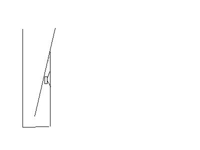

Initial Radio Shack 40-1285D BIB plans . . . .
So I drafted up GM's BIB spec's for the radio shack 40-1285D 6.5 inch, and I think it will look pretty good. I'm going to try and make a detachable speaker mounting plate on the front to allow me to swap in other drivers. I'm curious to see how some of my OEM Console speakers (6 - 8") can sound in a BIB. Take a look at the draft:
(hope the image isn't too big . . .)
I figured I can build them with only 4 4X8 sheets of good birch 3/4 inch plywood. Any suggestions or comments welcome 🙂
take two
Picture didn't load . . . take two:
<DIV align=center>
<img src="http://gallery.AudioAsylum.com/cgi/gi.mpl?u=28081&f=RATSHACKBIBS.JPG" width=800 height=534>
</DIV>

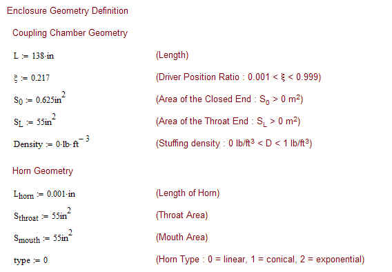

GM said:Greets!
I haven't read all of the thread either, but I assume you're referring to the fact that none of MJK's freeware WSs will show the effects of the room beyond an infinite half space loading, which is all Scott has been publishing even though he has the licensed WS that allows a certain amount of room loading and floor bounce modeling.
Anyway, as you can see, the freeware BLH WS sims more than 'close enough' to his latest shareware ML-TQWT WS by inputting the BIB's design into the BLH coupling chamber fields and listing the horn length as 0.001, with St, Sm = SL, and linear flare rate.
GM
Hi
I tried to model the BIB using MJKs shareware BLH worksheets but did not succeed. GM, as I understand your post, you suggest to model it using the coupling chamber only, with the horn set to null? I tried that, but it doesn't work at all, for me. Any suggestions?
LC
AJ-Horn would have room interaction, but is more expensive than MJK`s sheets.
http://www.aj-horn.com/indexe.htm
GM, thanks alot, now it works and I have no clue either why it wouldn't work before - I must have missed somthing.
