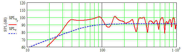

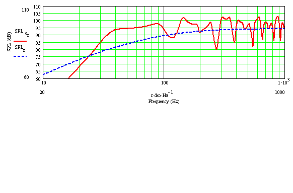

Sorry I've been absent for a few days guys -work's taken up a bit of time recently.
As per a request for the neophone, here's one.
Line length 128in.
Zdriver 25.75in
Sm (or Sl if you are so inclined) 55in^2.
I'd like to think this driver is a good one, though I doubt we'll know until someone gives it a whirl. Expensive risk. The specs are nice though, which is a good start.
Cheers
Scott
PS, Greg -how are you doing it in the BLH sheet? I'm assuming set a tapered CC from So to the driver centre point, and the throat as the same area as the driver end?
S.

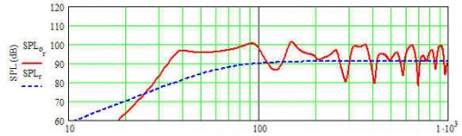

Neo-fone
50 bucks each doesn't seem that expensive to me. $134 the pair includes shipping. Thanks for doing the sim for this one I think it might be good. I have a pair coming I'll let you know. Jim G.
Fool! My apologies; I didn't see that it was the price for a pair, not singles, and inc. P&P. What's happening to my eyes? That makes it a very interesting option, and I look forward to hearing your impressions.

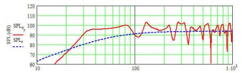

Re: yeah...
Greets!
Fs is too high for a BIB, it puts the 3rd harmonic dip up where it will be too obvious sounding, so a horn is the only suitable high gain cab IMO.
GM

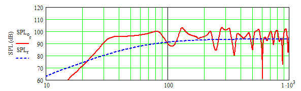

BIB question: sm for radio shack 40-1285D
It's 11:30, and I'm overtired - am I reading the mouth area correctly :
330 in ^2 ?
would that be about a foot and a half square?
must go to sleep . . .
thanks guys

Re: BIB question: sm for radio shack 40-1285D
Greets!
Sleep? What's that? - Insomniac since ~1950
Yep, correctomundo, though for the horn's expansion to be technically ~correct, you can't use a square mouth.
d1 = SQRT(330*SQRT(2)) = ~21.61"
d2 = 330/~21.61 = ~15.28"
or can be done by using the reciprocal of SQRT(2):
d2 = 1/SQRT(2)*~21.6 = ~15.28"
GM

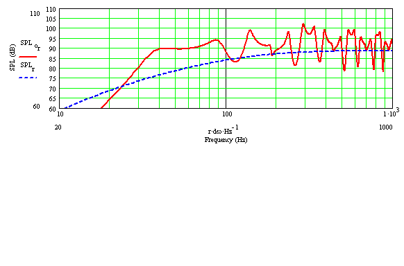

ATD Veravox 7x
Hi GM,
If possibe and time permitting... Maybe dims for the vented pole-pieced Veravox 7x? Thank you.
http://www.solen.ca./ver.htm
http://www.cantare-as.de/templates/vera_7x.html
fred

Re: ATD Veravox 7x
Greets!
'Stock' BIB except 220"^2 Sm.
GM
