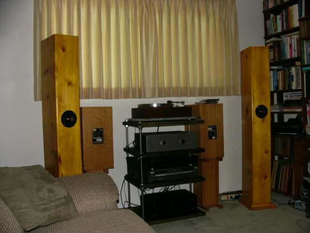

I don't have enough hours on them to consider the drivers broken in. My first impression is that they sure don't lack for bass. If anything they are too full in the 40-50 Hz range. Some (maybe all) of that is the main resonance of the den they're in, but the same was true in the living room which is much larger. I need to make some short stands for them, the drivers are well below ear level now so the top end is rolled off. On axis listening will be essential. The well-documented dip above 100 Hz is in effect, too.
So, as they sit, they are somewhat flawed. Stands will help, I expect that some bracing in the mouth will be appropriate (as I said in an earlier post, the 3/4" pine boxes are hardly dead enough to please the cabinet resonance Nazis), and I'm sure that I'll be playing with both damping and some sort of filter network (treble notch or BSC, not sure which, maybe both?).
There's good stuff happening too. I'm enjoing listening to them, colorations and all. The only full-range drivers I've ever listened to have been headphones, and in some ways the sound of these reminds me of 'phones. I never thought about headphone sound in terms of having no xovers, but now I'm thinking that is a critical aspect in the clarity of sound from headphones. The prominent bass works like loudness compensation at lower listening levels, and I kind of like it. Turn them up and throw on some reggae (I've got Dub Side of the Moon on again as I write this) and they're ready to boogie. They won't go disco party loud, but they're plenty loud enough for my needs.
It's amazing just how much music (and how much bass!) you can get out of a tiny pair of drivers. I'm going to be playing with these for a while to see what I can get out of them.
Bill
Godzilla said:
Neat... i like the bases very much. What speakers are facing backwards?
Godzilla
Paradigm Control Monitors, late '80's vintage. The stands they are on are probably the nicest woodwork I've ever done. The rails and stiles are solid 5/4 oak, with mortise and tenon joints in all directions. I used a table saw to help with the tenons, but cut all the mortises with mallet and chisel. The panels are 3/4" ply veneered in ribbon cut white oak. They're sand filled and solid as all get out. I built them when I was recently divorced, dateless and looking to fill up some hours between parenting duties. I won't have that kind of time again until I retire.
