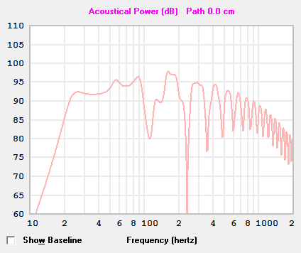

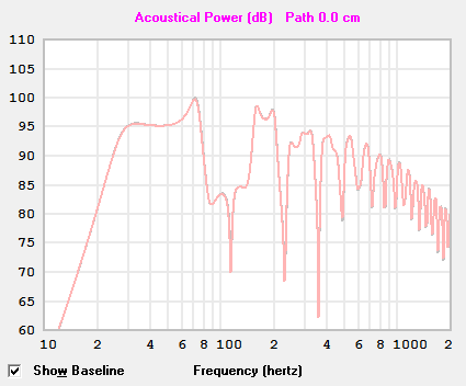

TB W69-1042J BIB 0.42 offset 4 ohms Rg/1pi
TB W69-1042J BIB 0.21 offset 4 ohms Rg/1pi
Minimal damping from the top down to just past the bottom of the driver; not too shabby for a ~8" dia. frame (Sd = 225 cm^2 calculated based on published specs)
Reactions: rjbond3rd
