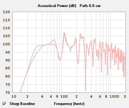

We can sim a floor loaded BIB in Hornresp to get a frequency response approximation, but you'll need to measure your build in room with REW or similar to tweak/EQ each channel.

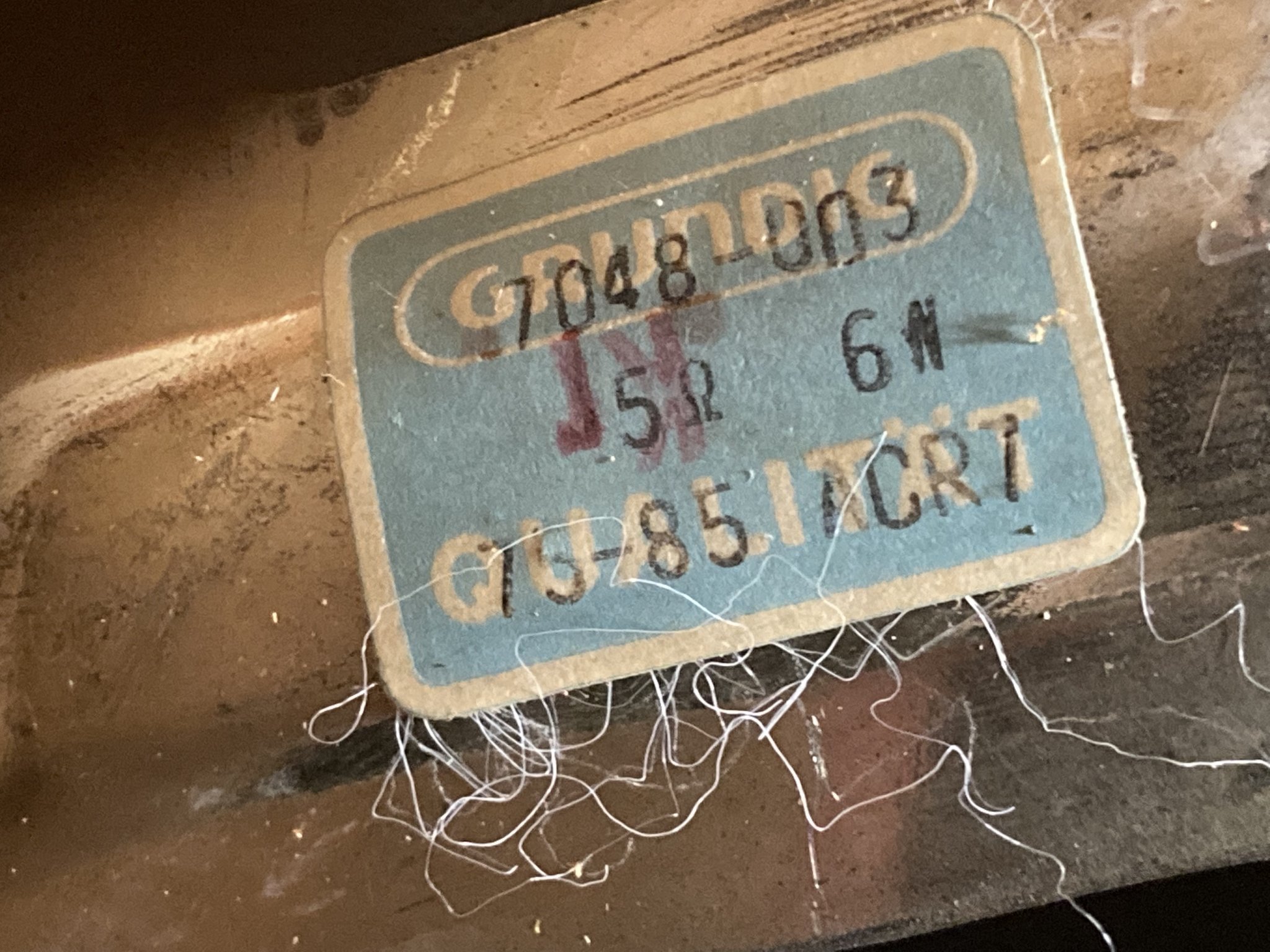

The question about re-winding was the aforementioned Grundig floor speakers, my friend and I were not aware they are rated to 6 watts and the amplifier is 70 watts. They were meant to be used for a console, however, some dense heathen cut the legs off and switched the connectors to the bare wire type. They sound absolutely amazing for a vintage speaker so small (14cmx21cm) and like to get them working again, drive them with an about eight watt amplifier.
