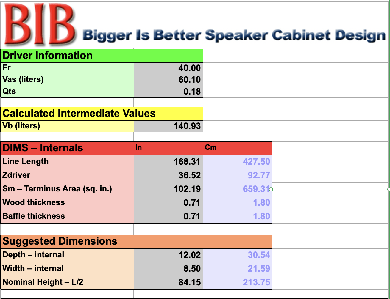

I do have the BIB calculator, however, I have not found any information on how to choose Fr and the affect on BW, especially bass and mid base. As I understand, vinyl does not go below 20Hz, so there is no benefit to a BIB boosting frequency below this point. Correct?

@Scottmoose , yes, I have the BIB calculator and ran it yesterday evening. My frustration is after nine days or so of searching, I have not found one shred of information regarding Fr.
Additionally, I was concerned about the bass and mid bass outputs, I am understanding a BIB is unable to reach to 20Hz.
Now if the only way to achieve production of bass to the limit of vinyl pressing is to have subwoofers, then guess have to sell the dining table and chairs (the two arm chairs or wedged into a bedroom closet) to make room and create a much better layout.

As for the values, assuming a Fr of 40Hz:

I didn't look for the 'Fr', just wanted the cab dims to calculate it 'close enough'. Anyway, just now remembered it was for my 'el cheapo' all time fave, the RadioShack 40-1354, so went through some old files just now and found his archived write up.
Yeah, I write offline, then copy/paste and still often manage to miss enough spelling/grammar to require edits.
Re 'Fr', et al, here's a math example we used before making the calculator.
I'm out of date, but historically no vinyl went below ~32 Hz, only special effects RTR tapes, though BIB of course can be tuned much lower if one has the space/budget.
As I previously noted, T/S theory covers a driver's gain BW, so the rest of its BW response is governed by its inductance, acoustic loading.
Re low Qt, 0.5 ohms........ it's just a default and for BIB apps the driver's Qt needs to be pretty high for a typical ceiling height, so significant series resistance such as a matching impedance tube amp or an adjustable pot and/or electronic EQ might be required with low Qt drivers for a flat response if there's not enough room boundary gain.
Re Fs*2^octave bandwidth......exactly what I posted; yes in that example.
Re two ways of obtaining different values for Qts'? ???? Please elaborate because TTBOMK there's only the one way to factor in series resistance.
