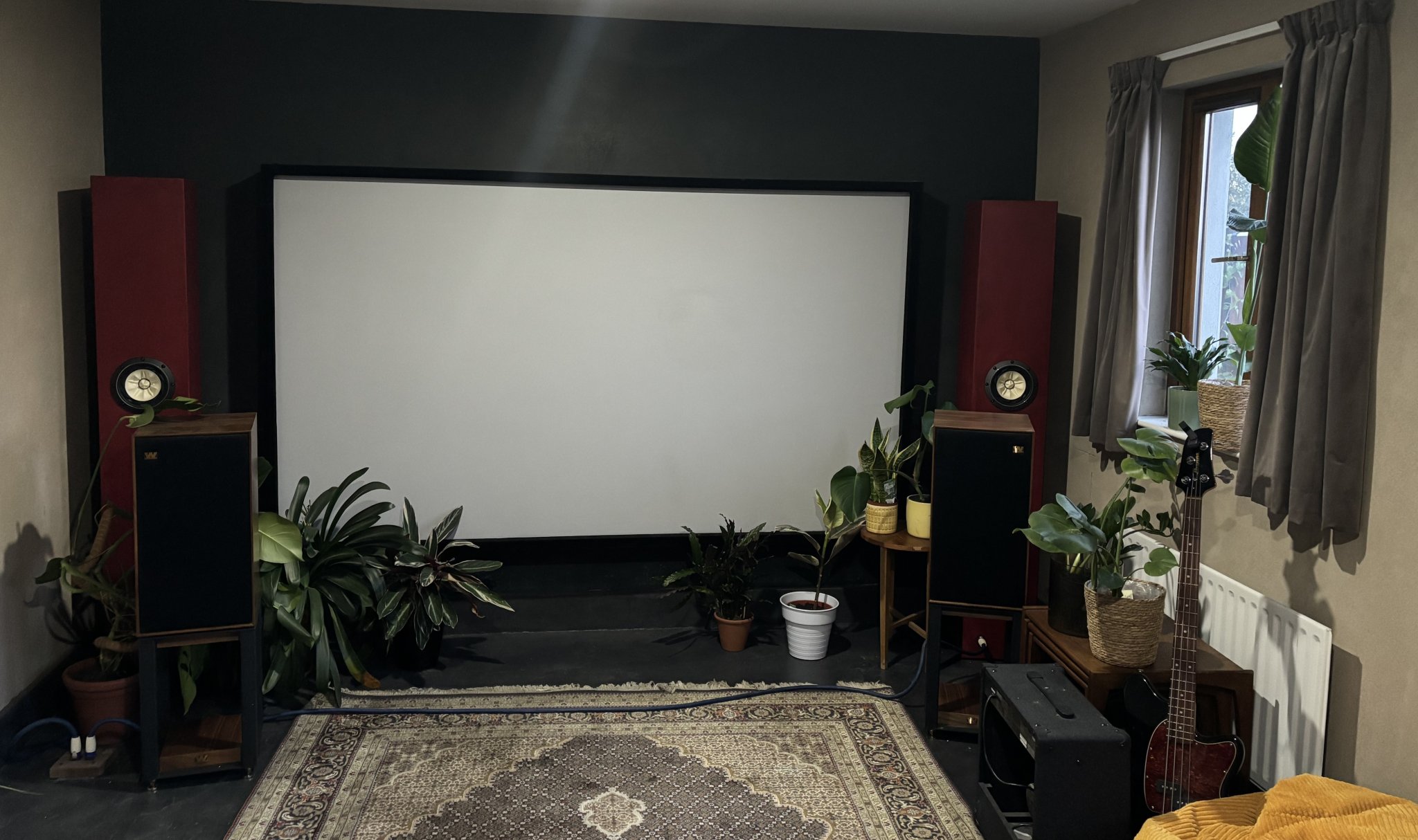

Meanwhile, my tangband W69-1042 bib is hard to judge. It is running up to 200Hz. When I switch off its amp, a huge chunk of the sound is missing, it is doing a lot. Yet when it is turned on, you'd never guess there was a separate bass system or crossover in the system. It is a very fine and subtle device in that regard. And it alleviates the "satellites" of a lot of work and that is very audible as well.

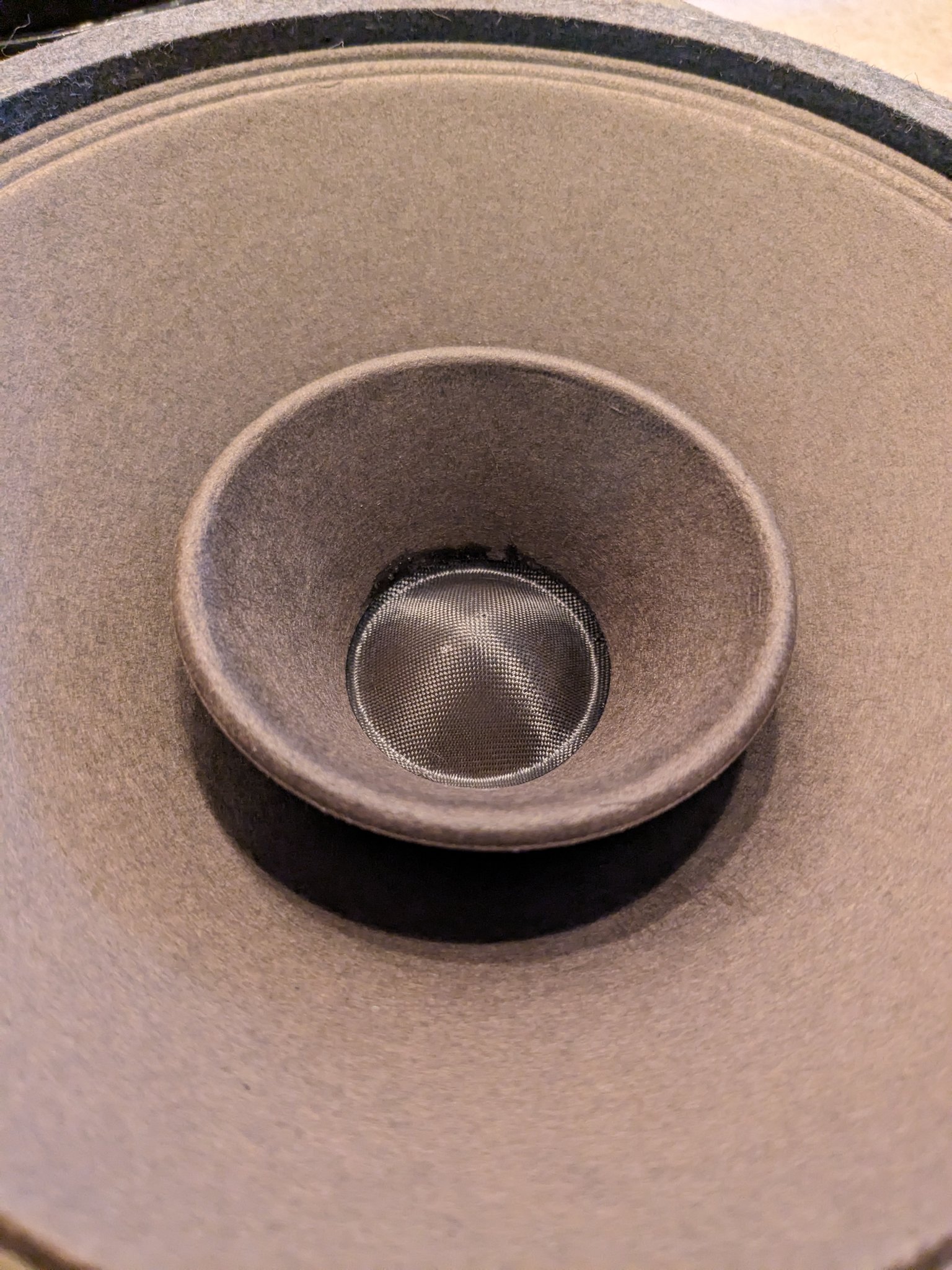

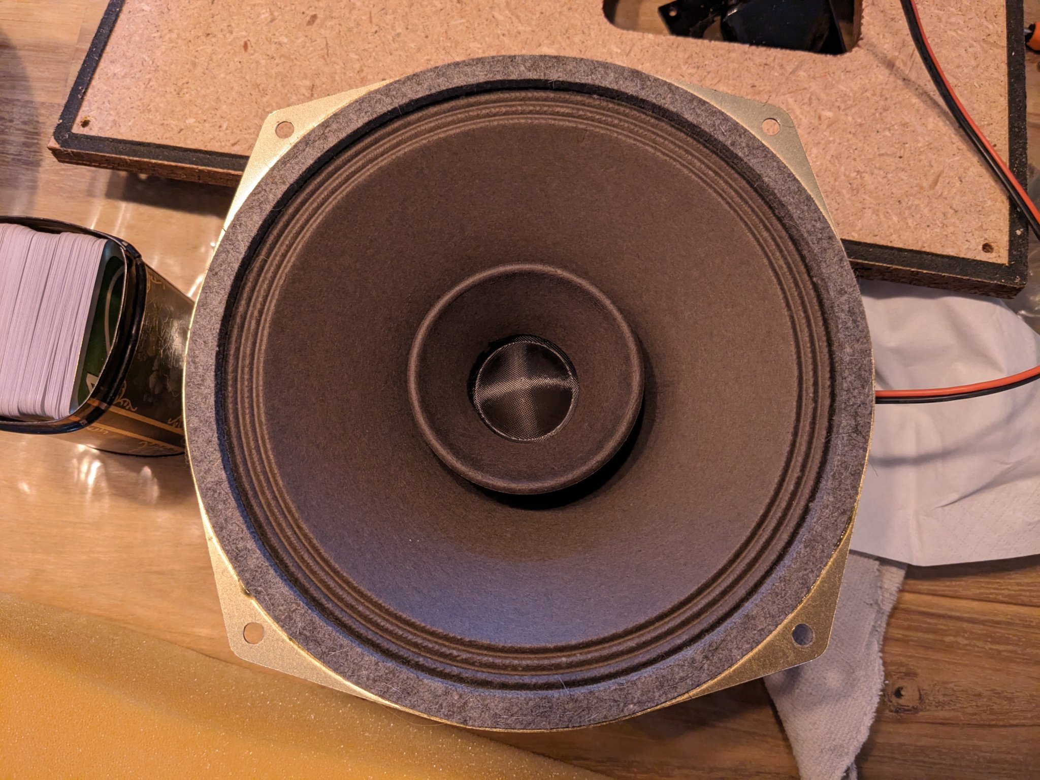

I opened one up to see what's inside and see if I could maybe fit another driver in there. The other driver didn't fit, but check out this vintage gem! I suspect its frequency response is a little too rough for my AV receiver's auto EQ (Audyssey) to handle. It sounds good, with hints of brilliance and also hints of.... hmmmm not brilliance but the feeling that it's correctable. Perhaps time to do some dedicated filtering on it.
Anyway, the BIB is in a certain location and it's clearly not the best place for it. My other bass BIBs where in another corner, which gave less seat to seat variance and a response that was overall less affected by room modes. It sounds really good at some places, but obviously nowhere near a listening position. I want to move it, but my wife remembers how adding a second subwoofer years ago improved sound tremendously, so she says I should just build another for the other corner. 🥰
I am very seriously considering that, but am uninspired to do any measurements while it's in its current location. I also think it sounds kind of tame compared to earlier experiences with this driver and back then I was using a much more capable amp. So there is some switching and of components to do before I decide if it is a big success.
Well, that very fine crossoverless sound while crossing at 200Hz, with a single bass cabinet, is a very big success. I love that.

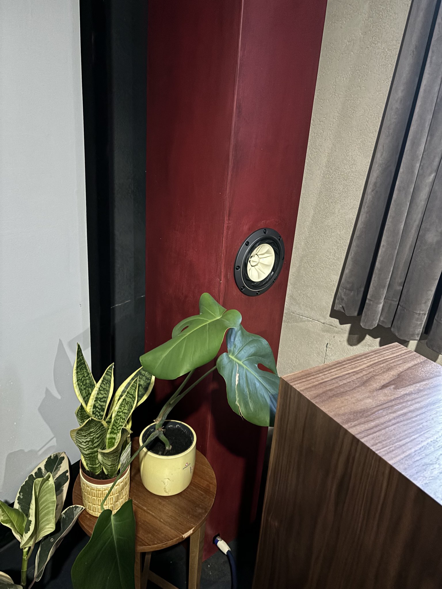

Hi everyone,
Just wanted to share my own experiences with BiB enclosures.
I'm on my third now, first with Audio Nirvana Super 8s, then on to Fostex 166en, and now Fostex fe168 sigma.
Each has been an upgrade on the last, with never having owned a good set of manufactured speakers, I began to wonder was I missing out on something, so I bought the Wharfedales. They have a solid reputation and I thought that they would be a good candidate to measure how the Bib compare.
When compared to the 166en cabinets, the Wharfedales were noticeably better in the mid range, but I found that they needed a bit of volume for the bass to come alive. I also noticed that the 3d/holographic sound from the BiBs disappeared completely, and that feeling of sound effortlessly filling the room.
Mostly due to DMason extoling the virtues of the fe168 sigma, I took the plunge and built another set of cabinets. Ive been listening for an hour or so, and I know these drivers take a while to break in but so far I am more than impressed. Vocals are several notches above the Wharfedales and the outgoing 166en cabinets. That huge soundstage is back and even at low volumes sound just fills the room.
Construction was from WBP plywood, the last cabinets I made were from marine ply but its doubled in price, and I wanted to double skin them so stuck with regular WBP. I just used the dimensions that the BiB calculator provided, rounded up to the nearest sensible number so as not to give myself a headache working it all out.
I got the wood cut at the DIY store (B&Q) then glued and screwed together and cut the hole for the drivers on a trim router. Then a few coats of Zinsser Shellac, and finally two coats of Annie Sloan chalk paint, then wax. With them being double skinned, they are heavy, about 70kg each.
The Wharfedales are going up for sale, I have a large smile on my face and I cant wait to hear how these speakers sound as the drivers break in.
I want to say thank you so much to everyone who has contributed to this thread for sharing your knowledge and experience on these cabinets/drivers 🙂

Thanks Ivo, they took a fair bit of prep to fill the screw holes/sand/paint, but I think it has been worth it.
Everyone comments on the size of BiB's but to me they look just right. The actual footprint is not much bigger than most floorstanders, and they can fill what would be an otherwise empty corner with an impressive looking loudspeaker.
Reactions: Vix, GM and Ivo
My thoughts exactly! Since they occupy the same amount of floorspace, why not go high?
My dream is to have a pair of BIBs with mahogany veneer + french polish.
But for that, I probably have to build a new pair of BIBs because the current ones are made of very thick MDF, so they weigh a ton. If I had to guess, easily 90kg/190lbs with ease.
