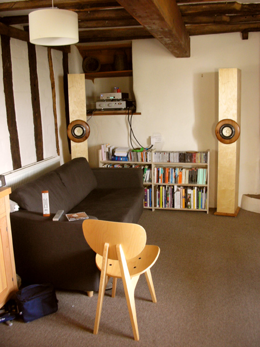

I used english bur elm for the baffles as I have quite a bit of it in my cottage already and I wanted the speakers to tone in and look like they belonged here.
Hmm, how does rounding over the edge of a chamfered mounting hole make it look like it 'belonged'? I mean we've been talking about the backside of a front mounted driver, so I assume you're referring to rounding over the baffle face for a rear mounted driver which for a wide BW one is a good plan acoustically since it will keep eigenmodes from forming and amplifying those already being generated across the driver and why foam rings inserted in the cavity created by the gasket is a nice, subtle tweak. Ditto to cover it when front mounted.
Regardless, sounds like a nice 'warm' room. 😉 Got any photos?
GM
GM
Misunderstanding of my comment. I meant that the choice of timber to match other timber in my room made the speakers look like the belonged there. I live in an old place (c1650) and the front supra baffle in elm was an aesthetic decision.
