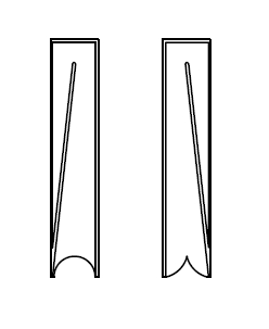

iBIB Exit Question
rough cuts made for an inverted BIB using the HiVi B3S (small living room). When you get the driver height up to a good level, there is about 3.5" of extension to the mouth. In considering how to deal with the exit, which of the two approaches here would be best?
The left is just a radius and the right is the same radius, but split a la Karlson (understanding that a Karlson is not a simple radius). I prefer the left aesthetically, but if the right is beneficial sonically, so be it.
Thoughts?
