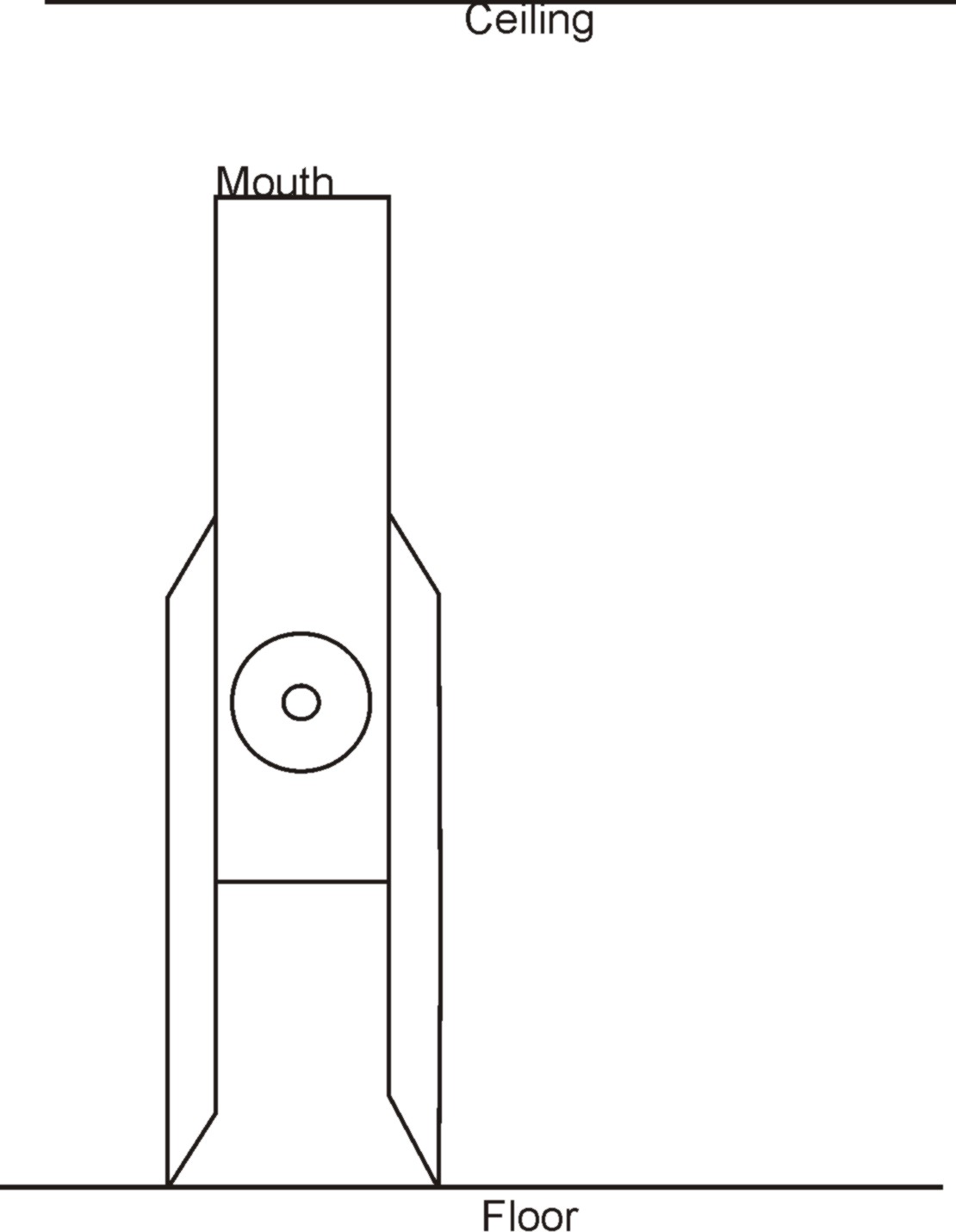

Missed that consideration! The simple radius shapes' area (both sides combined) is larger than the mouth's area. In the case of the right side, the area is slightly reduced. Does this add a mass loading effect?
In any case, opening up all sides with the split radius would beat the area.

Regarding the total length of the BIB, please have into account that you should consider the terminus to be not the floor but the highest point of any opening you decide to do...
ghpicard,
Yes. The top of the openings shown is at where a standard non-inverted BIB mouth would end. I am just trying to raise the driver height by extending the front and back baffles, then cutting out a portion of the sides...effectively making legs.

I've probably read the entire thread more than once, in total, but always in chunks over time, so maybe I missed the info. Is it workable to fold the line other than at the midpoint? For example, to raise the driver height in a short iBIB, could the fold be at .35 of line length? The internal baffle would become a sloping front (i.e., external) for the bottom of the cabinet.

Like any horn, you ideally want the flare to be preserved or at least not contracting, so you can fold it up into a pretzel if you want if these guidelines are followed. The problem with short horns though is one of getting adequate boundary loading, so if too short to load the ceiling, then it needs a rigid, well damped wall or floor (non-floating) to load against and maybe even a restrictive mouth plug or reverse cone section added to it to mass load it a bit.

Right, looking to floor load it and I recall your earlier comments about a pyramidal shaped plug inserted to taste. Time to experiemnt.

Firstly, and this is the big one, I was thinking of placing the driver at 0.416(smoother response) of line length, as proposed for floor firing BIB, BUT keeping them upright and lifting them off ground with legs(which will be about 10cm wide each and will extend up the cab, flush with baffle and past the driver to effectively widen the baffle- as wings or suprabaffles do)
This brings the driver to ear level, and brings the mouth closer to ceiling for better loading and bass reinforcement. I can't help thinking that this is a great idea! Am I crazy? Am I alone here?
Secondly, I was thinking of using deflex panels behind the drivers. They should do a great job of absorbing/dispersing the rear-firing waves and avoiding the reflected waves coming back out through the driver cone/surround. This in combination with the proposed stuffing.
