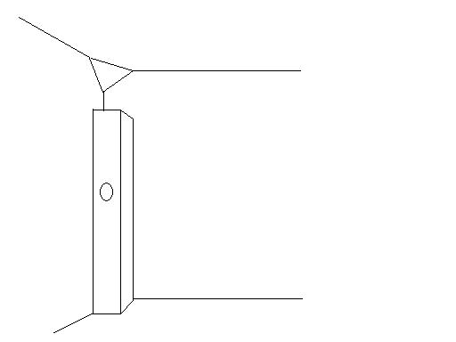

RE Ripple...
If ripple is caused by the roof reflecting back into the horn has anyone tried fitting a corner wedge to combat this ?
What effect would that have ? Just curious, if you've got a set of these then you probably don't suffer from WAF anyway.
I'm just finishing up a new pair.
