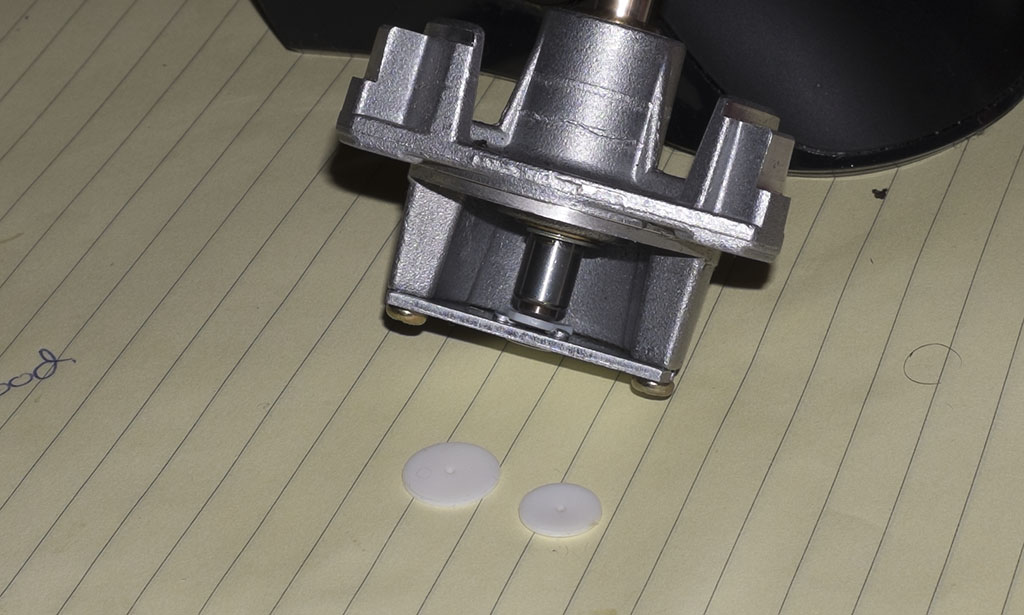

Yes that is true. My tape was also torn, so I replaced it with some Teflon discs I had from dissecting 10nF FT-1 russian teflon capacitors. These are around 10mm in diameter and less than half a mm thick. It still goes without issues. There is a minor squish in it by the axle, but it still runs smoothly. I have also seen some people using teflon balls, but I would not use anything thicker than half a millimeter. The ball is not going to run fully squished and it will introduce some bouncing to the axle
Here is a fast photo of what it looks like. You can see some curvature on the teflon disc, because I did not properly cut it to fit within the 3 metal posts and the axle is pushing it down in the middle.
attachment.php
I believe 3M is selling such discs, even with sticky tape on the downside.
