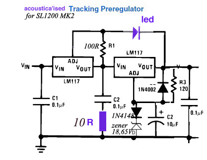

I also wanted to ask if you have tried the preregulator thingy on the article. It sounds VERY promising...

I ve been working a bit on the prereg schematic to apply all the goodness from the first page to it.
I came up with that
I have included the filter caps, the protection and thermal drift diodes and selected a few values for components]
Any comments?
I came up with that
Any comments?
BTW I do not see a reason why not to use LM350
It s ~3 times cheaper than LM117, has 5db better ripple rejection and can go up to 3A. And of course it is a direct replacement... no changes required on the other components...
