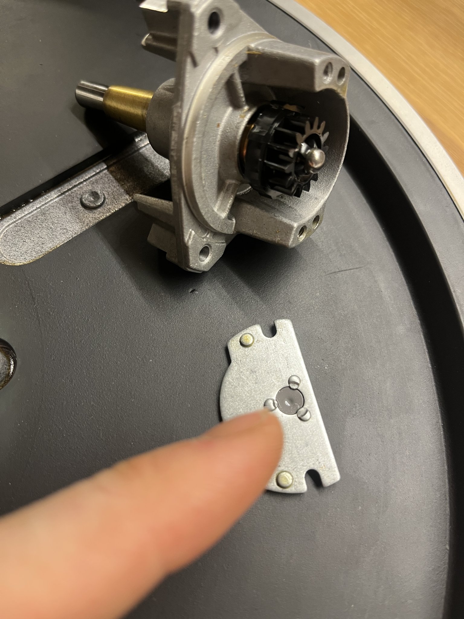

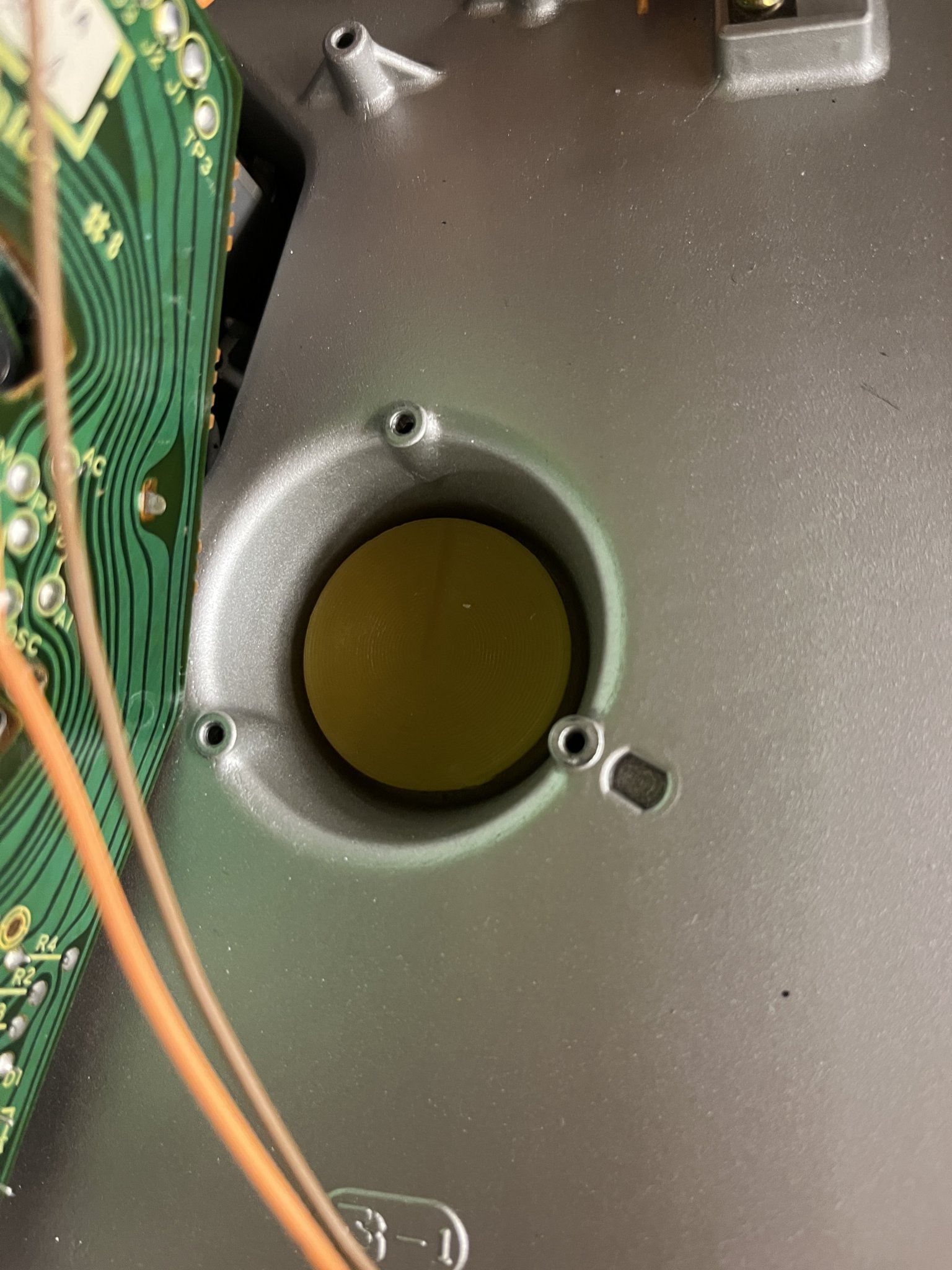

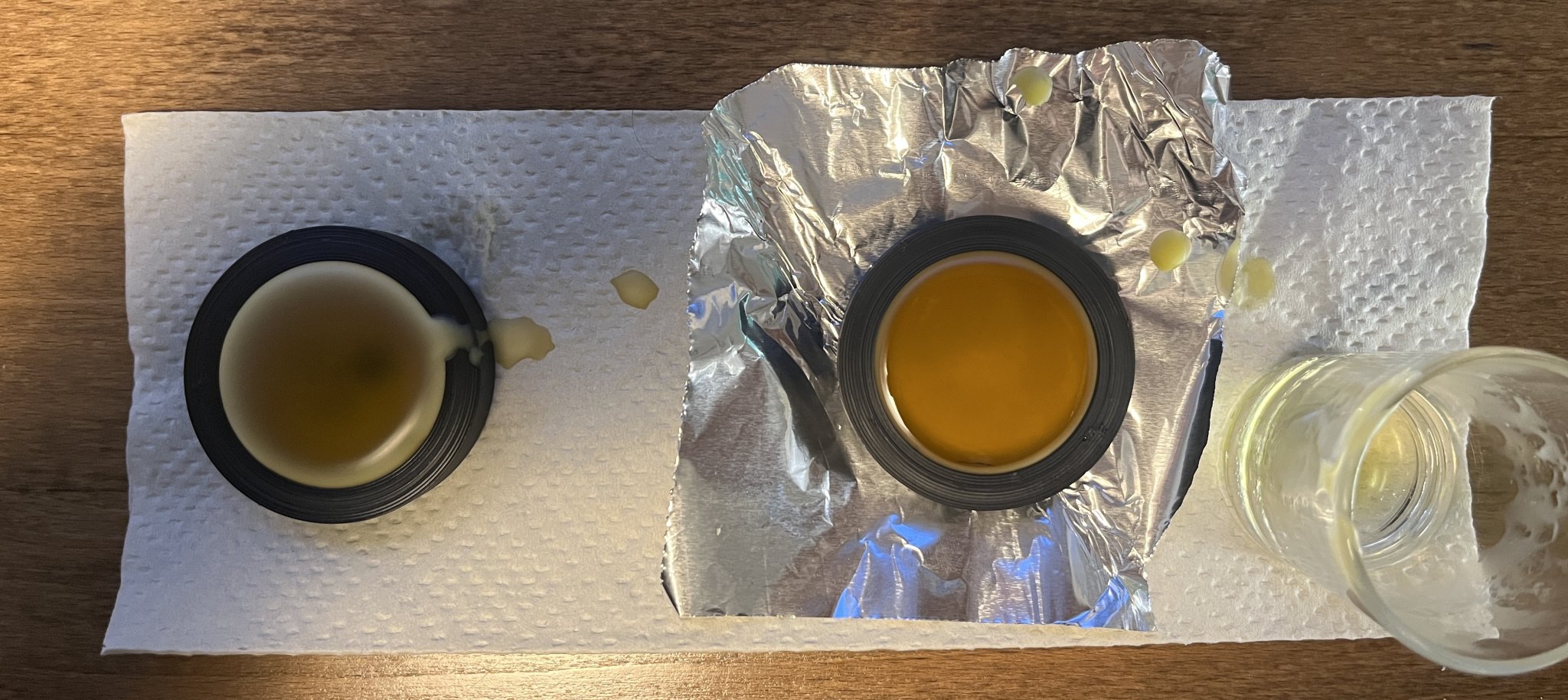

So I went and bought myself some beeswax and molded it to a disc measuring 38mm diameter and 5mm thickness. Totally forgot to weigh it but like 5-10grams. The bottom of the bearing pit measures like 39_ish mm and the space between the bottom of the thrust plate and the pit is like 2-3mm if my measurements aren't totally off. I'm rambling but anyway... The bearing thingamabob should squeeze into the wax nicely.
The one on the right was thicker but not needed after all.
Like KABusa website suggests, warming the wax with hairdryer when installing is a good idea as it softens the wax a little and makes it easier to install the bearing unit back.
Also since I was there I checked the thrust plate and
Yeah, called my buddy who's in the business of selling plastics and asked him to sell me POM-H (almost but not quite Delrin AF) so my take on the thrust plate mod is now on it's way, too.
What the wax mod did to sound I need to re-listen tomorrow. Brain power is too low, almost too low to think in foreign language at the moment. Tonight I'd say after a quick listen and direct A/B comparison with out the mod that the wax does more adhesion to the sound, everything plays together quite nicely.
