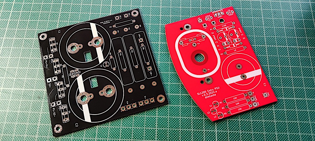

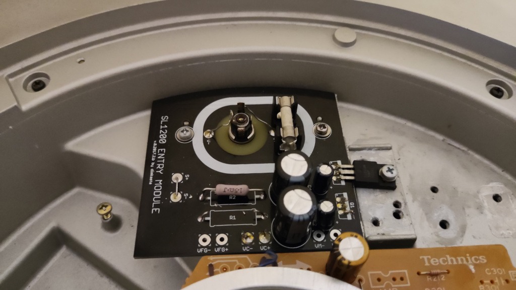

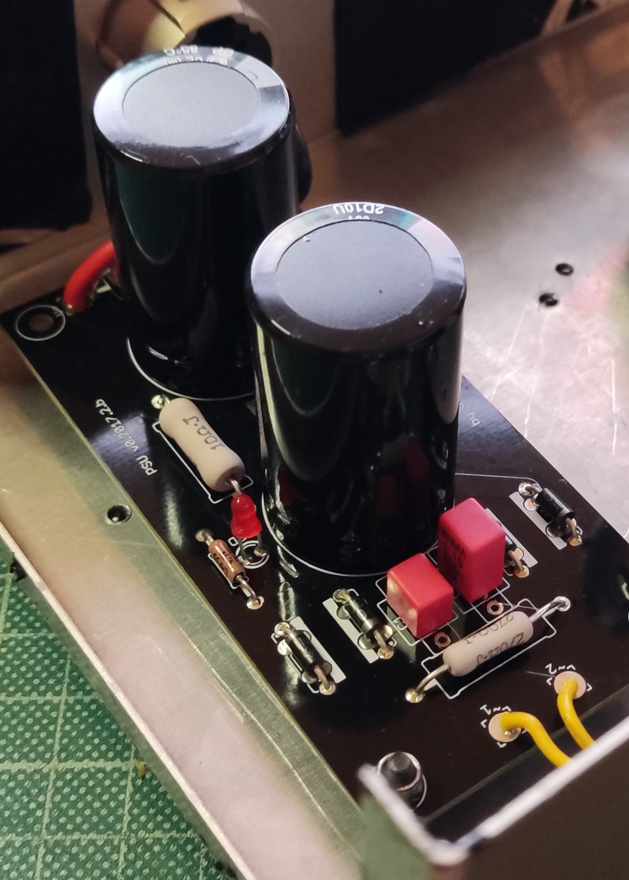

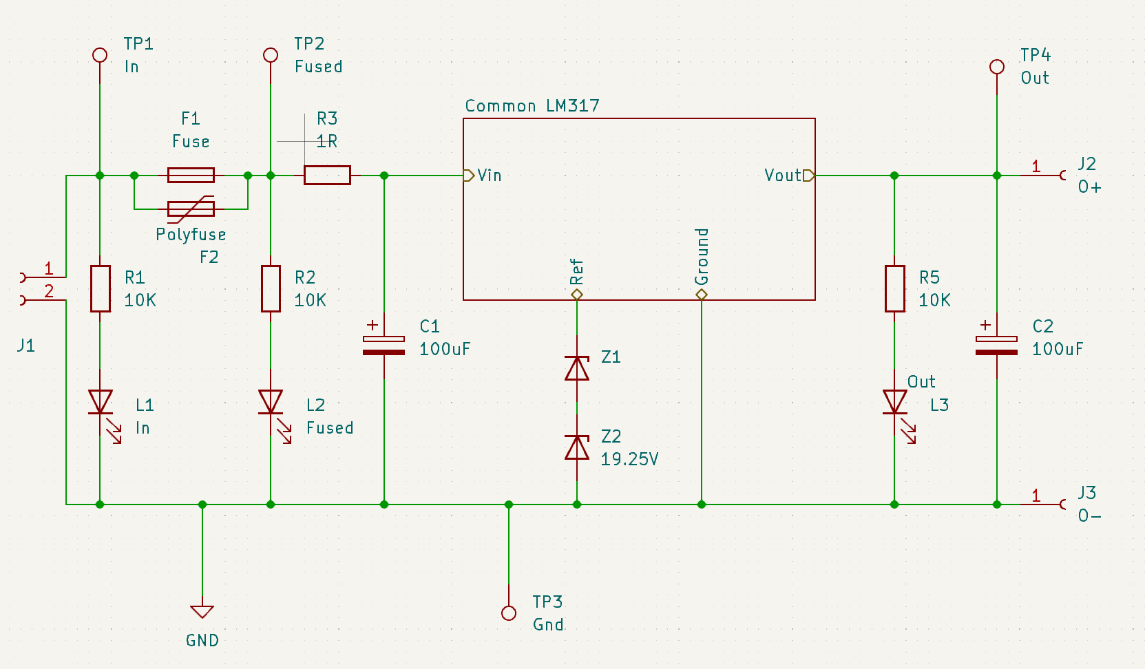

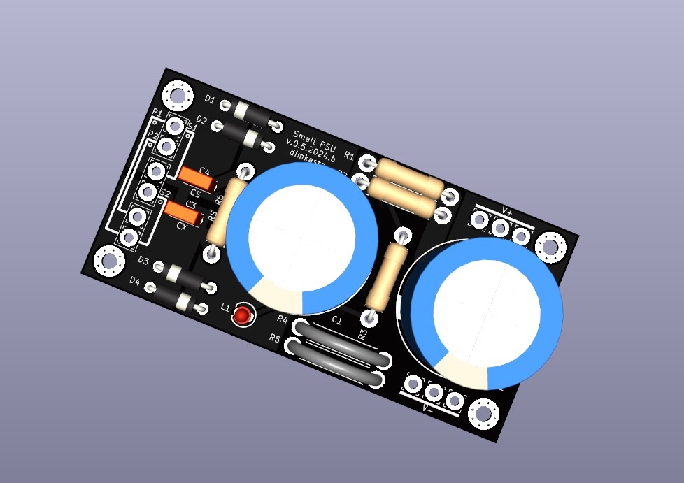

I recently started modifying a second SL1200. This is a nice project to practice my Kicad, since Autodesk killed Eagle, and update my old PCBs while at it.
The schematic allows the reuse of common LM317 parts, just in case I like to add extra separate regs in the future for the motors or the rest of the electronics.
I have added a few optional helper parts like fuse/pptc, test points and separate led indicators for each stage of the reg. I have also added two 100nF caps, one before the LM317 since it's highly recommended when the cap bank is away from the chip, and a second next to the zener reference to further reduce its noise.
I have also added an output cap. The sl1200 PCB has one so I might remove or change this as I experiment.
The pcb is my old design that fits on top of the bottom entry of the chassis, and has an 8mm hole to fit a barrel power socket. The pads are intentionally oversized, which makes them easier to solder and test, while allowing for any resistor types like carbon composition or whatever.
I will delay ordering the PCBs while I refresh my memory on what we discussed here and at the art of sound forum, but I am pretty happy with the layout so far
Eventually I plan on making these available to my github

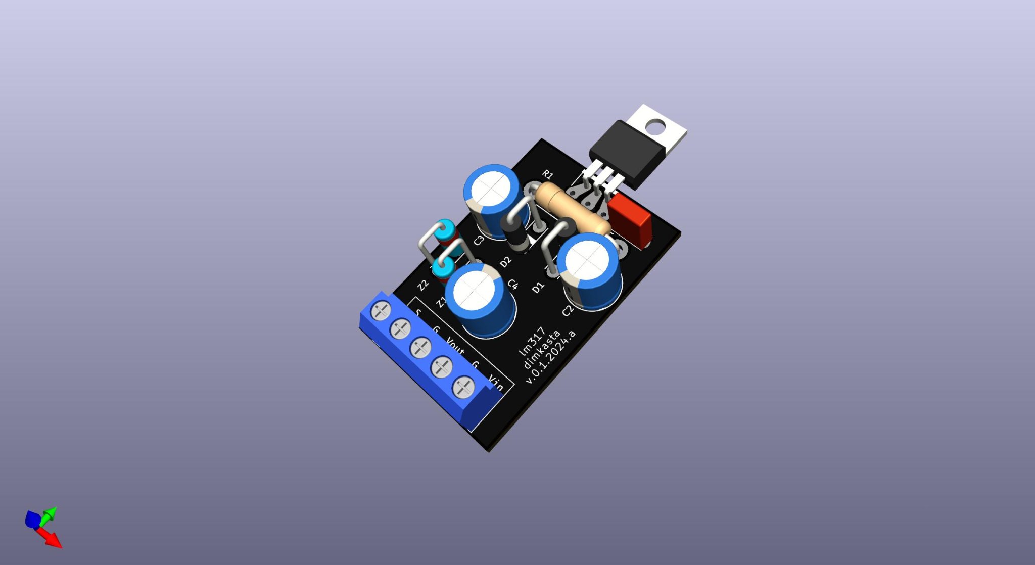

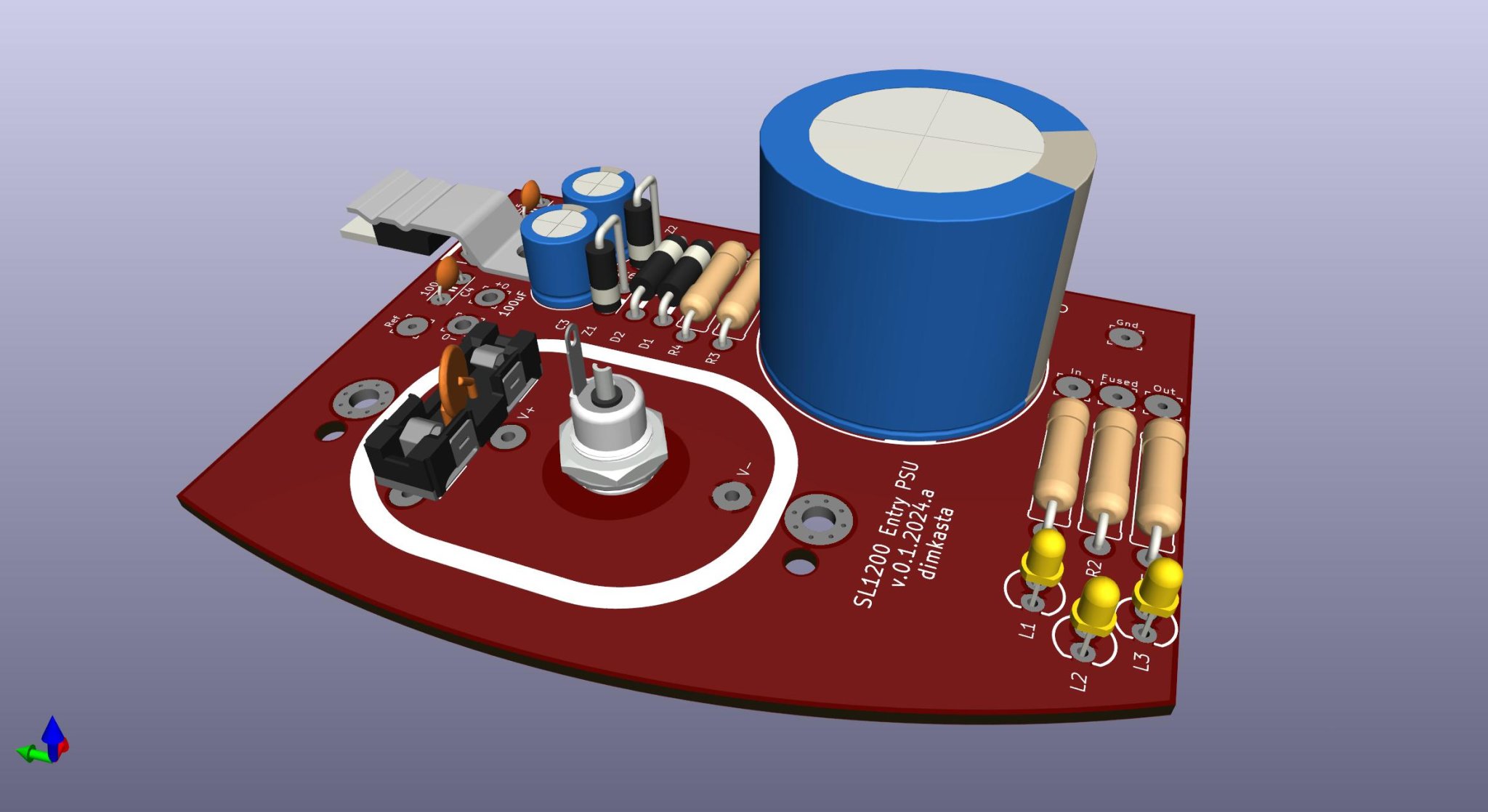

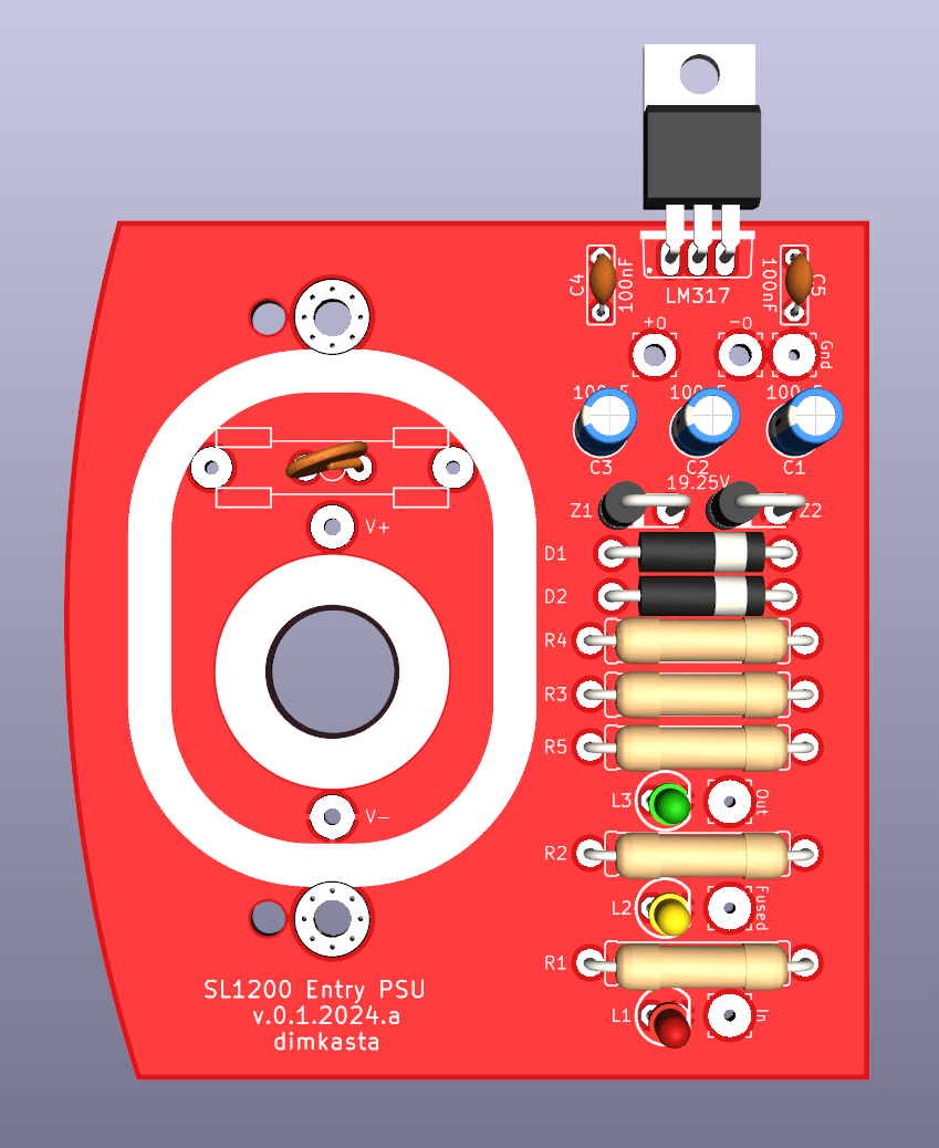

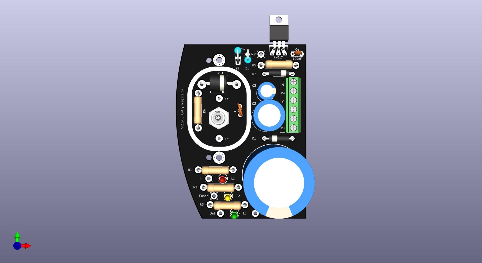

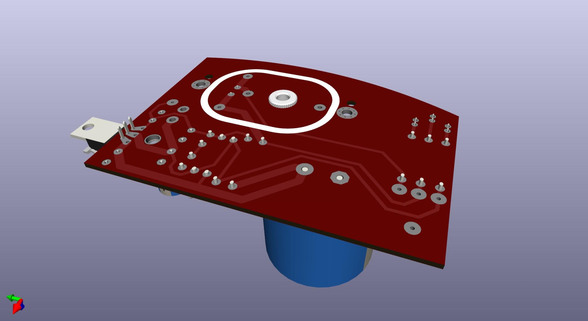

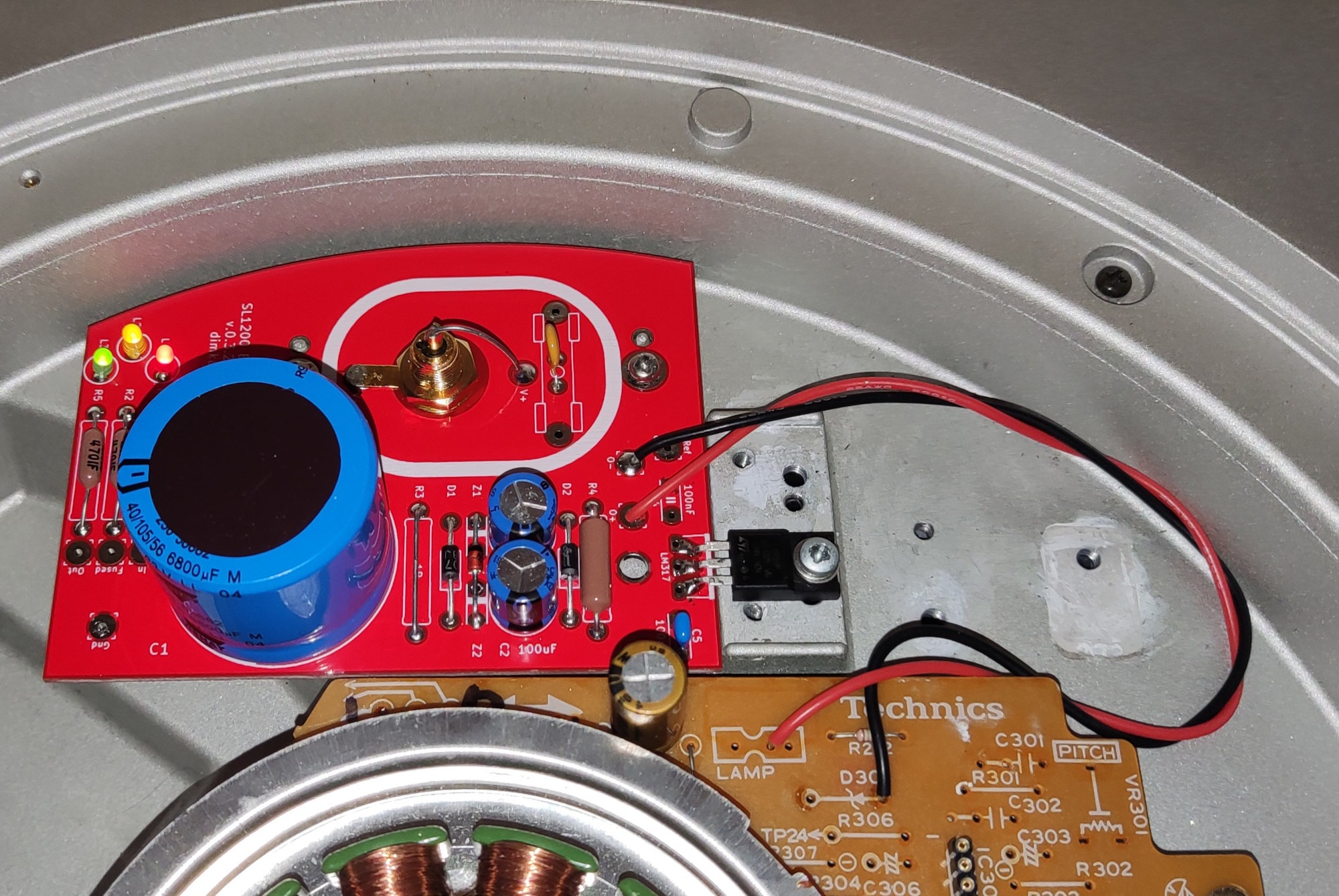

Rechecking my notes I did a few more changes.
I had an input cap in this board because I wanted to have the last RC stage close to the regulator, so that any effect from the cable's inductance is eliminated and that I have better transient response. The max diameter x height that probably fits under the platter is 35x30mm, which is enough to get us even 10mF@50V
I converted the small caps to 10mm so that I have more flexibility in sizes, and added a test point for the reference voltage.
I also added a spring clip for the TO220 reg. The pad on the chassis is thin and is getting pretty worn in my case from screwing/unscrewing. So I will just use this instead to push the reg to the metal. The PCB should be rigid enough.
Other than that, I added a few more 3d models to have a better overview of what the final board is going to look like. You can also see how the barrel jack looks like at the bottom, to have a better idea of what I am trying to do.
I am also thinking to add a MOV or a TVS to protect the rare chips from experimentation accidents
Any final notes before I send them to the fab?

just a few remarks to your layout:
The dynamic impedance and as such the noise should then still be lower than a voltage setting resistor/poti alone.
- the LM317 mounted horizontally at the PCb edge ..... the TO220 casing needs extra cooling in this application?
Is there a piece of sheet metal you could mount it to?
If not ... there is enough space on Your PCB to add a cooling fin and/or mount the LM317 vertical
(just noted that you changed the layout from #546 to #547)

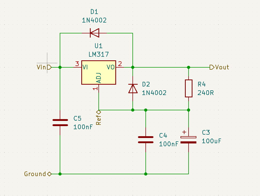

- I´d place D2/R4 closer to the LM317 pins ... they should be in closest proximity to the LM´s pins.
- You could omit with C4. A low ESR of C3 should be good for PSRR at 100/120Hz, but if C4 is mounted C3 should rather be a high ESR-type.
- You might replace Zener-Diode Z1 by a Diode like 1N4148 to counter the temperature coefficient of Z2.
jauu
Calvin
You are correct. Thanks for pointing this out. I will try to find my old notes and get back to youBut still assuming otherwise identical conditions, at Vout=10V, there is hardly any difference in PSRR between those two diagrams, both about -65dB.
True. I'll try to juggle the parts a bitI´d place D2/R4 closer to the LM317
Can you please elaborate? Will C4 demolish the low output impedance?You could omit with C4. A low ESR of C3 should be good for PSRR at 100/120Hz, but if C4 is mounted C3 should rather be a high ESR-type
In case You want to finetune Vout you could add a rather low-ohmic poti in series to Z2.
Yeah the temperature coefficient was mentioned in the acoustica articles. Plus with a second series part you can juggle them to trim the Vout to taste. Although to be honest the SL1200 is rather forgiving in its voltage requirements.
The pcb is designed so that the LM317 sits right on top of the old transistor's pad. I will post a photo of my current pcb later for claritythe TO220 casing needs extra cooling in this application?

To clarify how the PCB sits, here is my old one back from 2017. It started as a quick test to verify my measurements with a simple LM7820, but between work, losing interest and a few global crisis, it ended up spending almost a decade in my turntable.
"Will C4 demolish the low output impedance?"
Paralleled the parasitic inductance and the capacitance form a LCR tank where R, resp. the ESR of the cap defines the Q.
Low ESR gives high Q, due to less damping, high ESR or even adding external R results in low Q.
In unfortunate high-Q cases this can show as a strong peak in impedance response, an antenna, susceptible to HF-noise.
Since the LM317 is so slow a good lytic alone will suffice.
Regarding 'sensing', I'd keep the protection diodes D1/D2 with both pins close to the LM317's pins and R4's Adj-side pin also close to the reg's Adj pin.
It's sensing side pin may then be routed with a thin trace or wire to the remote point.

C4 is specified as 100nF though. Film or ceramic. Doesn't this mean that it lowers its ESR at a completely different frequency as the main electrolytic cap?Paralleled the parasitic inductance and the capacitance form a LCR tank where R, resp. the ESR of the cap defines the Q.
And also shunts any HF noise? (Including that of the zener)

What currently interests me a lot is the option to use a PPTC polyfuse
I was thinking that a Bourns MF-R025 would fit.
It has a resting resistance between 1 and 2 ohms, which means that if we use it we can pretty much eliminate the 1R@3W resistor as well.
It has a working current at 250mA and a trip current at 500mA.
And the max tripping speed is defined as 1.25A for 2.5 seconds or 1A for 4 seconds. Which sounds ok, but we do not know what the minimum is. And this could be a problem, first because when the TT breaks, the current spikes at around 550mA, and second because of the inrush current of C1 capacitor.
Perhaps I will have to experiment a bit to see how these things behave.

The test PSU boards have also arrived and I managed to steal some time from work. I am currently trying to source any missing parts and decide what the finalized boards will look like. I am thinking to remove the 5x20 fuse and just use a pptc in place of the second R in the CRCRC filter
Doing some further work on my existing PSU, the big 100x100mm filter board will definitely waste space. There is 0 need for large 50mm caps or multiple 5W power resistors.
So I am keeping the big boards for amplifiers, and reworking my old smaller 100x50mm board that fits just enough stuff.
Here is a photo of my old 2017 board.
And here is my current pcb, with a few minor improvements
Here we go. Finally after all those years I return to the LM317
Unfortunately it's late and I cannot do any critical listening to give an opinion about the lm7820 vs this LM317 setup.
I have used a BZX85820 zener @20V. The final output is 21.5V
I have also used a jumper for the second resistor on the CRCRC filter and used in its place a MF-R050 that is ~0.8Ohms while working. I have tested it with my desk PSU by shorting the output. The PPTC is triggered pretty fast when the current reaches 1A, which is what we want from our DC fuse.

First impressions are very positive. There seems to be a very distinct improvement in clarity of drums and cymbals, which also makes their timing more apparent.
The regulator is currently cooking for the entire day in Greek summer ambient temperatures of ~30 Celsius, without any sings of overheating, even if it has to drop all that voltage. The PPTC also seems to behave.
I also did some measurements using my bench PSU as the source, and verified them with my clamp. Keep in mind that I have removed the pitch control parts, which might explain why I see less idle and spinning current than what is reported by other people.
Idle consumption: 140mA
Spinning: 150mA
Breaking: 540mA
Cleaning disk with MoFi brush (the velvety kind): 450mA peak
The noise at idle is around 12mV
C4 does not seem to make any significant difference, so I will remove it since I do not really understand fully how it interacts with the datasheet proposed capacitor.

I have ordered a new version of the regulator. I just removed the unused parts, added a TVS to protect the circuitry while experimenting, added a bleeder resistor to add some permanent load to the regulator, and added a screw terminal to help with easier work on the boards
I have also created a small standalone regulator board. This will be used in two places.
The first is in the external PSU case to drop 10V or something like that from the 40V. It's easier to use proper heatsinks there. And we don't get so much dissipation and heat in the turntable itself.
And the second place is as a sub-regulator for each sub-circuit of the main turntable PCB. This will probably be part of a separate thread and project.
