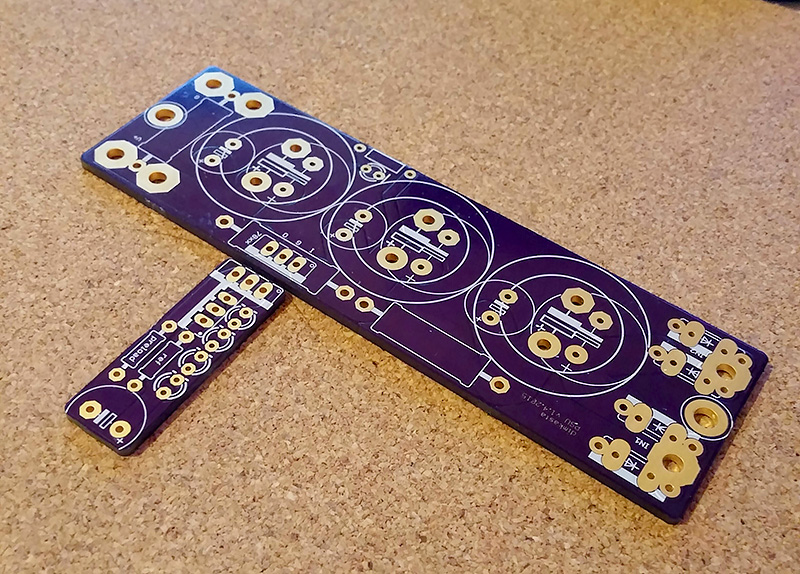

I am starting to plan/build my outboard power supply for the SL-1200. It will likely be a CRCRC for CLCRC in an outboard box with this tracking pre-regulator inside the turntable chassis:
My question is, which size cap (if any) should come before and after this regulator?
Thanks!
Thanks!
